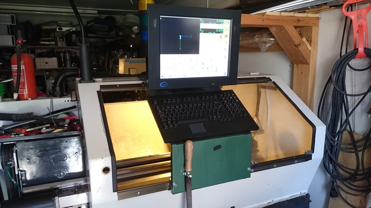

12 May 2017 09:26 #93089
by tecno
Replied by tecno on topic DigiPos 15" touch screen, how to get this up and running in LCNC
- Posts: 12178
- Thank you received: 4156
12 May 2017 16:51 #93115
Replied by rodw on topic DigiPos 15" touch screen, how to get this up and running in LCNC
Looking good. I bought home an Acer 232HL 23" screen last night and it is massive in comparison. Really too big for a machine and far too nice to put in a workshop but it just came up perfectly under Linux Mint and did not even need calibration.

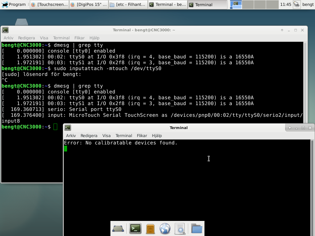

So I am back trying to get this touch screen to work with my RT-Preempt installation
As you can see there is no touch at boot, below what is in /etc/rc.local
/usr/bin/inputattach --daemon --always -mtouch /dev/ttyS0
exit 0
Issuing sudo inputattach -mtouch /dev/ttyS0 and touch screen reacts so calibration is needed.
then dmesg | grep tty will show that touch is on ttyS0
But Error: No calibratable devices found.
Can I get some advice to get this working, did work in earlier non RT-Preempt installation.
exit 0
- Mike_Eitel
- Posts: 1051
- Thank you received: 183
02 Jan 2018 11:50 #103953
by Mike_Eitel
Replied by Mike_Eitel on topic DigiPos 15" touch screen, how to get this up and running in LCNC
Yes, i remember to spend some hours on that too.
Have a search here in the forum for touchscreen and stretch.
If i recall correct i installed and used xinput-calibrator but had to fidele with the correct values by hand.
And the activity was not succesfull as root.
Sorry, my system is not up in this moment.
Good luck
Mike

02 Jan 2018 12:07 #103955
by tecno
Hi Mike,
Thanks for your input, but the problem is that xinput-calibrator can not find any touch to calibrate.
sudo inputattach -mtouch /dev/ttyS0 shows that the touch is there, can of worms it is with touch
- Mike_Eitel
- Posts: 1051
02 Jan 2018 12:28 #103956
by Mike_Eitel
The basis problem in my eyes is the changed "input style" via libinput.
Have a read, i had to go back to the old style.
forum.linuxcnc.org/18-computer/33224-str...nd-touchscreen#98389

26 Feb 2018 11:10 - 26 Feb 2018 12:09 #106540
by tecno
So guys now I am back again trying to get this DigiPos touch screen to work with RT-Preempt.
All above in this subject was before Mesa 7i96e.
How can I check what is connected to tty? I know that it worked OK with Win2K way back.
screen, serial = commands not found
dmesg shows only serial ports nothing connected
Last edit: 26 Feb 2018 12:09 by tecno. Reason: new content
