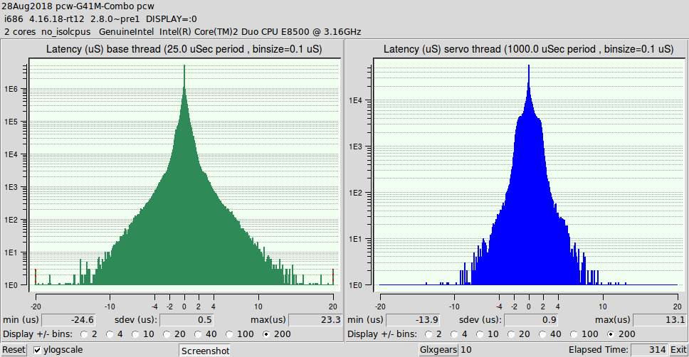

28 Aug 2018 10:36 #116714
Replied by PCW on topic Preemptive RT on Jessie or Stretch?
What hardware do you have? recent Preempt-RT kernels can have very good latency figures on the right hardware:
freeby.mesanet.com/8300-4.18.png

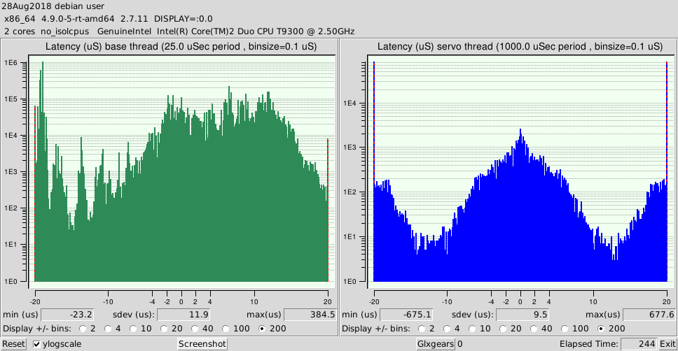

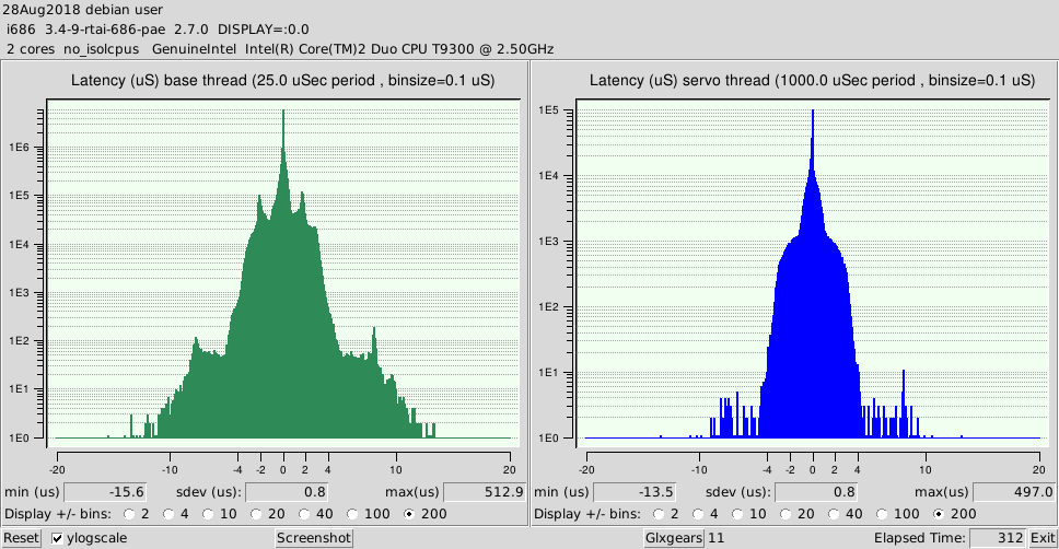

- twoflowers
- Visitor
28 Aug 2018 10:50 #116717
by twoflowers
Replied by twoflowers on topic Preemptive RT on Jessie or Stretch?
I ran this on T60/T61 C2D, one with ATI and the other with Intel GPU. Latency on RTAI is ~ 5.000ns, on RTPREEMT ~ 70.000ns. I get the same figures on my old Desktop (gigabyte+xenon). What is more troubling on the Intel boards: I cannot turn off SMI any more. This gives additional 450.000ns peaks every now and then. I would not see this as a problem if that very same hardware would not have worked before.

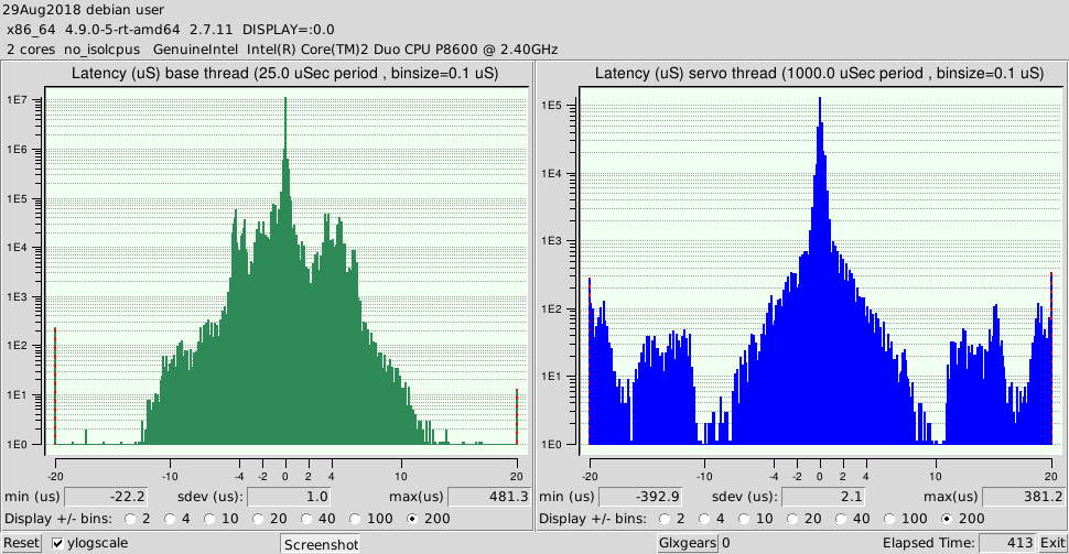

- twoflowers
- Visitor
28 Aug 2018 17:28 - 28 Aug 2018 17:29 #116745
by twoflowers
Last edit: 28 Aug 2018 17:29 by twoflowers.
- Posts: 18122
- Thank you received: 5337
28 Aug 2018 18:42 - 28 Aug 2018 18:44 #116750
Well its not so good on RTAI either (512 usec)
That does look pretty terrible though possibly your CPU cannot run a 40 KHz thread with Preempt-RT so everything is broken
(trying with servo thread only would show if this were the case)
Last edit: 28 Aug 2018 18:44 by PCW. Reason: Minimum time doesnt mean that due to the way its calculated
- twoflowers
- Visitor
29 Aug 2018 01:52 - 29 Aug 2018 02:04 #116763
by twoflowers
Last edit: 29 Aug 2018 02:04 by twoflowers.
