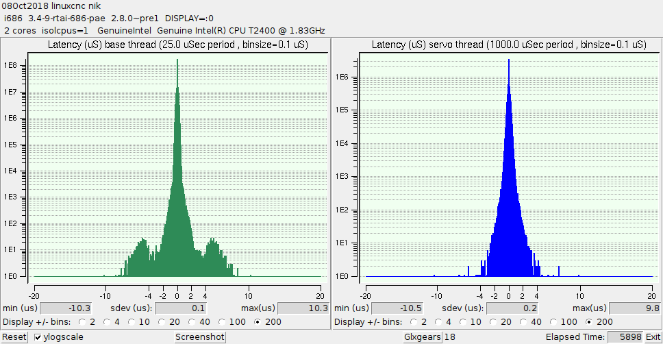

18 Sep 2018 08:59 #117717 by twoflowers
Replied by twoflowers on topic Preemptive RT on Jessie or Stretch?
Well, this is not the point: LinuxCNC 2.8 simulation and kernel 4.xxx work perfectly on these older systems. RTAI Kernel work quite ok. What does not work is the PREMPT-RT kernels. I just got bitten by the same effect on machinekit+BBB: xenomai kernel works like a charm, preempt-rt does not (0.5s latency .. that's something to be beaten).

08 Oct 2018 05:03 - 08 Oct 2018 05:07 #118533 by twoflowers
In the meantime I made a bit of a progress: This latency-histogram from the latest linuxcnc build from git on devuan ascii. It's running on a T60 (ATI) with coreboot, NMI and SMI disabled, vesa graphic driver, modem + wlan removed. The only thing I'm not happy with is the old kernel from wheezy :S
