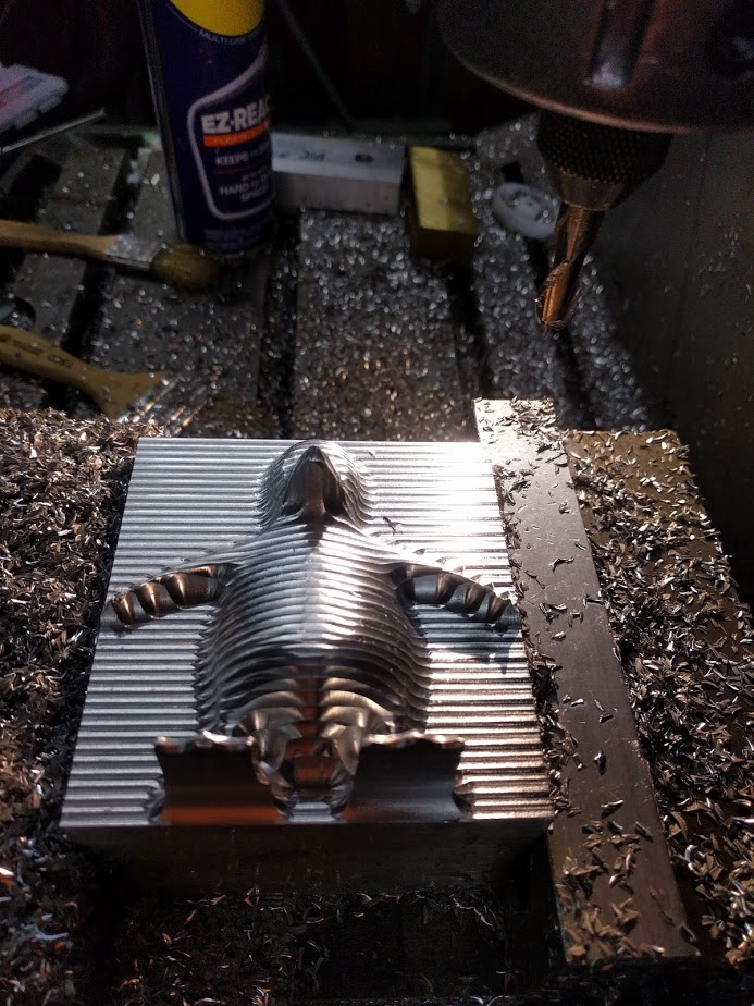

The good news is that the mill itself seems to be working great. I ran the sample program. It's a tad off since it was cam'd for a 10mm cutter and I only had a 3/8" available, but close enough!
