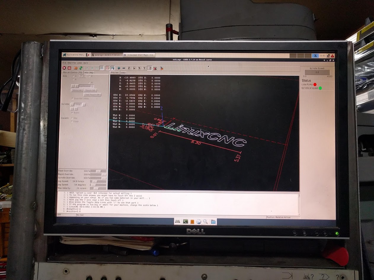

Well, after trying for way too long to get it to work, I gave up and found a spare 22" monitor that I had sitting on a shelf that almost fit. Took a little hacking and booty fabrication, but I got it in there. Kind of bugs me because the PO custom built the console around the monitor and this one just doesn't quite fit as well, but it'll get the job done for now.
I really don't understand why this 10 year-old Dell monitor works fine but the newer Viewsonic would not.
