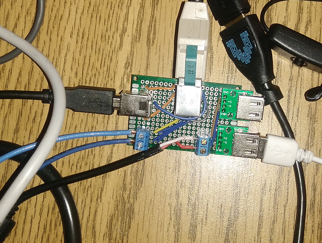

Good to know about the input protection. I just got finished getting my fpga board to communicate with linuxcnc.

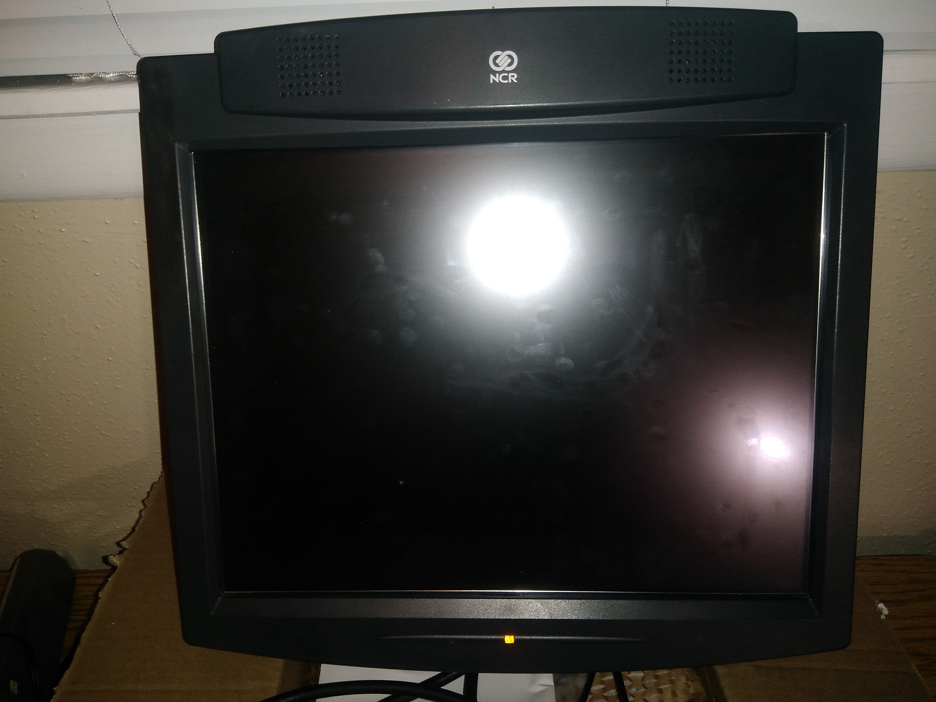

As far as my touchscreen goes, I'm using a NCR RealPos ( rather unfortunate name) monitor. It cost me $25 on ebay plus about $5 for the parts on the adapter board for breaking out usb on the monitor and power for the monitor, RPi and fpga
