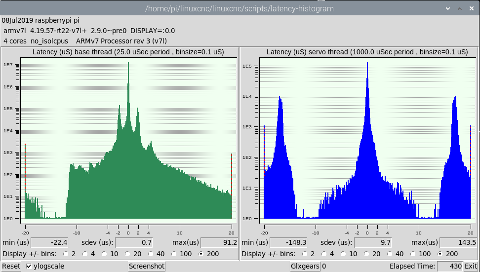

- Hakan

Well, the route with "rpi-4.19.y-rt" didn't work. What works is to start with the "rpi-4.19.y" branch and apply the usual rt patches.
I now got this
and a latency_histogram that looks like this, after some random surfing on the net.
I will have to wait until tomorrow with actual test. I am pretty sure it will run (somewhat).
And to newbynobi, you have a line "import vte" in gmoccapy line 39, is that actually used? "buster" doesn't have a suitable package python-vte.
I now got this
Linux raspberrypi 4.19.57-rt22-v7l+ #5 SMP PREEMPT RT Mon Jul 8 17:42:16 CEST 2019 armv7l GNU/Linuxand a latency_histogram that looks like this, after some random surfing on the net.
- Posts: 18116
- Thank you received: 5335
08 Jul 2019 16:39 #138875
Replied by PCW on topic Raspberry Pi 4
A servo thread only plot would be interesting
