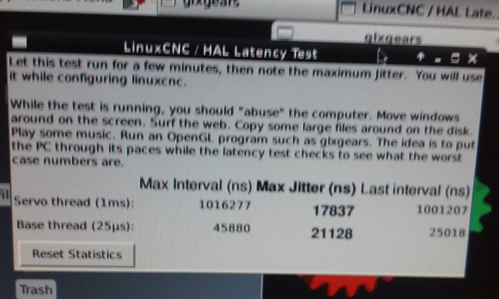

... I also installed an ssd as well. After some research I found out the cpu is an AMD Athlon II X2 250 . I did some stress testing simultaneously running 3 glxgears programs a video and randomly transferring files from a usb to the SSD and back again and got a max Jitter Base thread of 20939 and Servo thread of 18469....

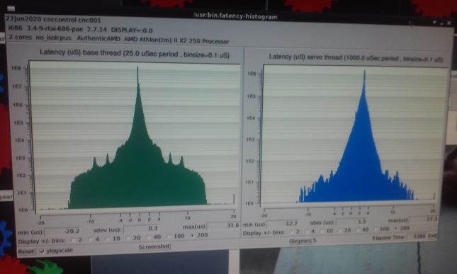

seuchato I tried running the script on my computer ( Linuxcnc Debian wheezy 2.7.14) and coudn't get it to run. Deffinetly got to be my lack of expertise. So I think I did the next best thing I ran 5 of the glxgears programs, ran the histogram, occasionaly moving and resizing files and ran a playlist from my YouTube channel . I am not going to post it in the other section because I haven't gotten it to work for me yet.
here are the histogram results base 31.6 servo 27.3

30 Jun 2020 07:18 #173177
Replied by tommylight on topic Will either of these work?
That will do just fine.
