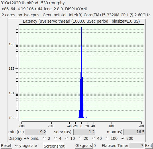

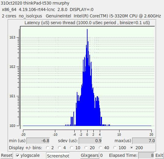

Just out of interest why is the --nobase & --base options being used ?
Can anyone explain the binsize parameter.
It does seem to affect latency, but which size 0.1us or 1.0us gives a result that matches real world use ?
For instance, althouhg short test there was a difference seen:
Binsize as per script:
Binsize as a default when running just with the base switch:
Last edit: 31 Oct 2020 00:53 by BeagleBrainz.

31 Oct 2020 06:52 #187861 by seuchato
@BeagleBrainz
"latency-histogram --nobase --base 25000 --sbinsize 1000 --nox"
This is a bug in the script. I'll change that. Thanks for getting this pointed out.
Greez
chris
31 Oct 2020 06:58 #187862 by seuchato
The two tests do show very similar data (given the test ran only for 7/8 secs), but the x-scale of the plot differ by a factor of 10. And that's exactly controlled by binsize: resolution of the diagram in x-axis.
hth
chris
