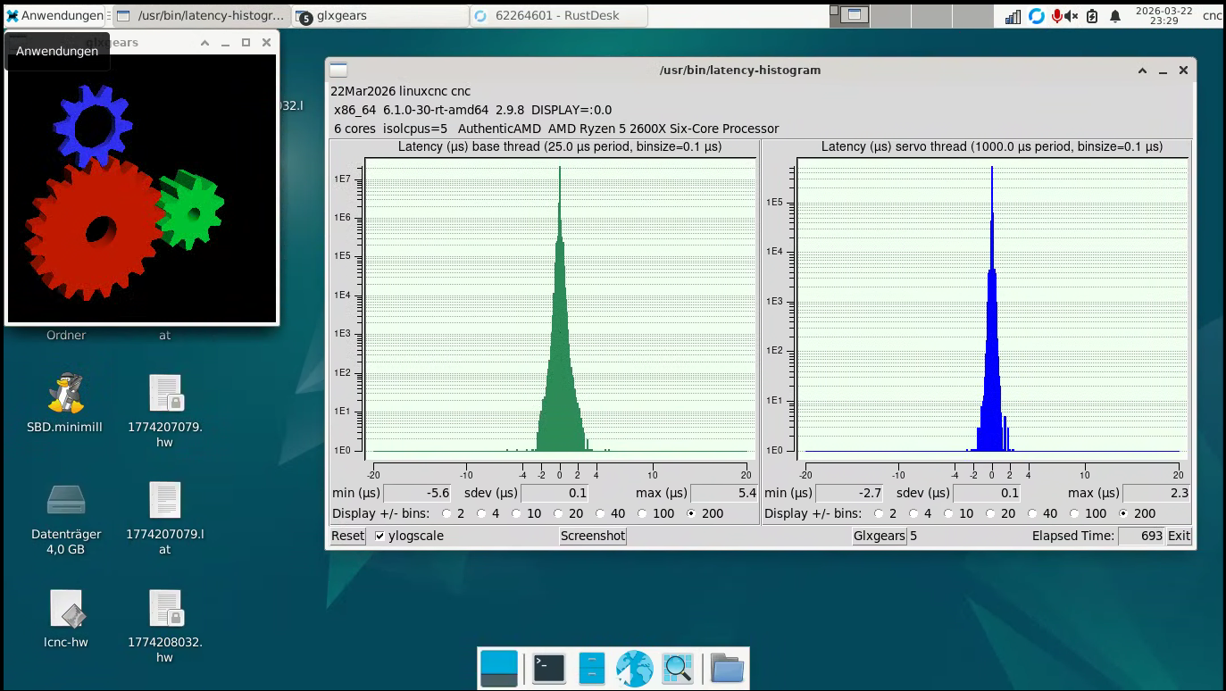

22 Mar 2026 21:45 - 22 Mar 2026 21:47 #344617 by miniwini
this is my actual running system... i´m quite impressed... :D
LinuxCNC pc tests, version 20200930, started 22.03.2026 20:33:53
General info:
ASRock,  To Be Filled By O.E.M.
Bios version P3.40, dated 07/17/2019
Chipset: Advanced Micro Devices, Inc. [AMD] 400 Series
Harddisk is rotational
The amount of swap currently used is 0
CPU related data:
model name : AMD Ryzen 5 2600X Six-Core Processor
cpu cores : 6
stepping : 2
cache size : 512 KB
RAM related data:
Maximum Capacity: 128 GB
Maximum Voltage: 1.2 V
Non-Volatile Size: None
Volatile Size: None
Cache Size: None
Logical Size: None
Size: No Module Installed
GPU related data:
product: GK104GL [Quadro K5000]
configuration: depth=32 driver=nouveau latency=0 resolution=1366,768
Parallel port related data:
number of parallel ports is 0
Os and desktop related data:
PRETTY_NAME="Debian GNU/Linux 12 (bookworm)"
Should the info below not match with your machine,
kindly post the output of pstree here, including a brief
desciption of your desktop environment, window manager and
display manager. Tia
https://forum.linuxcnc.org/18-computer/39370-script-for-automated-testing-of-computer-latency
Desktop environment : lightdm
Windowmanager       : Xfwm4
Displaymanager      : lightdm
Kernel related data:
Kernel 6.1.0-30-rt-amd64
GRUB_CMDLINE_LINUX_DEFAULT="quiet splash isolcpus=5 idle=poll"
Cpu idle driver: none
Kernel modules data:
Check if pcspkr is loaded: [0;31mYes, may cause bigger latency.[0m
  can be eliminated using:
  sudo echo "install pcspkr /bin/true" >/etc/modprobe.d/pcspkr.conf
Check if snd modules are loaded: [0;32mNo, which is good![0m

 7189 s  servo min:  -4.900 us max:   5.400 us sdev:   0.300 us
 7190 s  servo min:  -4.900 us max:   5.400 us sdev:   0.300 us
 7191 s  servo min:  -4.900 us max:   5.400 us sdev:   0.300 us
 7192 s  servo min:  -4.900 us max:   5.400 us sdev:   0.300 us
 7193 s  servo min:  -4.900 us max:   5.400 us sdev:   0.300 us
 7194 s  servo min:  -4.900 us max:   5.400 us sdev:   0.300 us
 7195 s  servo min:  -4.900 us max:   5.400 us sdev:   0.300 us
 7196 s  servo min:  -4.900 us max:   5.400 us sdev:   0.300 us
 7197 s  servo min:  -4.900 us max:   5.400 us sdev:   0.300 us
 7198 s  servo min:  -4.900 us max:   5.400 us sdev:   0.300 us
 7199 s  servo min:  -4.900 us max:   5.400 us sdev:   0.300 us
 7200 s  servo min:  -4.900 us max:   5.400 us sdev:   0.300 us
 7201 s  servo min:  -4.900 us max:   5.400 us sdev:   0.300 us
 7202 s  servo min:  -4.900 us max:   5.400 us sdev:   0.300 us
 7203 s  servo min:  -4.900 us max:   5.400 us sdev:   0.300 us
What do you think?
cheers miniwini

22 Mar 2026 23:35 #344619 by tommylight
Looks perfectly fine, thank you.
