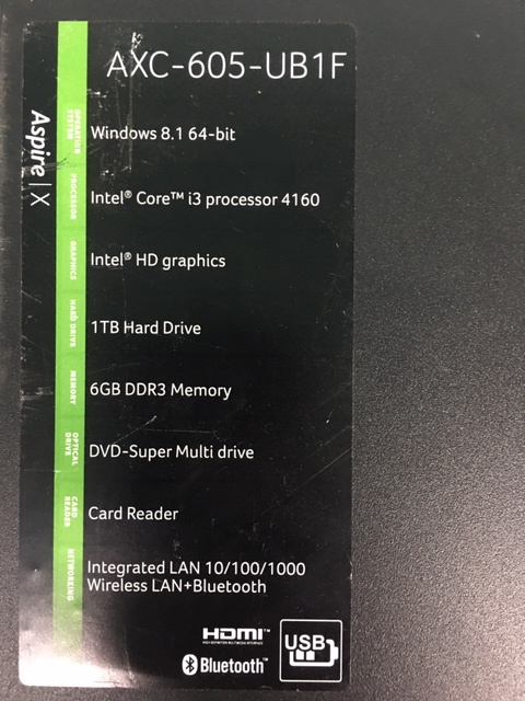

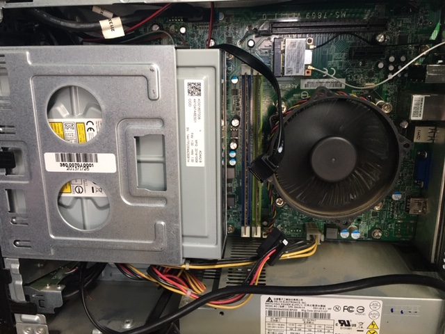

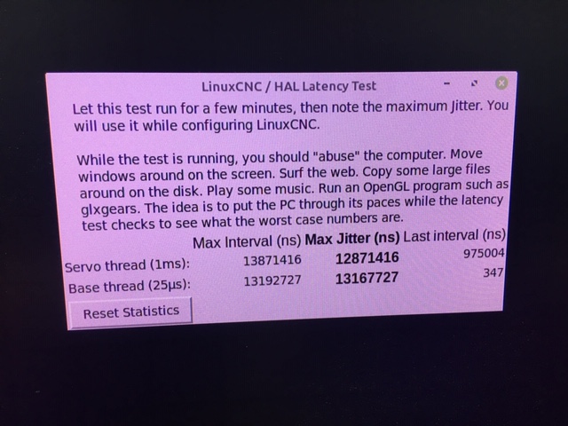

I am not computer savy... I have an Acer Aspire X AXC-605-UB1F I thought would make for a good computer with a small package and potentially more modern and better performance then my other spare desktops. After initial install of Mint 19.3 Mate and LinuxCNC using the forum post I ran a latency and it was 12MS. I have some other video cards but the current Intel HD Graphics card is internal to the mother board? That leads me to the computer only having a PCIe and PCIe 16x(I thought was PCI) ports available, not giving me many options for mesa cards. Should I look for another computer? I have been using an HP EliteBook 8470p Laptop running debian and 2.7 I installed in 2018 and dock with parallel port but running external monitor and keyboard bumped the latency up above 50k.

What does
uname - a
in a terminal say?
Did you disable everything regarding hyperthreading, speed step, power saving, C states, etc in BIOS?

Linux riversvic-Aspire-XC-605 5.4.0-0.bpo.4-rt-amd64 #1 SMP PREEMPT_RT Debian 5.4.19-1~bpo10+1 (2020-03-09) x86_64 x86_64 x86_64 GNU/Linux

Reboot, hold down ctrl+shift till you get the Grub menu, choose advanced .... , chose the line that contains the above kernel,
Test latency again, it should be better.
But, disable the BIOS stuff, no amount of kernel magic will help if you have hyperthreading and speed step active.

I was able to get into the Grub Menu by changing some boot options and hitting esc on reboot. latency is down but still in the 9m. I dont think there is anything else to disable in the BIOS

Kindly post the result of:
see the line with "GRUB_CMDLINE_LINUX_DEFAULT". You could try setting some or all of the following options:
GRUB_CMDLINE_LINUX_DEFAULT="quiet splash intel_idle.max_cstate=0 processor.max_cstate=1 idle=poll isolcpus=x";
for "x" see wiki.altervista.org/cs/kernel_boot_parameters
If you use my script here and post the results, more details about the pc will be available.
