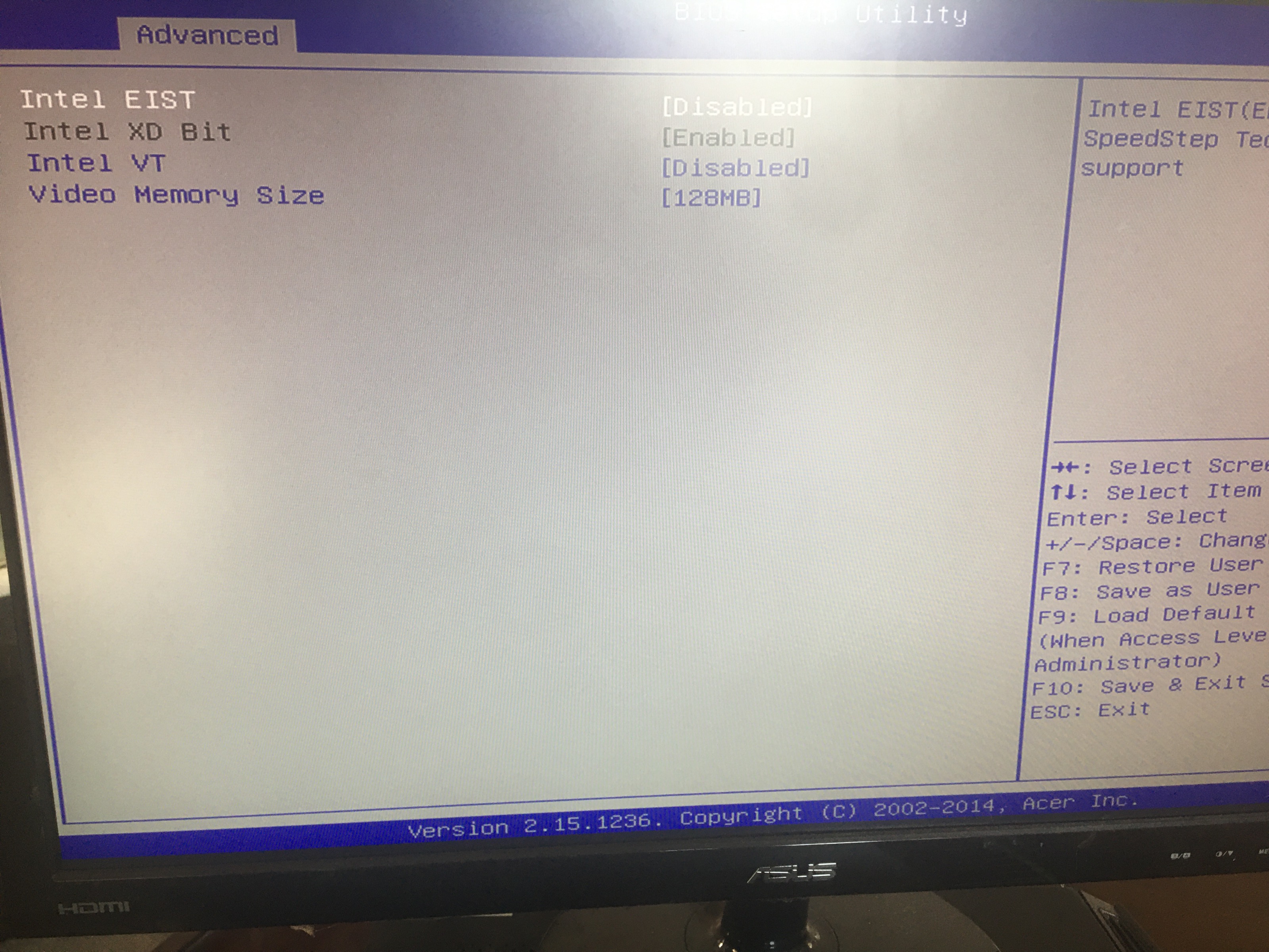

- Posts: 22049
- Thank you received: 7509
23 Jul 2020 09:38 #175549
I think i wrote about this, but here it is again:
Lately i have noticed that when using LinuxCNC and latency test the CPU speed will vary on some PC's despite everything disabled in BIOS, but that will not happen while running latency histogram, the frequency will not change while the GUI version of latency histogram is running. That seems strange and that is the reason that lately when replying to latency figures posted by other members i always use the "should work" expression as i am aware that latency histogram numbers might be very good, but using LinuxCNC might still allow for latency excursions.
Replied by tommylight on topic Massive Latency, and no PCI port Acer
I would not bother with it as new CPU's and mobo's do not care what the operating systems sets them to, they just do what they are programmed to.I'll study a possibility to determine if cpu freq scaling is active from my script.
Linux does have cpu governor included, but on most PC's i use even setting the governor to "performance" does not keep the CPU from lowering the frequency as it should.I am also thinking of probably using "cpuspeed" to set the min and max speed at the same below max speed value for thermal reasons. Do you have any experience on this?
Given all the BIOS vendors and versions, it would be very messy, especially due to the naming conventions ( or lack thereof ), but having a rough list of stuff is doable.Also I suggest a table with all the bios options to play with.

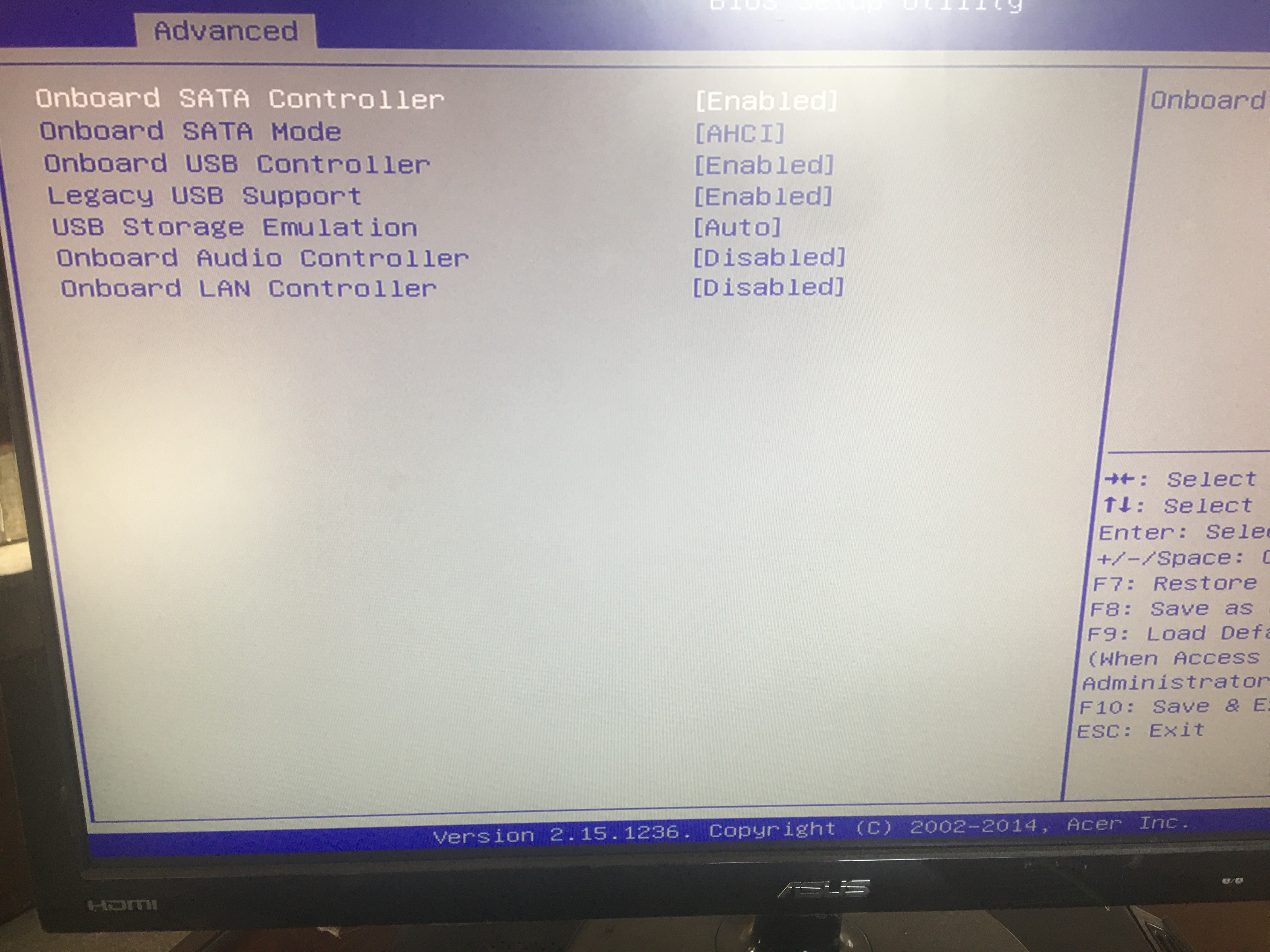

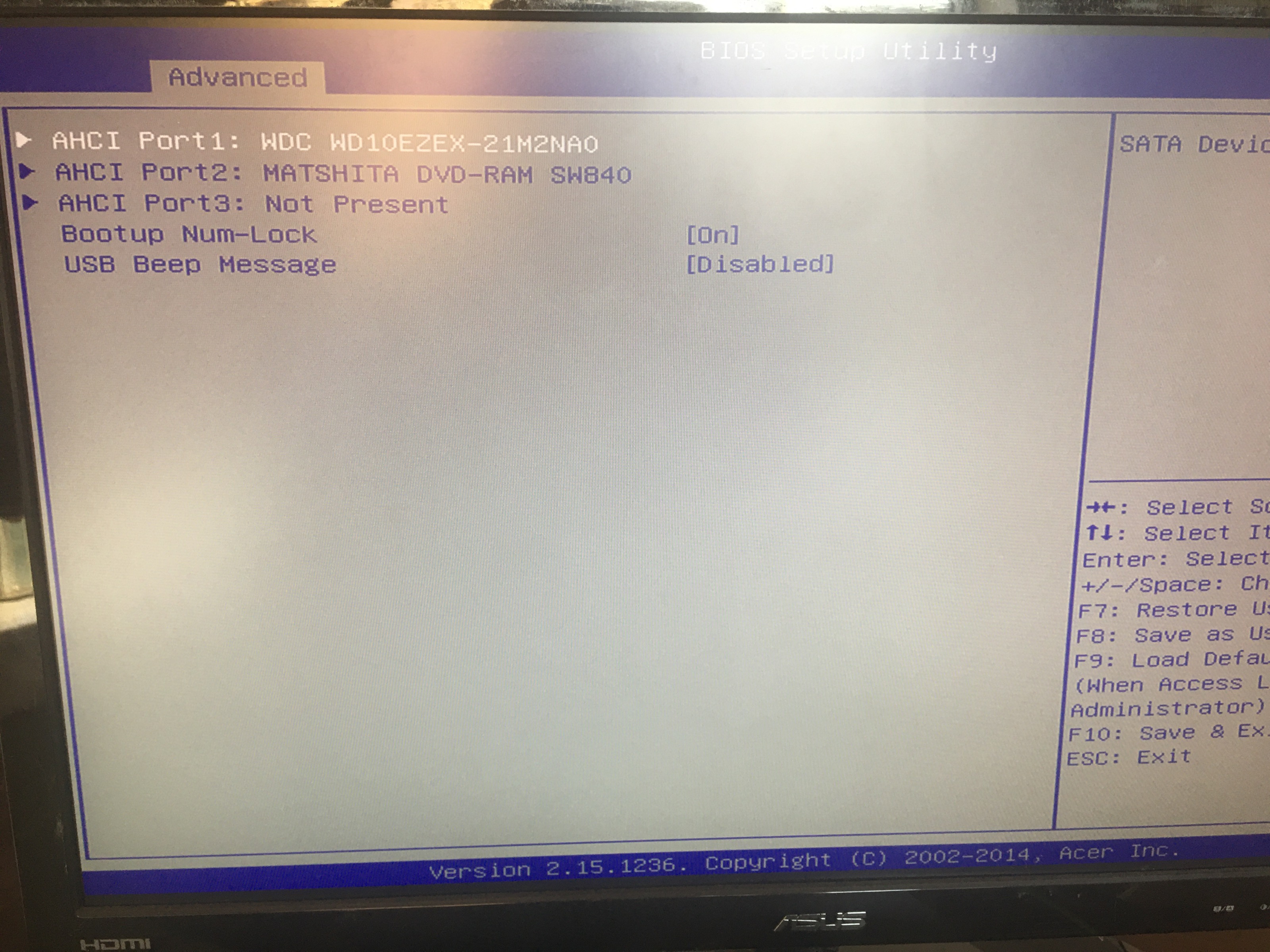

- riversvic
- Posts: 29
- Thank you received: 3
23 Jul 2020 21:12 #175591
by riversvic
Replied by riversvic on topic Massive Latency, and no PCI port Acer
I Did find some more items to disable in the bios. When it booted the computer blew out some dust, apparently the fan hasn’t ran in a while.
