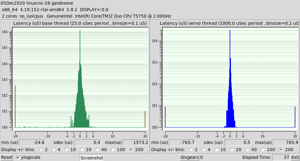

- Vescovo
- Posts: 18

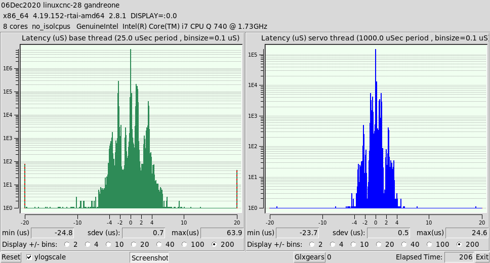

04 Dec 2020 07:54 - 06 Dec 2020 12:50 #191027
by Vescovo
Replied by Vescovo on topic RTAI with 4.19.152 - Bugs Fixed. Testers Needed
There is an error in the dmesg file named lboot2.log included in zip. I am not versed well enough to comment maybe this is a source of problems. Another strange occurrence is that all of the "Home" folders are greyed out in file manager.
The Computer is a old I7 with 8G of Dram. Is it possible I did something wrong?

A RETEST of the USB functions without the previous errors. Did the use of the USB in the other 3 computers make changes? YES IT DOES!!! A repeat situation with a build of USB-2 drive created the same error as above. Following steps 1->5 below did not clear the problem. After USB-2 was booted on the Acer-Veritron with the latency-histogram test successful the USB-2 drive was moved to the ACER-8943G. The problem no longer occurred. Most likely the Environment variables changed? I was not smart enough to make a copy of them beforehand!
The Hang on reboot also disappeared. The reboot hang is similar to the what occurs when the UUID of the swap partition is incorrect. The following steps did NOT correct the problem. The hang occurs because the RTAI scheduler cannot be unloaded.
sudo halrun -U did not unload it.

05 Dec 2020 07:20 - 06 Dec 2020 05:13 #191121
by Vescovo
Successful boot from SAME USB on Acer Veritron dual core. See Veritron.log.txt file.
Last edit: 06 Dec 2020 05:13 by Vescovo.

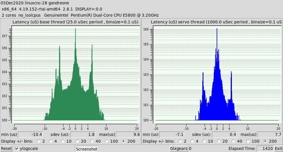

- Vescovo
- Posts: 18
05 Dec 2020 09:38 - 06 Dec 2020 05:10 #191128
by Vescovo
