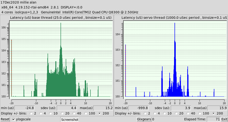

I tried latency-histogram , and it usually worked. However occasionally I get a servo latency of -999.8 right at the start and the following error messages:
msg=can't use non-numeric floating-point value as operand of "*" (variance=-1014672226)
msg=can't use non-numeric floating-point value as operand of "*" (variance=-1558858668)
This package is uninstallable
Conflicts with the installed package 'linuxcnc-uspace'
So, I removed linuxcnc using the synaptics package manage, and it installed after that.
