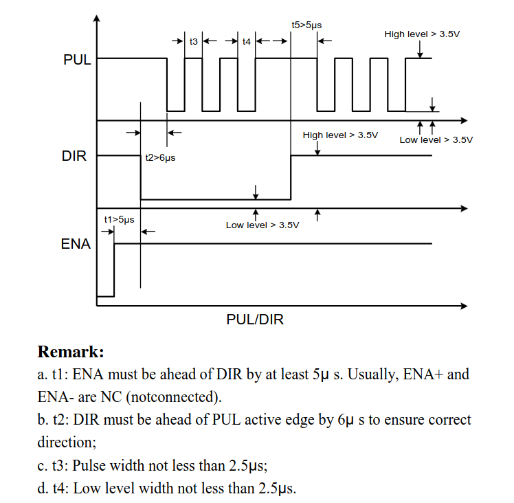

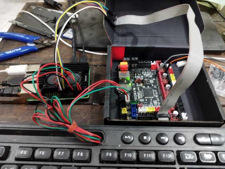

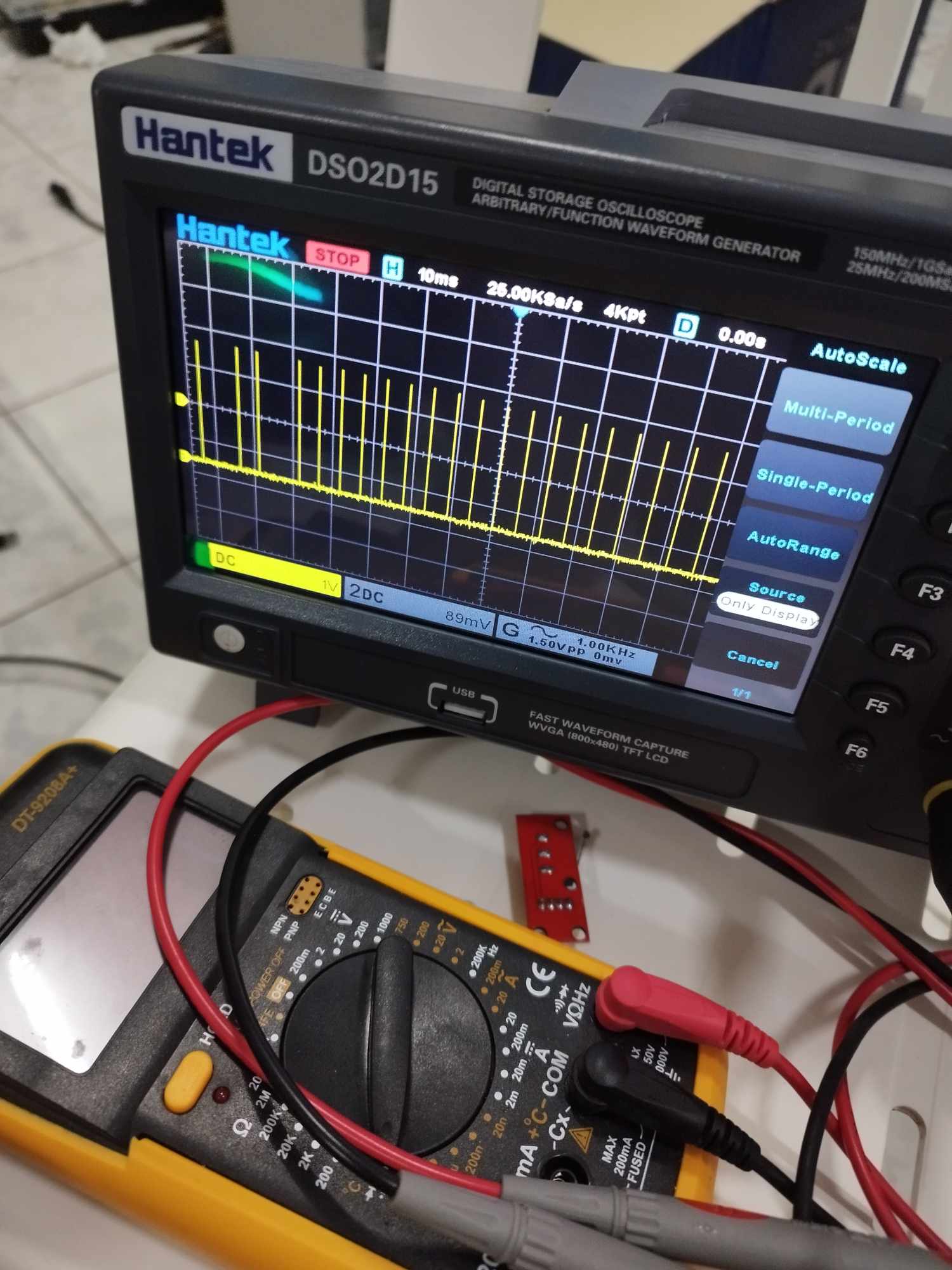

i am currently setting up remora on skr 1.4 (LPC1768) rpi4 and HBS86H(hardware-cnc.nl/images/PDF/ACT/HBS86H_English_Manuel.pdf) as the step motor driver.
so far i manage to get the remora_xyz.hal running and the step pulse show up on oscilloscope.
but i have not yet test the setup with HBS86H driver yet since the driver require 5v-24v input so i am waiting for a logic level shifter
currently my only concern right now is about the direction change and step pulse timing
as in the timing diagram from datasheet, it shown that direction state need to be toggle at least 6 uSec before the next active step pulsing.
so my question is
"with my current setup,will remora toggle the direction pin at least 6uSec before next step pulse?"
with the oscilloscope i can see that one step pulse took 25 uSecs but i am not sure about how much early direction pin will be toggled when changing direction. i cant really test it because i have only one probe.
accoding to sccota's reply from a post in Jul 2021, base thread took at least 8us to execute therefore direction pins will definitely be toggled at least 8us before next step pulse right?

28 Jan 2024 20:22 #291826
by scotta
Replied by scotta on topic Remora - Rpi Software Stepping Using External Microcontroller via SPI
There is no configuration setting for step and direction timing in the original Remora. I've used it like this for many years without issue. Remember, that on a direction change the velocity will be zero or close to it. So the likelihood of a step pulse being generated is very low.

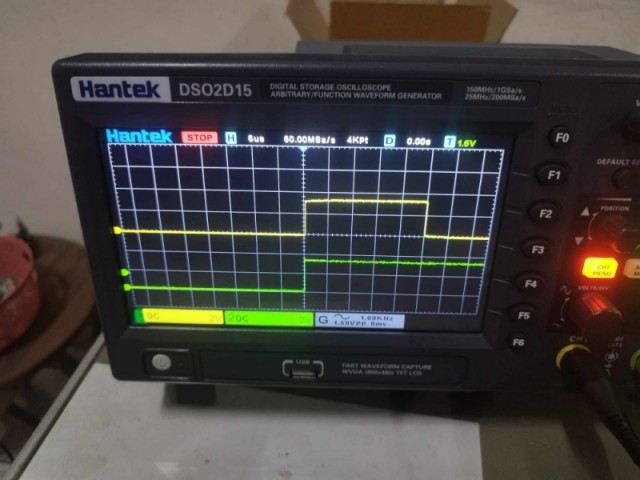

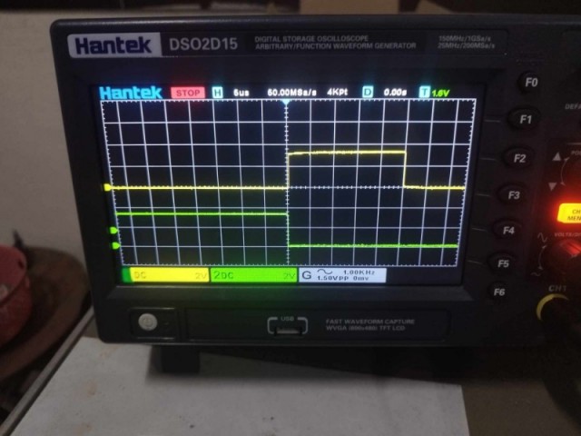

01 Feb 2024 19:19 #292156
by gittawat
i did a bit of testing after i got my second probe for the oscilloscope.
it seem like step pulse does happen when changing direction.
i create this result with by joging from right to left then left to right
luckily i can just change active pulse edge on HS86H driver to use the second rising/falling edge instead
as of right now,I'm planning to use Remora for other projects involved drivers like DM542 or tb6600 (both require direction to be change at least 5 uSecs before step pulse and they can't change the active edge.)
i dont really know how to correctly add a delay to the stepping pulse before changing direction. can you maybe explain how does stepgen.cpp work?
i mean i could try adding for loop count from 0 to some number as a delay after set directionPin statebut i am not sure if this will effect how remora works.
thanks,
gittawat
Replied by gittawat on topic Remora - Rpi Software Stepping Using External Microcontroller via SPI
hi scotta.There is no configuration setting for step and direction timing in the original Remora. I've used it like this for many years without issue. Remember, that on a direction change the velocity will be zero or close to it. So the likelihood of a step pulse being generated is very low.
(void Stepgen::makePulses())thanks,
gittawat

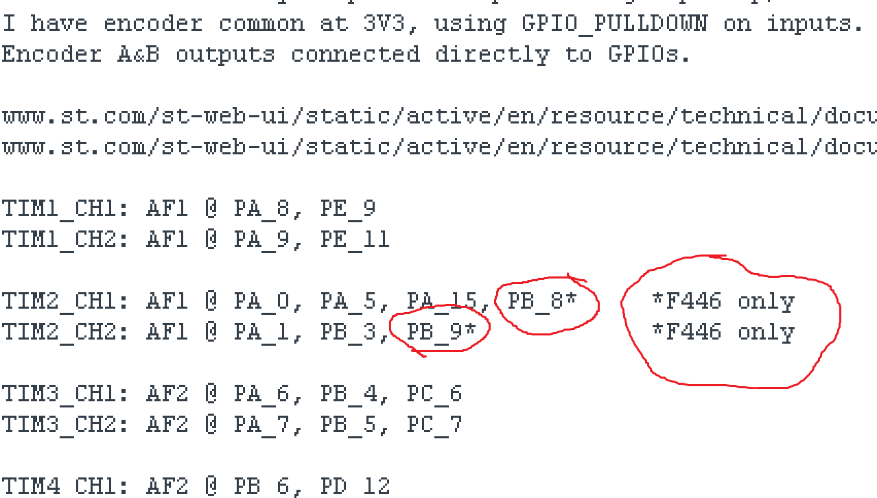

11 Feb 2024 21:45 #293109
by cakeslob
Replied by cakeslob on topic Remora - Rpi Software Stepping Using External Microcontroller via SPI
fuuuuuuu
Thats what I get for assuming the encoder pins would be the same, and not verifying. So hardware encoder needs a board revision, but software encoder should work.
In the meantime , I did a github for my board thing.
github.com/cakeslob/RRW_LAB
- Posts: 21893
- Thank you received: 7463
11 Feb 2024 22:17 #293110
Replied by tommylight on topic Remora - Rpi Software Stepping Using External Microcontroller via SPI
F446 is that the Octopus board?
