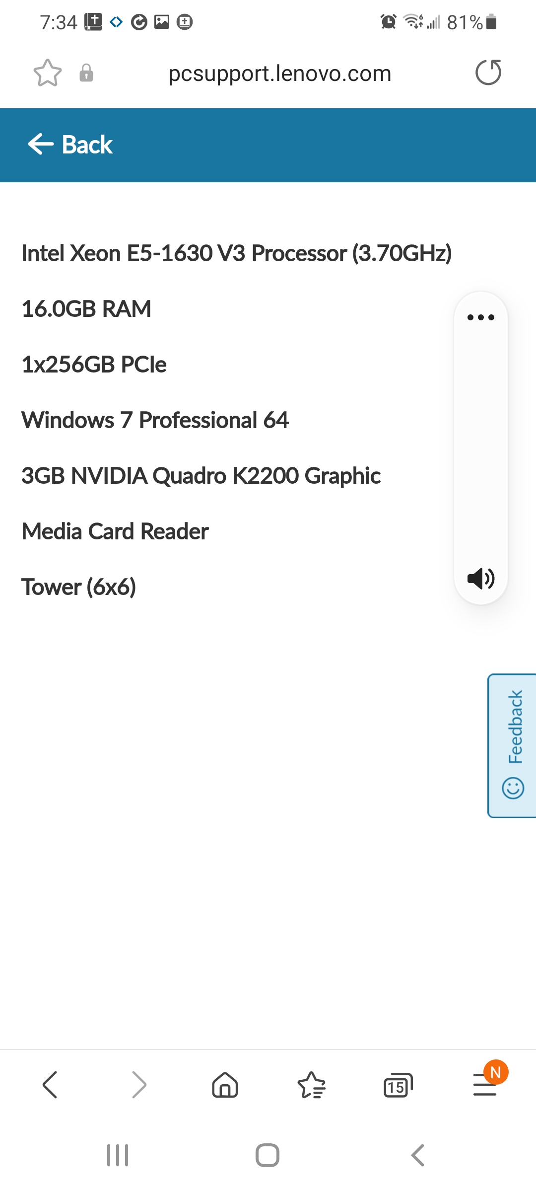

Looking at motherboard photos, there might be a parallel port header at the bottom near the SATA connectors.
It seems like a lot of PC, maybe more than necessary. Is it very cheap?

They are basically scraping the computer. They are installing all new PCs. I will have to get a new drive. They will be removing the original.

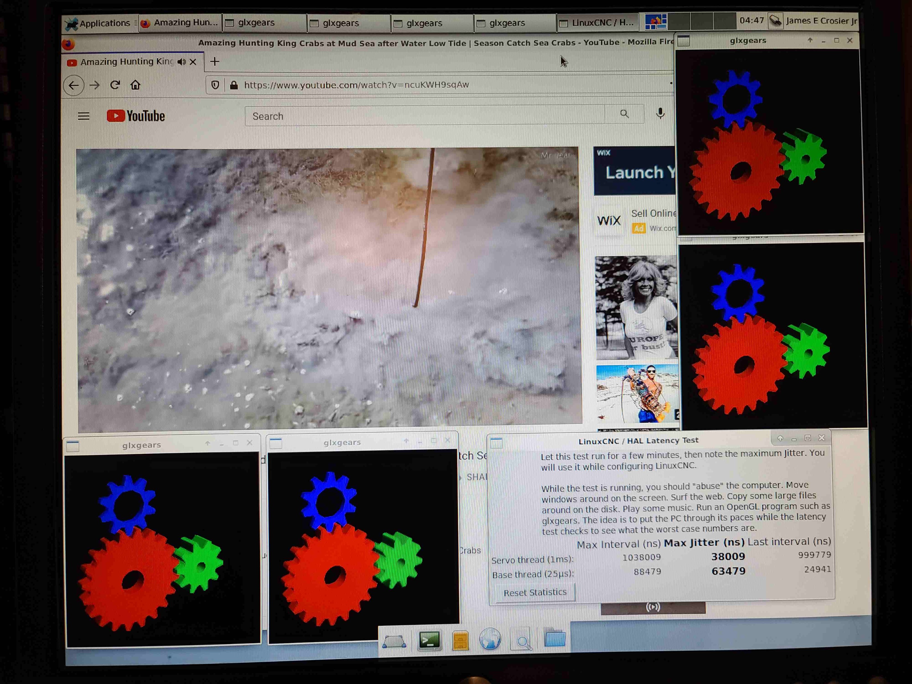

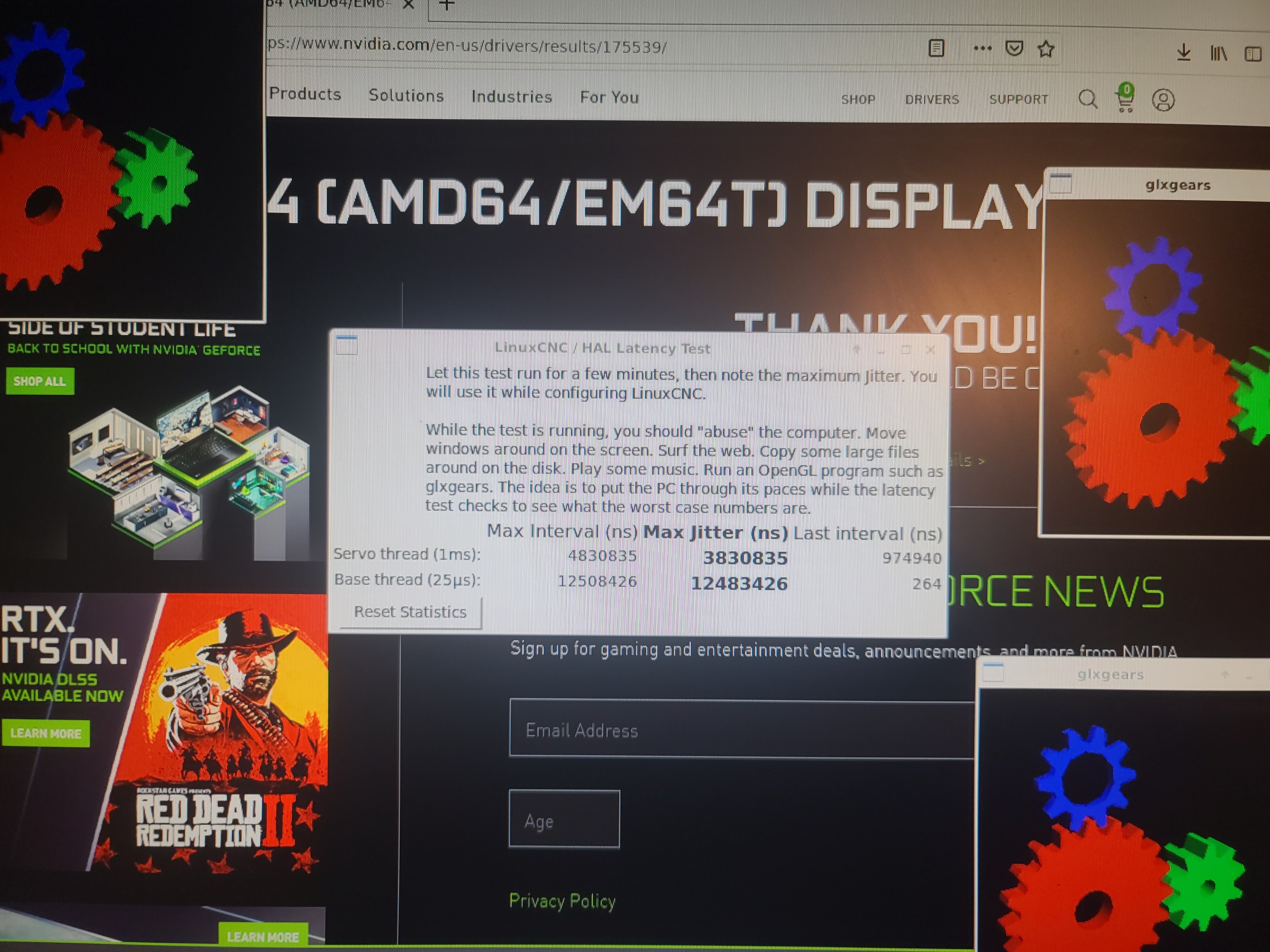

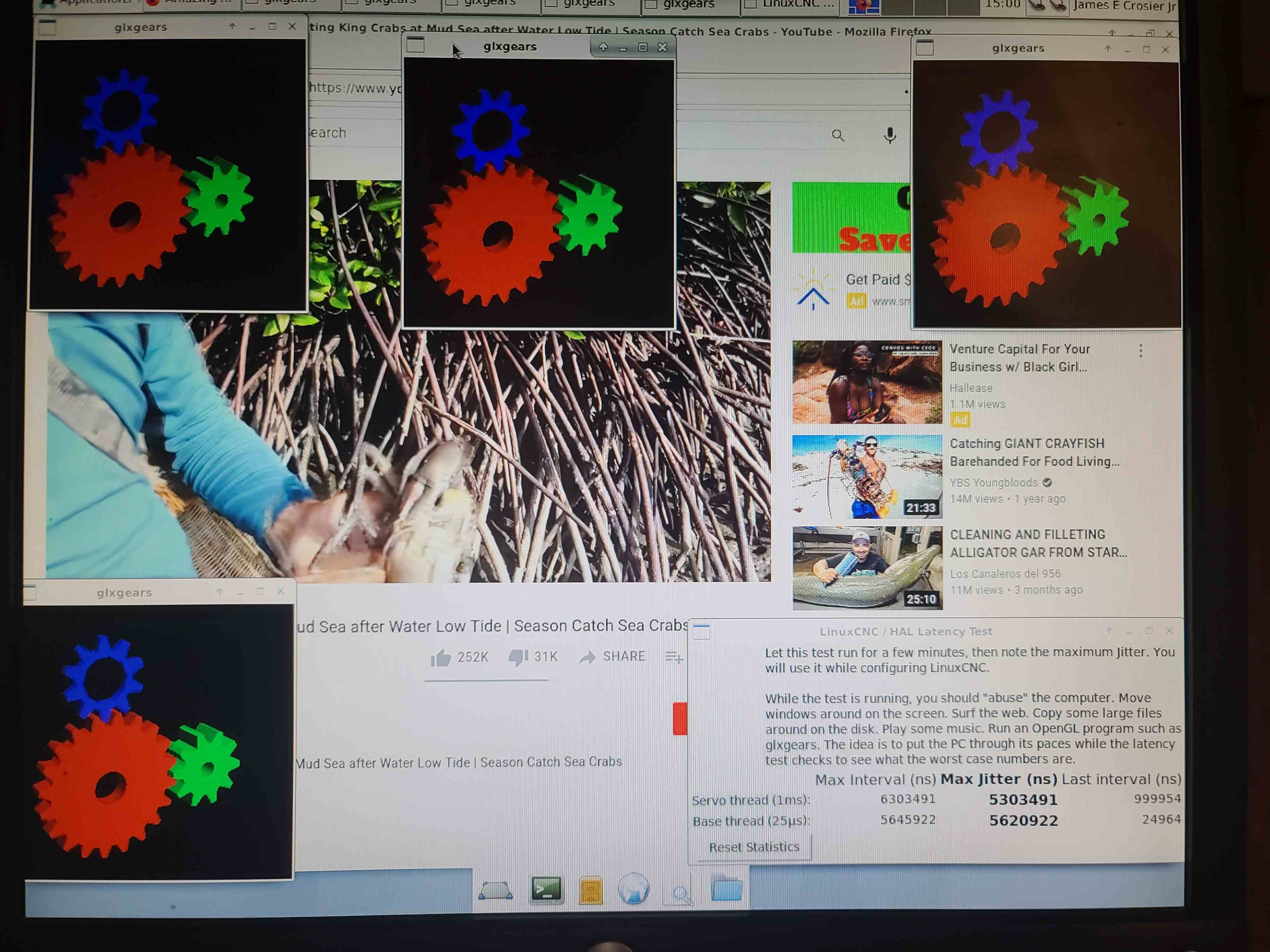

Thank to everyone for replying. Tommy I have turned off a few things in the bios. But i did some experimenting. I have an old PC that I built 10 years ago. It has an Asus M3N-HT Deluxe Motherboard along with an AMD Phenom II X4 Processor. I installed the LinuxCNC 2.8.2. Ran a latency test. It wasn't bad but nothing to write home about. LOL. So I removed the graphics card from the Lenovo and installed it in the PC that I built and ran another latency on the Asus PC. The test was terrible. One question I have is, can a HDMI to VGA adapter cause issues with a latency test. I don't have a high end monitor. Just an old school flat-screen with VGA only. I have added some pictures of before and after. Again this is on a different and older PC.
Thanks again for the help.
