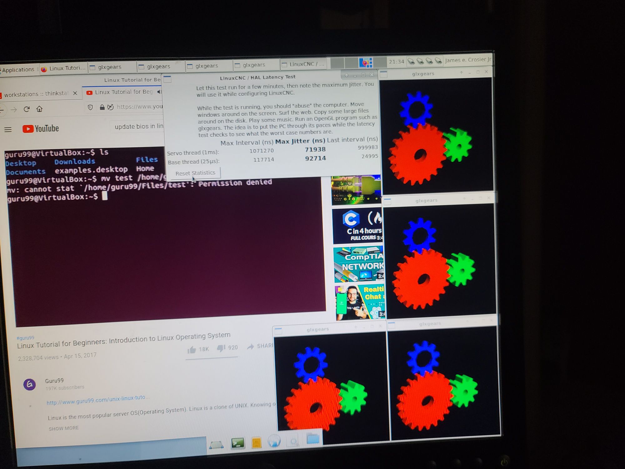

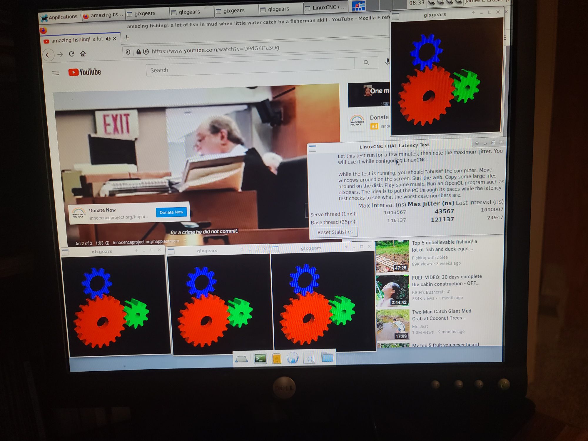

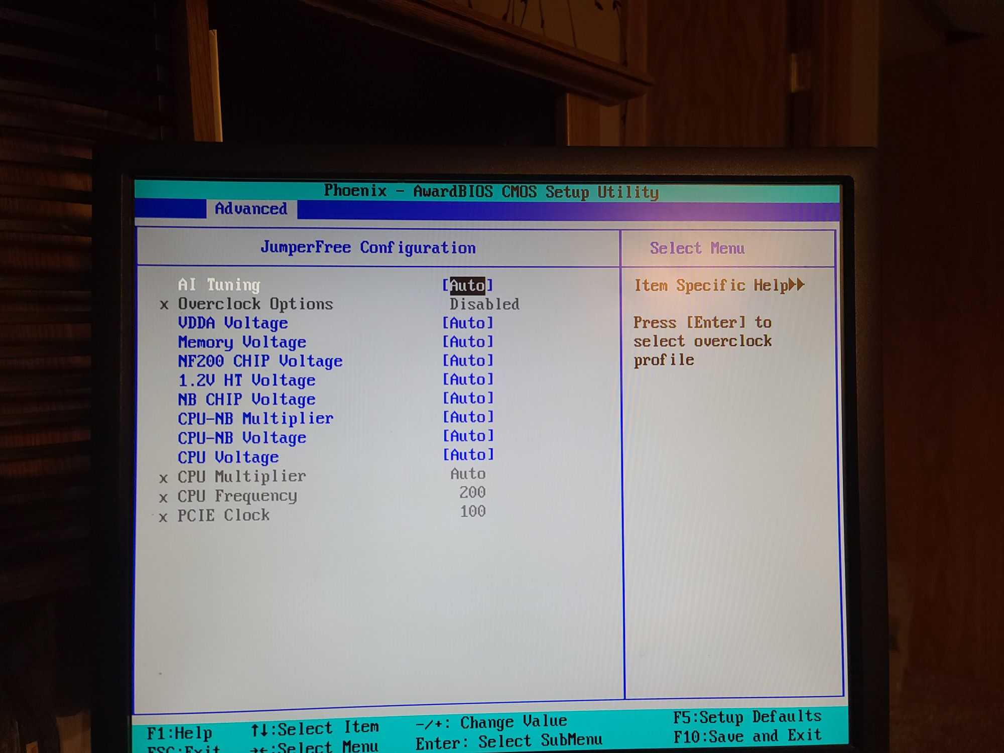

17 Aug 2021 04:16 - 17 Aug 2021 04:17 #217948
by JuniorC
Replied by JuniorC on topic LENOVO P500
I'm back. Yes the Asus M3N-HT Deluxe has on board video. The Lenovo P520 does not. I did some experimenting with the bios on the Lenovo. Tommy suggested to disable everything possible. So O took a jab at it. I couldn't believe all the things that were in the bios that could be disabled. It's better, I tried two different cards a MSI GeForce GT 1030 2G LP OC and an old dinosaur that I believe came out of a Dell PC. First picture is the MSI latency and the second is the dinosaur latency. There still needs to be some tweaks made. The Max Jitter seems to spike over 100,000 after running for more than an hour or so. It also seems to spike when shutting down the computer. Not sure if any of this matters. The older card seems to be a little less stable, even though it had a little better test.

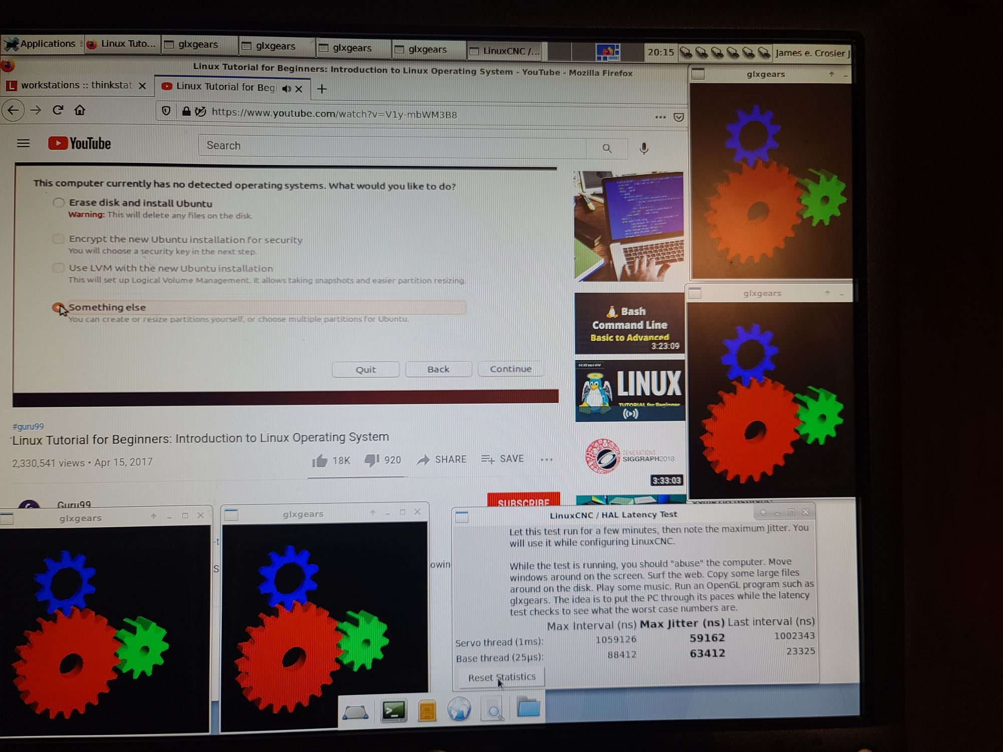

- JuniorC
- Posts: 59
17 Aug 2021 12:41 #217980
by JuniorC
- JuniorC
- Posts: 59
17 Aug 2021 14:03 #217985
by JuniorC
We have a few more older PCs in the scrap bin at work. I'll do some more experimenting. Do you guys think the Lenovo or Asus work well with a Mesa setup? I was just try to do a budget build. If the mesa cards are still available I'm willing to get one if needed.
