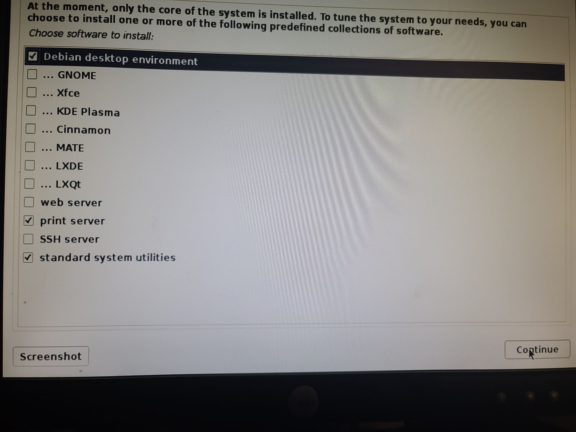

Andy, I followed the instructions in the link that you sent me. Everything went smoothly and I was able to try RTAI kernel. I'm sure if this occasionally happens, but my latency actually got worse. This was done one the Lenovo P520, and I also try all three graphics card that i have on hand.

Did you try isolcpus and other tweaks? RTAI tends to respond better than preempt-rt to isolcpus.
