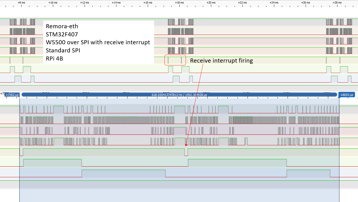

10 Jan 2022 21:35 - 10 Jan 2022 21:45 #231348
by scotta
Replied by scotta on topic Remora - ethernet
Below is the logic analyser output with the w5500 with interrupts. You can see the SPI bytes on the second channel with wasted time between them.
Bottom two channels are the LinuxCNC component read (read request + data out) and write (data + acknowledge message back) functions in action. With native ethernet these should be super short and back to a normal servo thread period.
