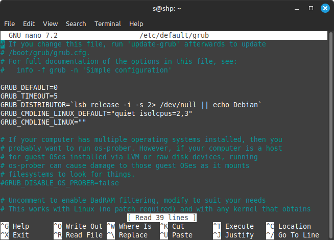

01 Dec 2023 11:17 - 01 Dec 2023 11:18 #286960
by zmrdko
Replied by zmrdko on topic Remora - ethernet NVEM / EC300 / EC500 cnc board
try:
sudo nano /etc/default/grub
then edit line starting with: GRUB_CMDLINE_LINUX_DEFAULT
from "quiet" to
"quiet isolcpus=2,3"
ctrl-s to save
ctrl-x to quit
then run
sudo update-grub
sudo reboot
more at:
wiki.linuxcnc.org/cgi-bin/wiki.pl?The_Is...ency_with_preempt_rt
chapter 4.2
from "quiet" to
ctrl-s to save
ctrl-x to quit
then run
sudo update-grub
sudo reboot
more at:
chapter 4.2

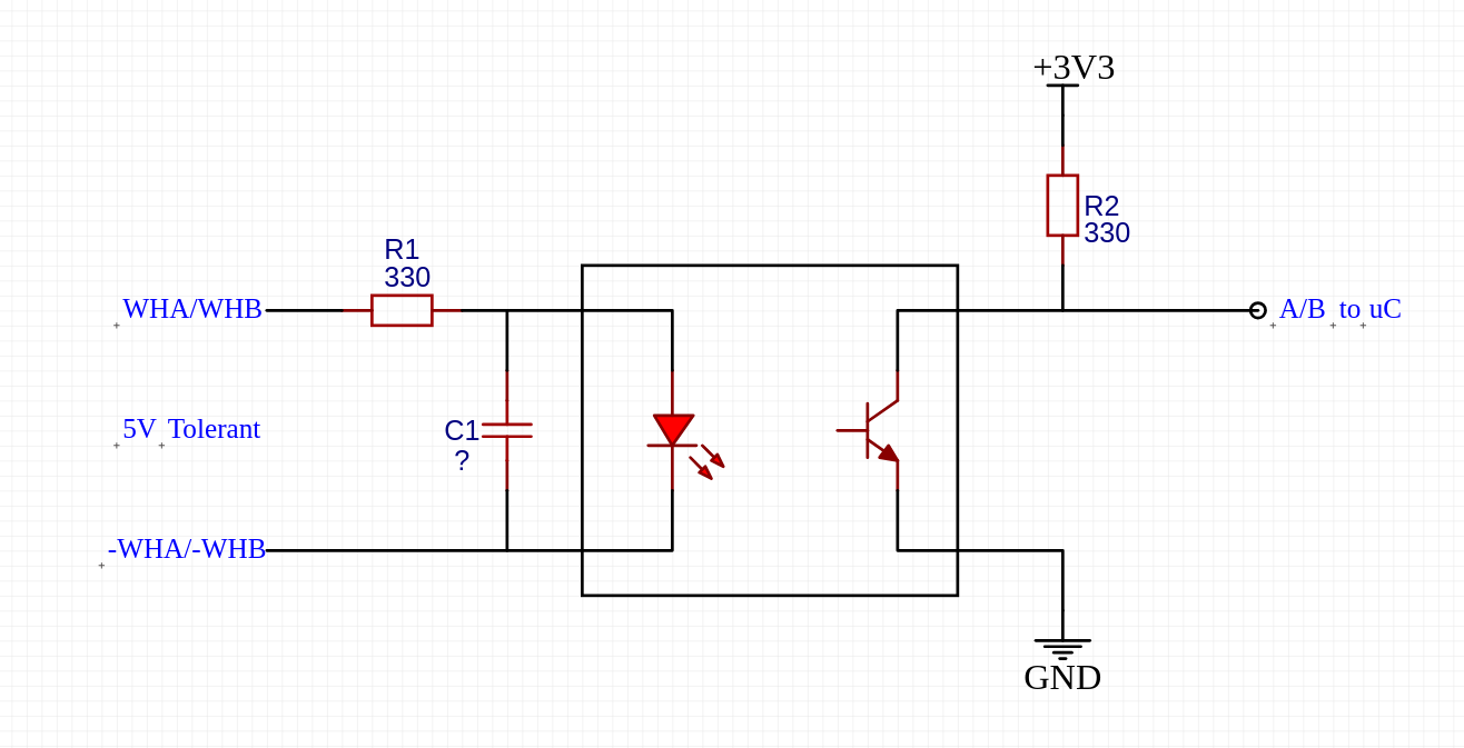

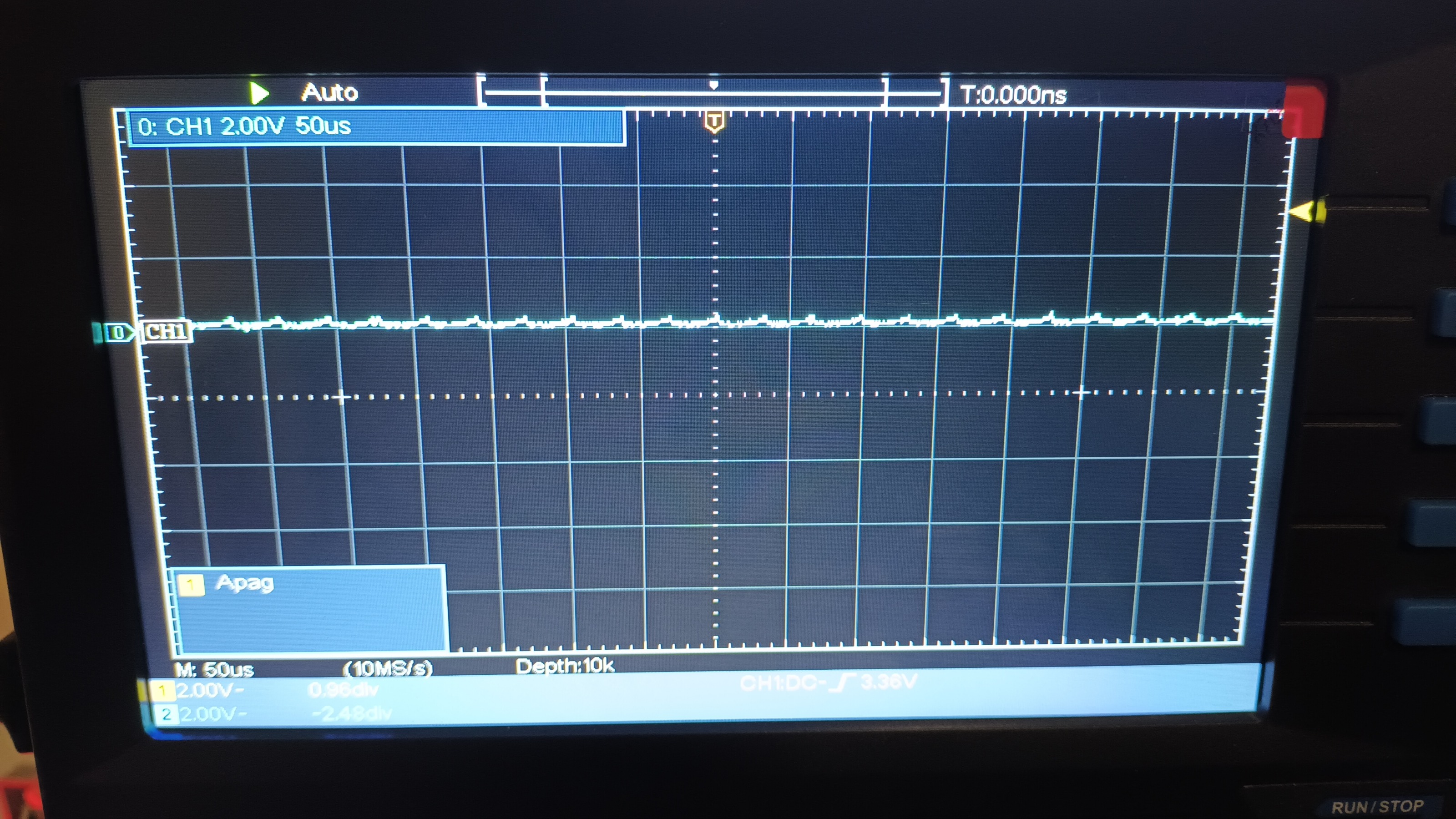

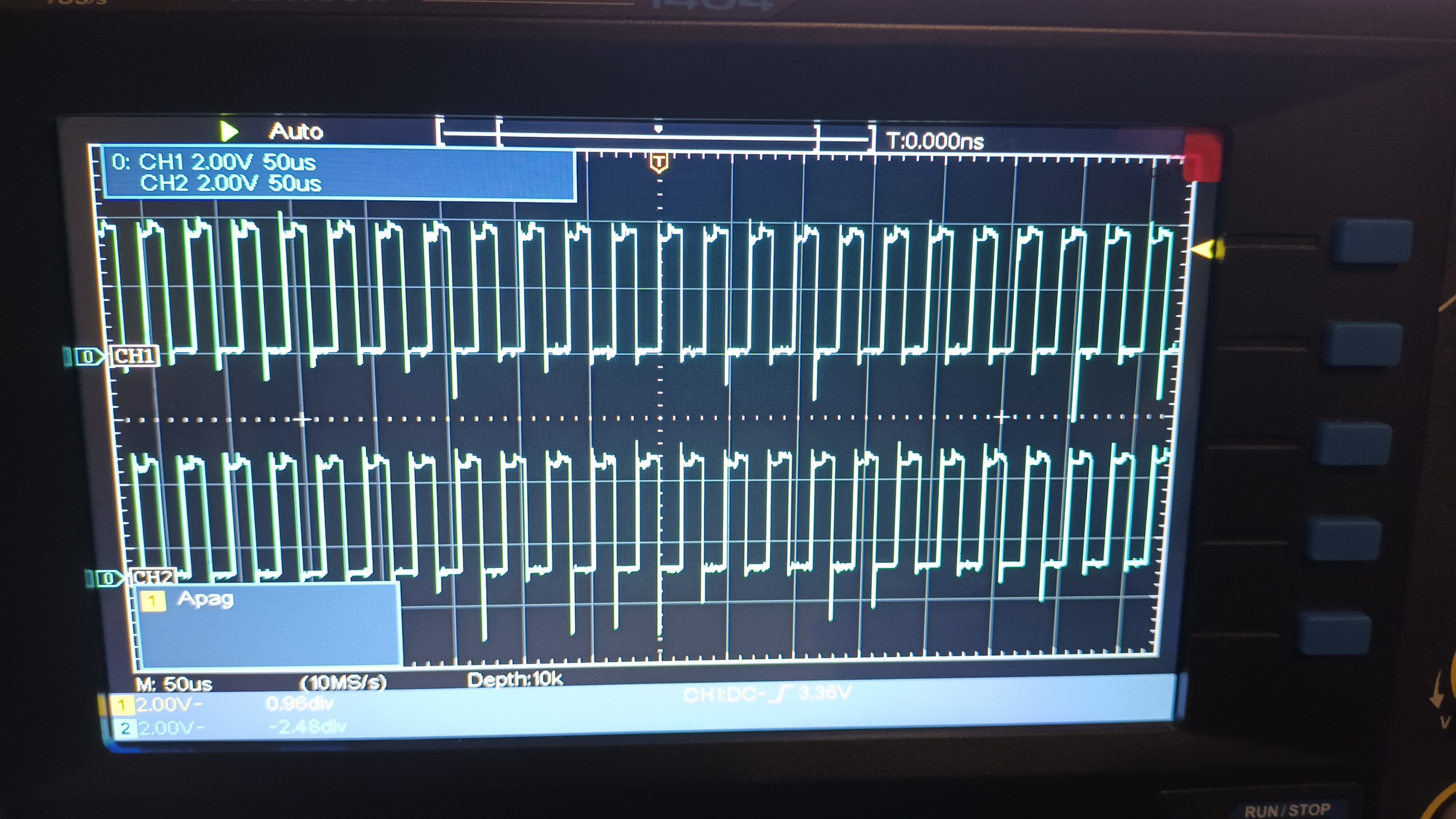

01 Dec 2023 20:31 - 01 Dec 2023 22:45 #286989
by rbobey1989
Replied by rbobey1989 on topic Remora - ethernet NVEM / EC300 / EC500 cnc board
Well, I got an oscilloscope, now I'm really frustrated, I was looking at the hal-oscilloscope first thinking where the ferror signal for joint_0 was starting to increase uncontrollably after 2500mm/min, so I borrowed an oscilloscope from my work and I just corroborate all my doubts about optocouplers, the images are only from channel A but the same is obtained for channel B.
Image 1. Schematic of the optocoupler circuit. Sorry R2->1k
Image 2. +A and -A signals polled directly at the encoder output, these are connected to +WHA and -WHA, 5V, speed 7000mm/min.
Image 3. Signal A probed optocoupler output "B119V EL3H7", 3.3V, speed 2500mm/min.
Image 4. Signal A probed optocoupler output "B119V EL3H7", 3.3V, speed 7000mm/min.
I have not tried with the other input pins that are connected to the "L247 M27" optocouplers but let's judge by the looks......
Ideas please......
Ideas please......

01 Dec 2023 21:15 #286990
by rbobey1989
I don't think the QDC module has many problems to deal with high speeds, for example let's take 12000mm/min (if it is possible for the machine to physically reach this speed)
With a direct coupling to a 5mm spindle, we would obtain:
1- 12000mm/min / 5mm = 2400rpm
2- 2400 rpm -> 40rps
3- 40rps * ENC_COUNTS = 40rps * 1000 = 40kHz pulse frequency channels A/B, I could add here that this is not a very high frequency.
All of the above would be for one axis, and we have calculated it for an encoder with 1000 pulses, that is, enough resolution, we could always lower the resolution of the encoder and lower the frequency of the pulses.
Of course all this is thinking about software, then we have such """beautiful""" images of optocoupler outputs as I published a moment ago.
Greetings.
Greetings.
