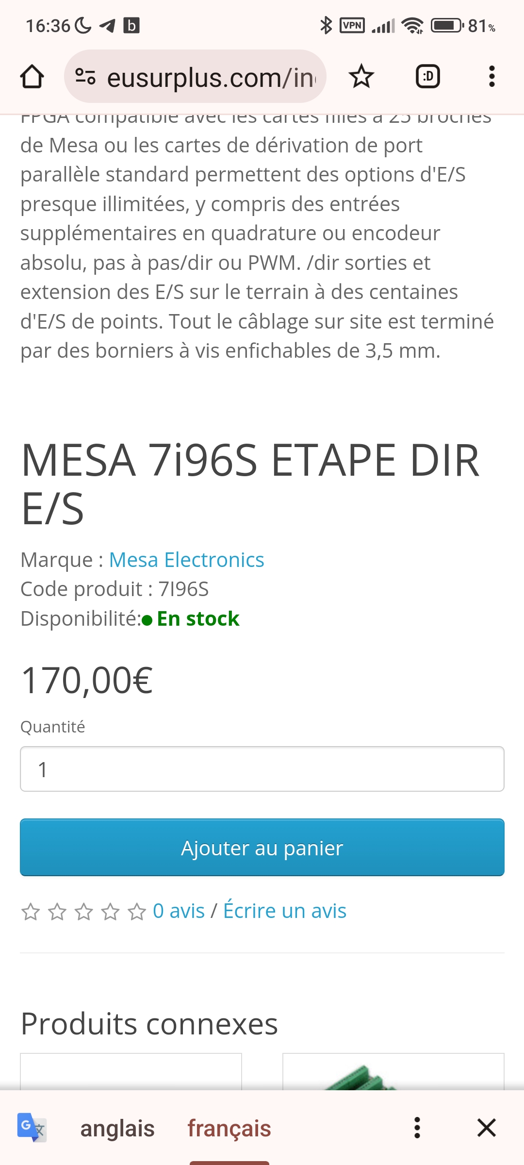

17 Dec 2023 15:29 #288413
Replied by tommylight on topic Remora - ethernet NVEM / EC300 / EC500 cnc board
How much do those NVEM stuff cost?
If they are over 100$, get a Mesa 7i96S.
I used several Mesa 7i92 for plasma machines, they are in use daily, so less that 100$ normal price ( i have to pay at least 200$ for one of 7i92) but not for beginners for sure as it is sensitive to miss wiring and EMI, so great care must be taken in regards to shielding and grounding.

17 Dec 2023 15:42 - 17 Dec 2023 15:44 #288419
by beauxnez
Replied by beauxnez on topic Remora - ethernet NVEM / EC300 / EC500 cnc board
Last edit: 17 Dec 2023 15:44 by beauxnez.
