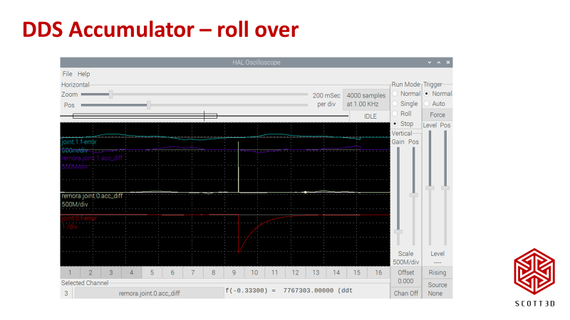

Hi, Roy interesting to know. I've been doing some investigation to try to understand where the spike (large delta) in the DDS accumulator is coming from. I was starting to think that it was due to the lack of a floating point unit in the F207, but if it's occuring in the F4 then it cannot be this as the F4 series has a FP unit.
I've got a version running which is updating the stepgen feedback in the servo thread, not every base thread execution. This allows for some debugging without crashing the MCU. There is something (rollover?) causing a large difference between two accumulator reads. I thought that moving to a 64 bit accumulator would solve this, but maybe my implementation is not correct. Still looking..
The spike could be filtered out, but this is a cheat. I'd rather understand the underlying cause and fix it.

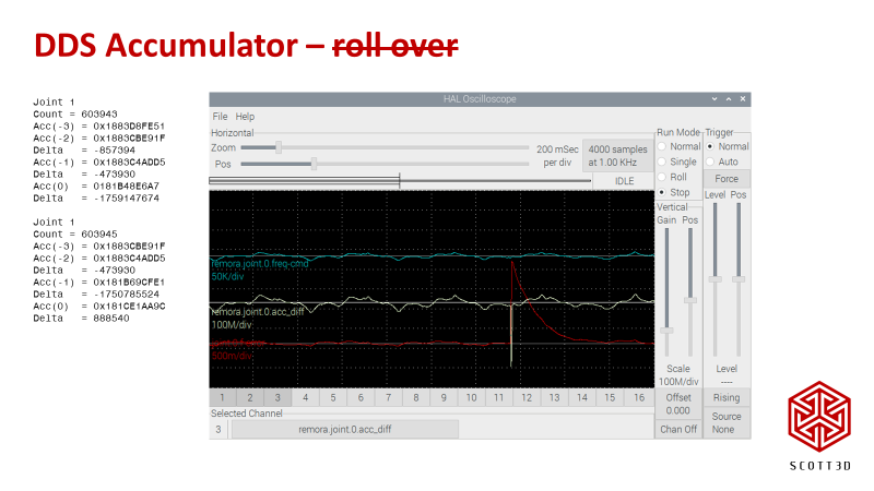

Working through the problem a bit more, with more questions than answers. I've coded a version of Remora that uses 64bit DDS accumulators and changes the LinuxCNC component to receive the incremental accumulator (delta) between two servo periods rather than the actual accumulator. What this has shown is that it is not related to the roll over of the DDS accumulator. It's bringing me back to the floating point operation where the frequency command is scaled to the accumulator "add value". In the debug output you can see the massive jump in the accumulator during the servo period.
Joint 1
Count = 603943
Acc(-3) = 0x1883D8FE51
Acc(-2) = 0x1883CBE91F
Delta = -857394
Acc(-1) = 0x1883C4ADD5
Delta = -473930
Acc(0) = 0181B48E6A7
Delta = -1759147674
Joint 1
Count = 603945
Acc(-3) = 0x1883CBE91F
Acc(-2) = 0x1883C4ADD5
Delta = -473930
Acc(-1) = 0x181B69CFE1
Delta = -1750785524
Acc(0) = 0x181CE1AA9C
Delta = 888540Attachments:

I modified the remora-eth.c to ignore and log any delta larger than 40 counts. I ran the controller through a simple program and collected several hundred error events. Occasionally such an event would cause the controller to become slow and unresponsive for 0.3-0.4 seconds followed by a reset. This usually results in a following error, turning off the machine. The rest of the time the errors were single jump events which were successfully ignored and logged by my modified remora-eth in the raspberry pi.
263 out of 310 logged events involved a jump ~419 counts. 228 of those were near a stop or direction change. The rest occurred at low speeds. The other 47 jumps were generally 50-100 counts. They generally occurred while the axis was moving.
I added a whole bunch printfs inside if statements and found that every once in a while frequencyCommand within the stepgen module has a value close to 2^24. It seems as though it is losing a byte somewhere.
Interestingly: 2^24 Hz * frequencyScale (104.8576) = 1759218604 which is 419.43 x 2^22
This appears to be where the jumps of ~419 counts is coming from. On a direction change the high bytes go from all 0 to all f or back, if the highest byte is left out this results in a value of 2^24. I have also recorded values of ~2^16 suggesting 2 lost bytes. Without a direction change the issue does not seem to be as bad. Possibly the byte is retaining the old value, so if the values don't change too much it isn't as large of a jump if it jumps at all. This suggests that these errors are going on more frequently and going undetected until the value changes by a large enough to cause an issue.
On the plus side this means the accumulator is working, its just getting faulted input for some reason. I wondered if this was coming from the copy from rxBuffer to rxData being interrupted. but the same check that catches frequencyCommand being out of range in stepgen does not detect an error when implemented immediately after the copy. I tried making multiple reads, but it consistently reads the wrong value. I confirmed that at startup the pointers are configured correctly.
I am not very familiar with the debugging tools or 32 bit microcontrollers in general. I have been reading about the debugger and how to get more data about the point of failure so hopefully I can drill down further to the root of the problem.
