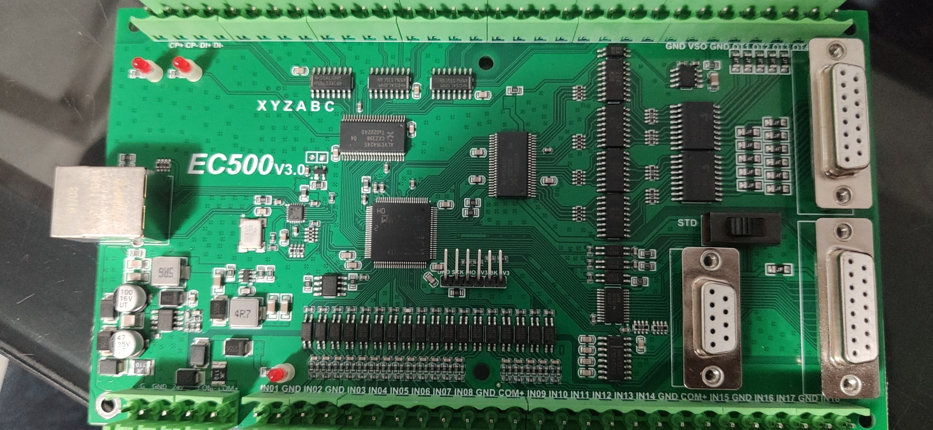

25 Jun 2022 22:11 #245885
by scotta
I've been contacted regarding Remora for the Digital Dream EC500 controller board and was sent some pictures. The EC500 looks to be very similar to the NVEM but running a STM32F407. It is a 24V IO card which would suit using normal industrial sensors etc.
I'm going to try and help get this running on his board in Brazil from the other side of the world. Let's see how this goes.
