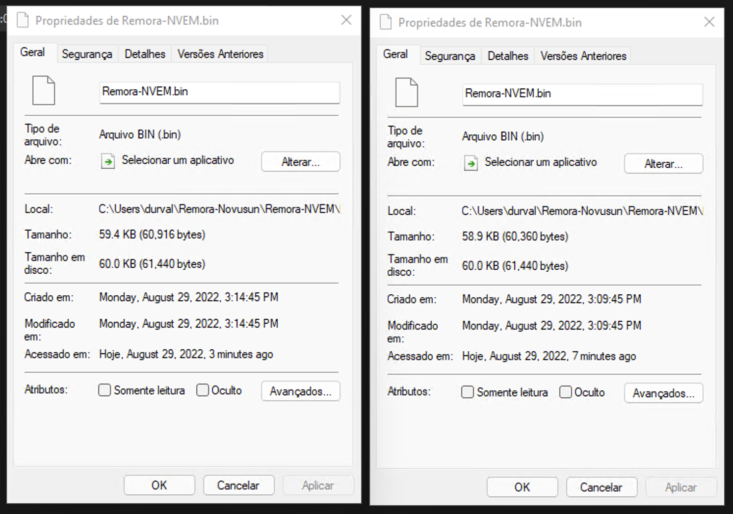

29 Aug 2022 18:27 #250715
by kwarup
Replied by kwarup on topic Remora - ethernet NVEM / EC300 / EC500 cnc board
Hi Scott,
After cloning Remora-novusum from github.com/scottalford75/Remora-Novusun
and compiled the project without any modification in all 3 platforms (Mac, Linux, Windows11) the result is a file greater in size than the same file in the Firmware Folder..
After the compilation the file was uploaded to the Novusun NVEM and in all 3 files from each OS ( Mac, windows and linux) neither one worked, the Novusun has no IP-Address and and for that, impossible to ping the board
Is there any trick or anything that I'm not seeing?
