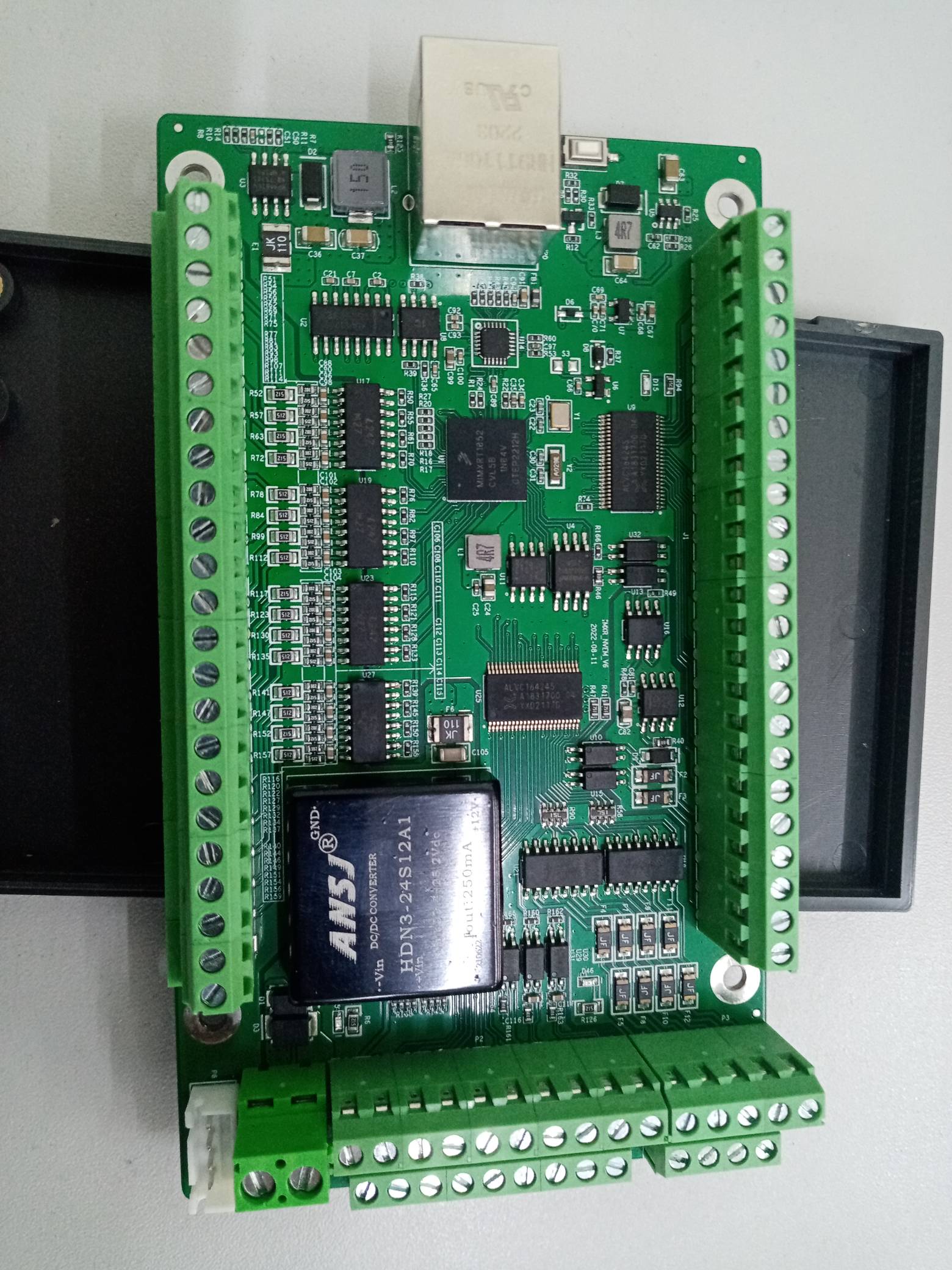

06 Sep 2022 07:42 #251268
by scotta
EC300 has shipped, two days after order. Super curious re the MCU...

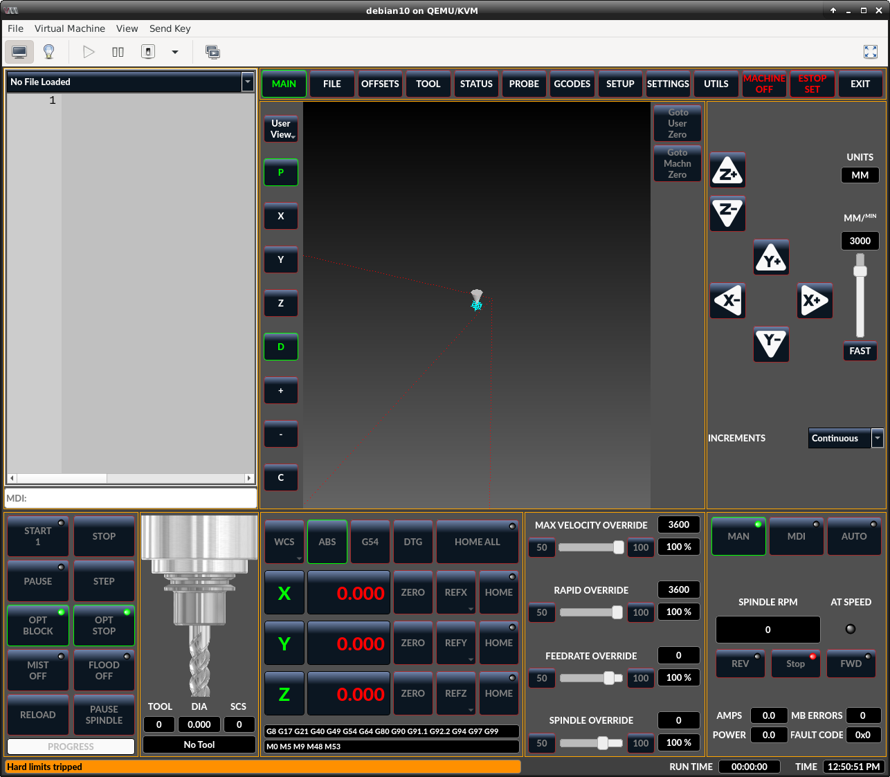

06 Sep 2022 16:00 #251310
by kwarup
Replied by kwarup on topic Remora - ethernet NVEM / EC300 / EC500 cnc board
I just have created a qt1280x1024.deb with Remora example machine.it works only with 2.9.0pre.I've installed on a vm this package to see if it was ok.
here is the link on google drive qtRemora1200x1024.deb
also have a buster distribution with 2.9.0pre LinuxCNC Buster 2.9.0pre

- MX_Master
- Posts: 92
- Thank you received: 48
08 Sep 2022 12:31 #251482
by MX_Master
Replied by MX_Master on topic Remora - ethernet NVEM / EC300 / EC500 cnc board
Guys, new NVEMs has a new scheme and a new main chip - iMX RT1052.
