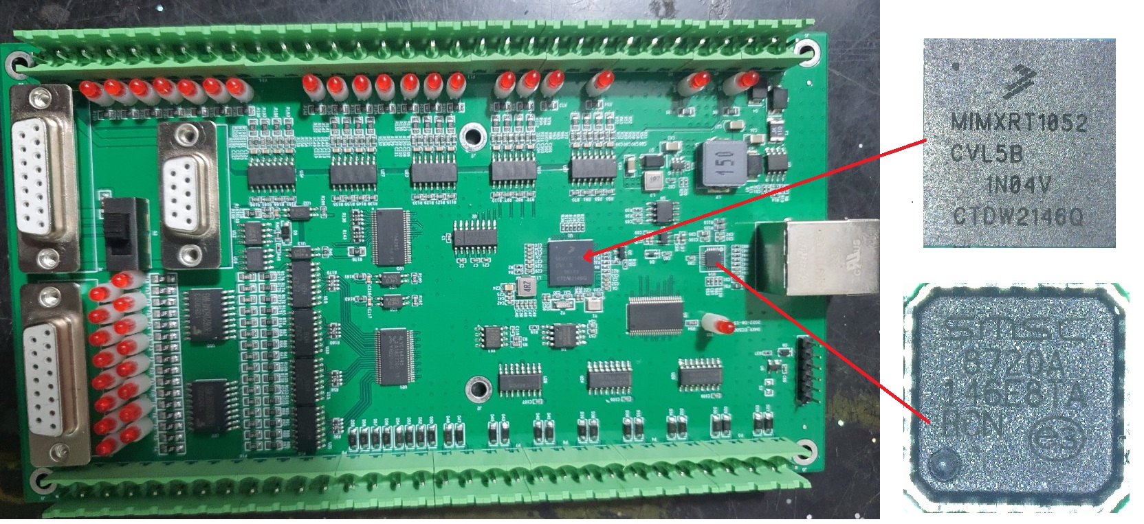

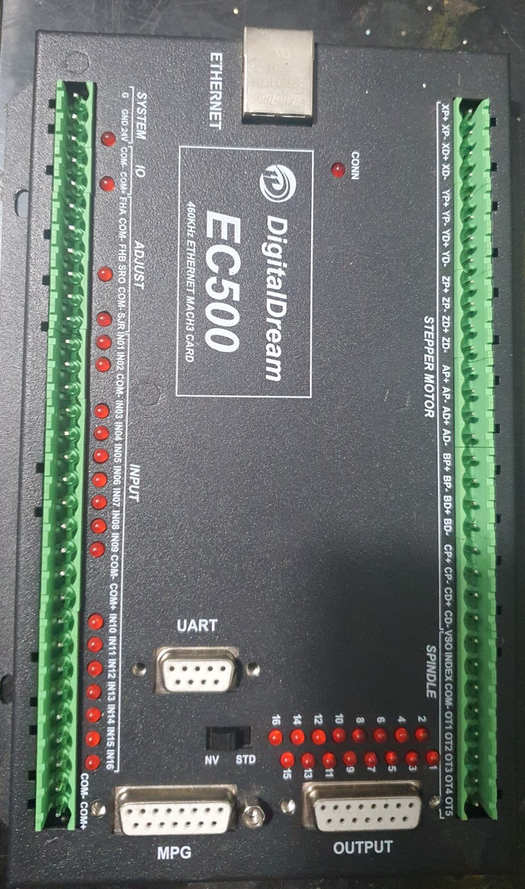

I bought EC500 from China market to use Mach3,They said my EC500 is version 5. As a saw there are some changed in board layout. (see the pictures). This such thing not working with Home and limit switch, another big issue makes me can live with it is Probe command "G31" not working! I dont got any support from that company!
Very interesting witch your working, Does has any firmware can run LinuxCNC on this board now? I go through page to page and get some Infor that till now only work with older version of ec500 using STM32 processor, And RT1052 is on develop?
Thank you for your great work
Best regard.

Hi, yes your board should be supported by the work to port Remora to the RT1052. I'll have an EC500 for testing in a week or so. Welcome to LinuxCNC!Hello scottaI
Best regard.
