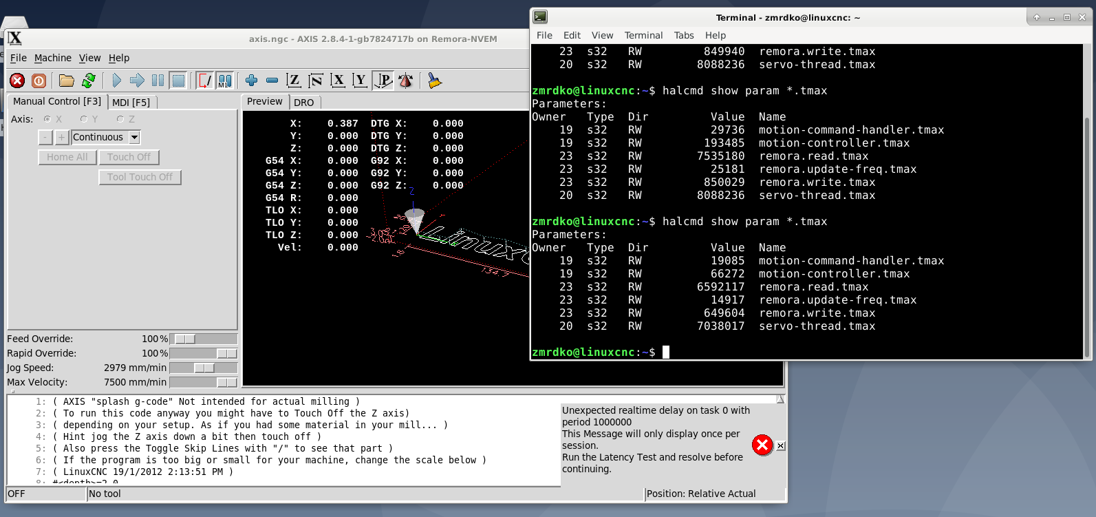

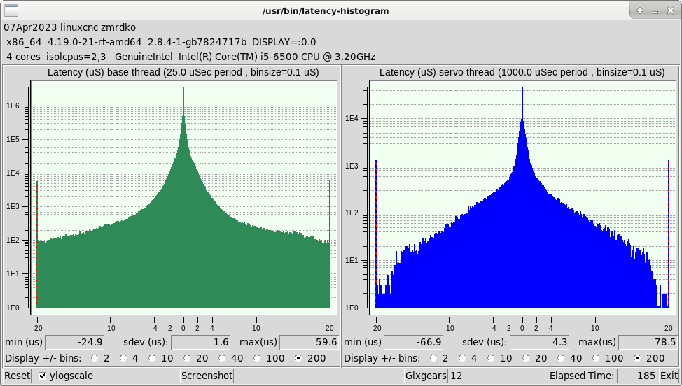

The current problem is that I'm struggling with unexpected latency delays:
I'm running LinuxCNC 2.8.4 Debian 10 Buster PREEMPT-RT ISO.
I have EC500 with RT1052 and PC is HP Prodesk 400 G4 with i5 6500 4c/4t and isolcpus=2,3, 16GB Ram and integrated graphics.
I am getting latency under 80k with dozen of glxgears and 4k video in background.
But I think there are some spikes in servo thread, when I toggle machine power (F2) ON in linuxcnc.
What am I doing wrong, or am I missing something?
I have flashed new firmware already. Unfortunately I'm still at early stage with linuxcnc.
Last edit: 07 Apr 2023 11:37 by zmrdko.

07 Apr 2023 12:11 #268506
Replied by tommylight on topic Remora - ethernet NVEM / EC300 / EC500 cnc board
Those are terribly bad numbers!
In BIOS, disable hyperthreading, speed step, turbo, virtualisation, C states, everything with power saving, PCI-E aggressive something or another??, etc.
Might also be due to thermal throttling of the processor, or failing hard drive or memory, based on those numbers.

07 Apr 2023 21:18 #268551
by scotta
Getting the realtime delay when turning machine power on is "normal" when using Remora. Apparently this is because LinuxCNC is not running a base thread. I have not dug into why the error message appears, but I've just got in the habit of clearing it and carrying on.Thanks!!
