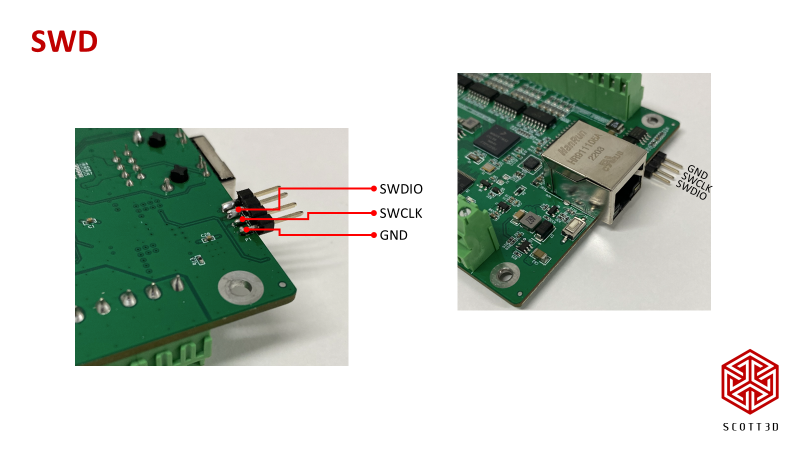

Sorry, RT1052 based NVEM pinout is as below.Thanks Scott, but thats for the EC300 I understand? Would the NVEM use the same order of pinout?
