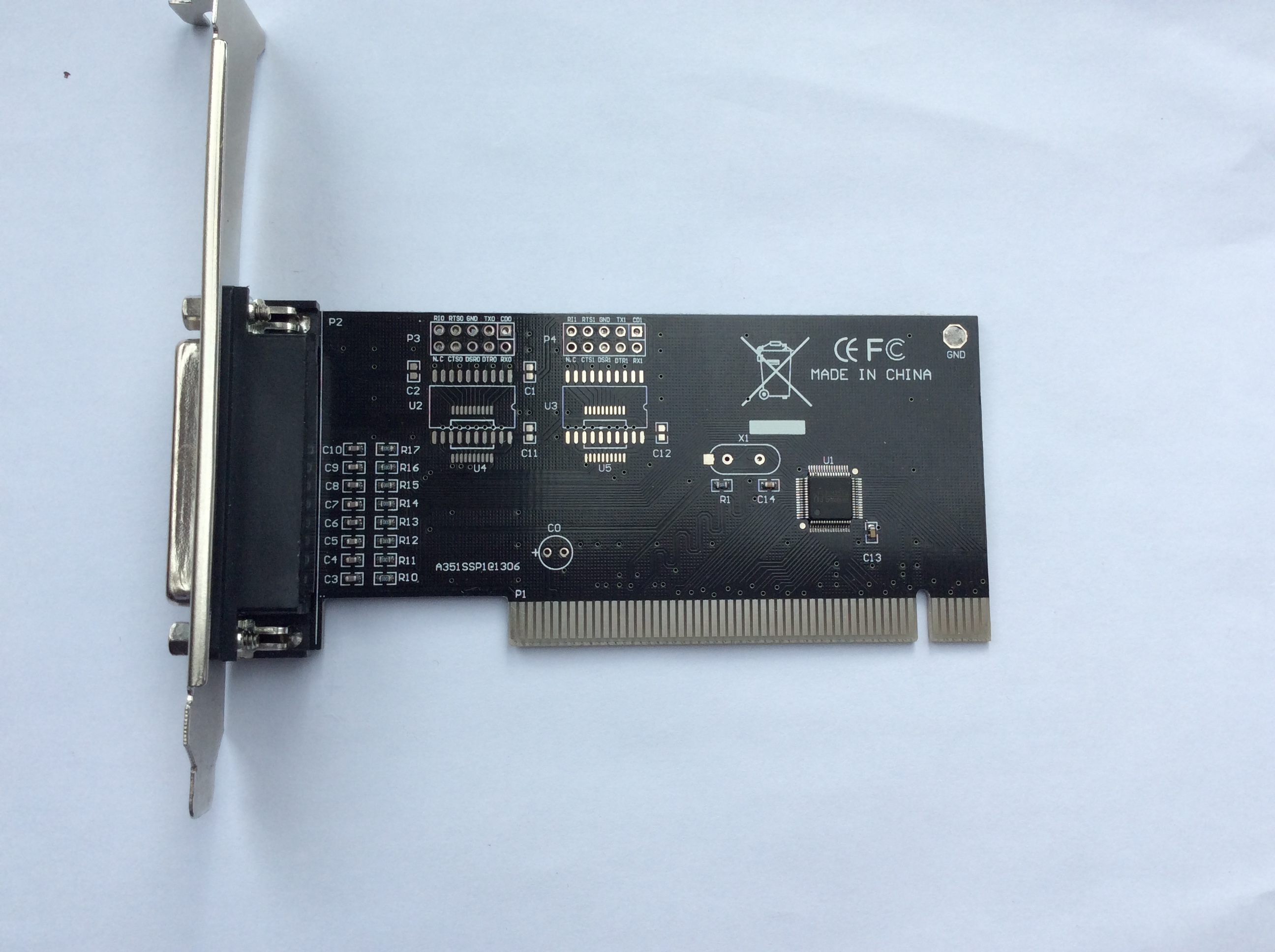

Picture of the parallel port card where the chip can be clearly seen ?
Not from the internet, take a picture of your card.

Hopefully I can attach pictures
I despair

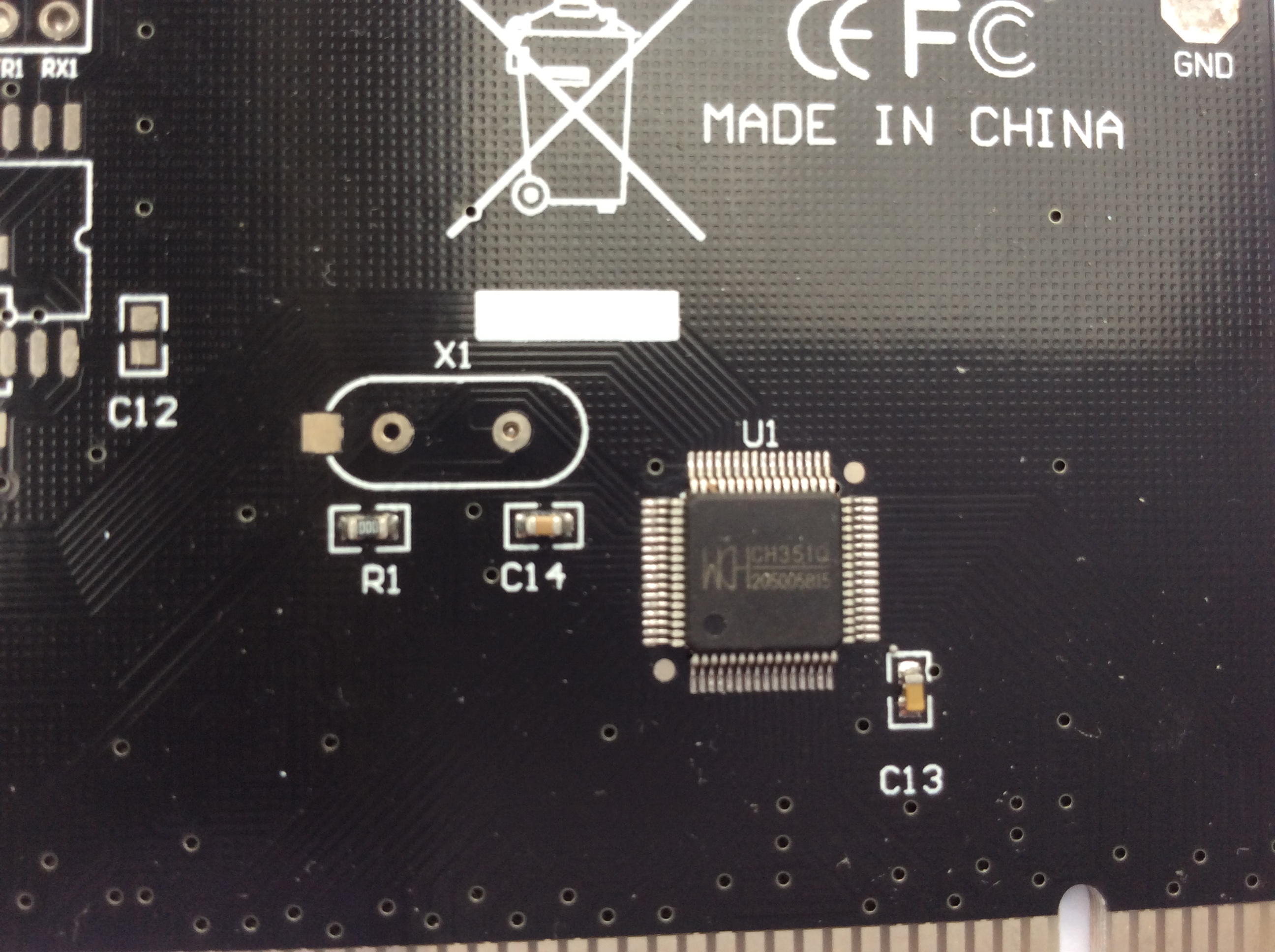

There is a single chip, CH351Q

Well, that will most probably not work.
Try to find something with the MosChip or NetMos on the chip, they always worked for me and are usually 15 to 20$ a piece.
