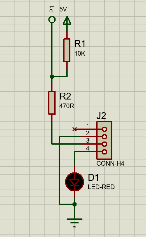

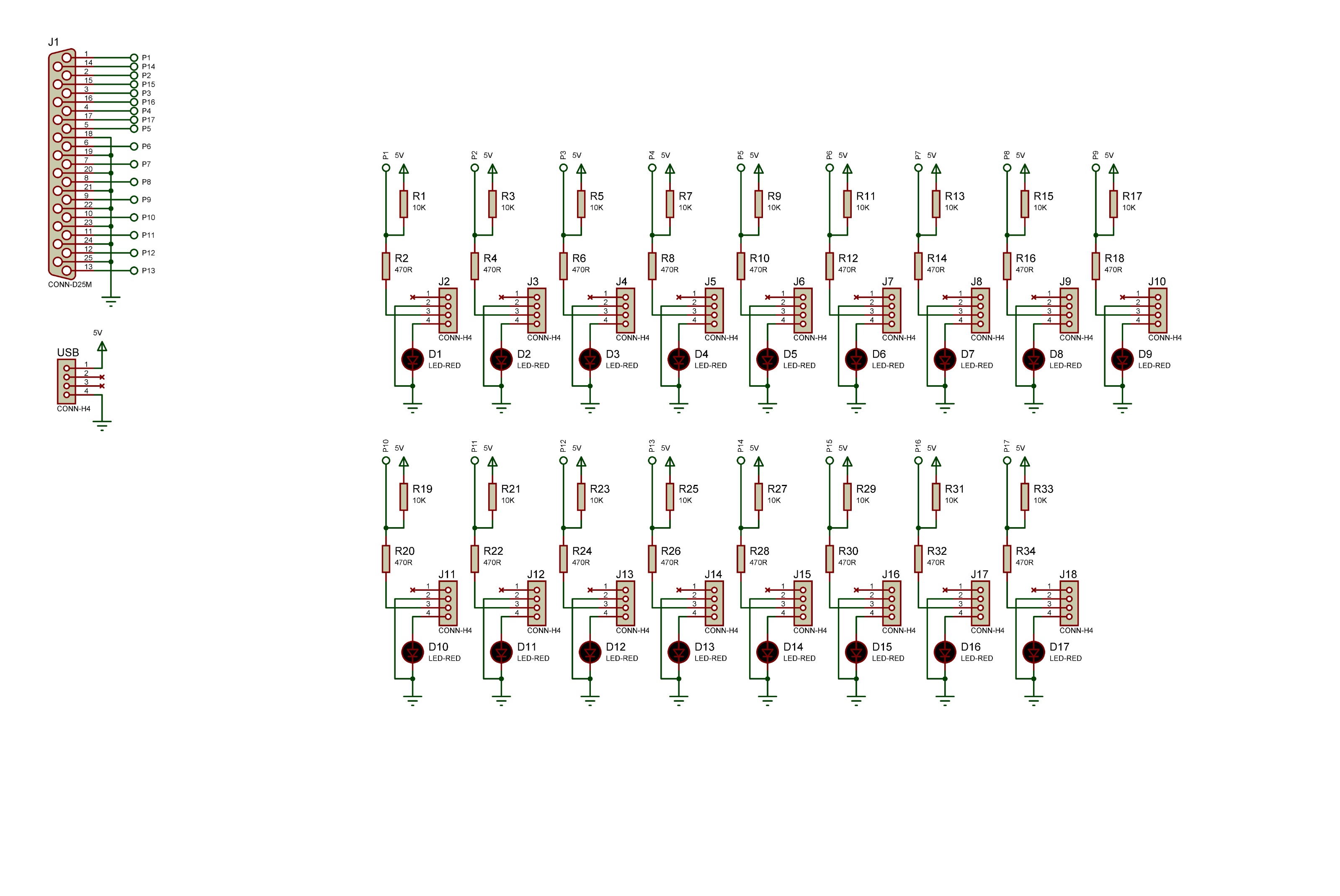

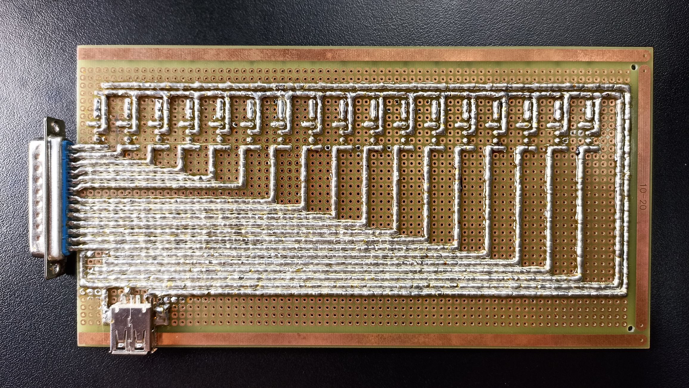

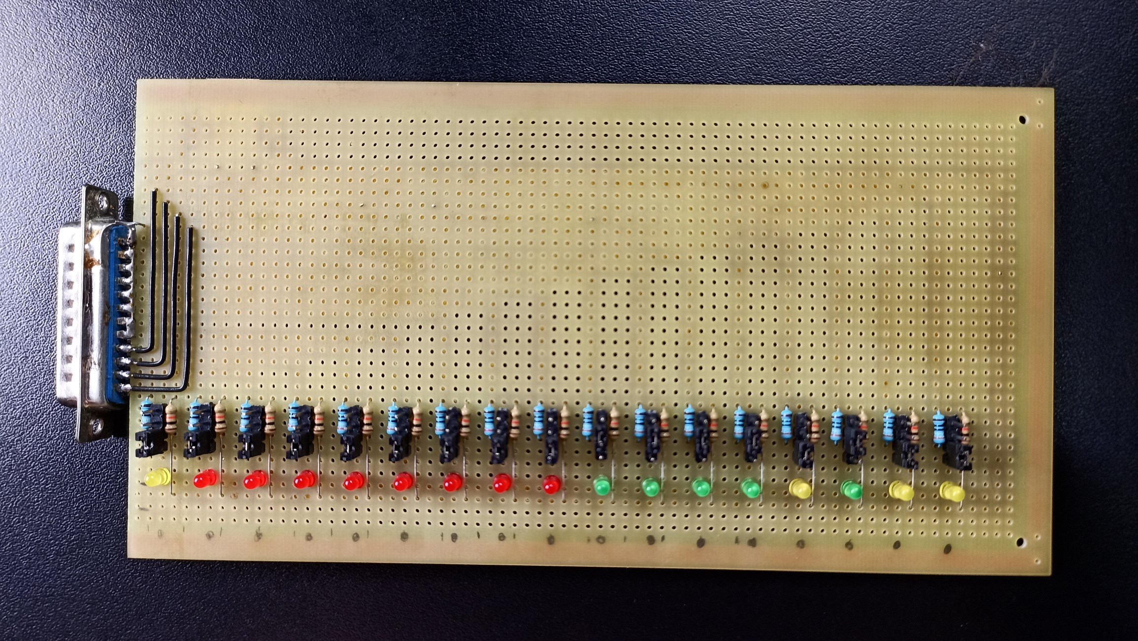

If anyone needs [2] a simple circuit to test parallel port pin by pin as either input or output, this is good solution.
No ICs and no transistors required.
More about here: forum.linuxcnc.org/18-computer/55803-a-s...el-port-tester-board
