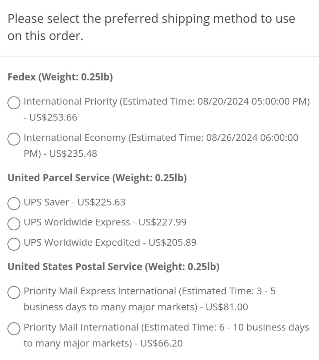

Just to reinforce how messed up this is, the MESA shipping costs for one board to Australia, what an absolute joke:
RIP you cool, clean, compact, integrated Mecanix board.

Just select the cheapest option. Mesa have been known to upgrade to a better service at no cost I 'm not sure if thats normal service or becasuse I am a Good Looking Bloke
