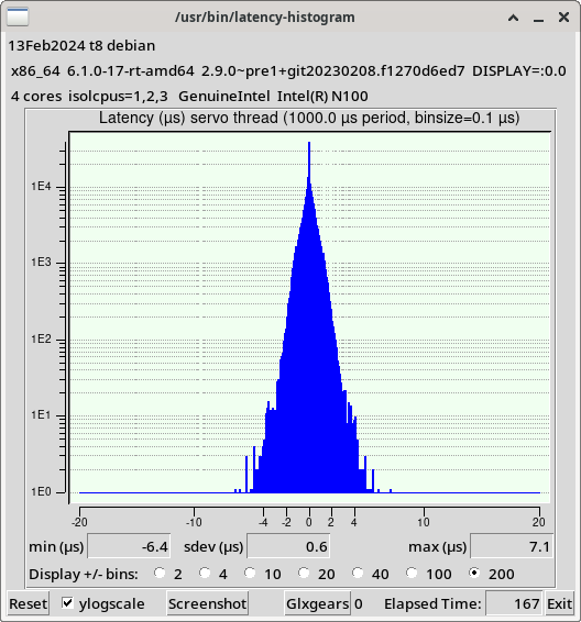

13 Feb 2024 18:58 - 13 Feb 2024 19:12 #293248
by Hakan
Replied by Hakan on topic linuxcnc 2.9.2 (live) on the intel n100 cpu

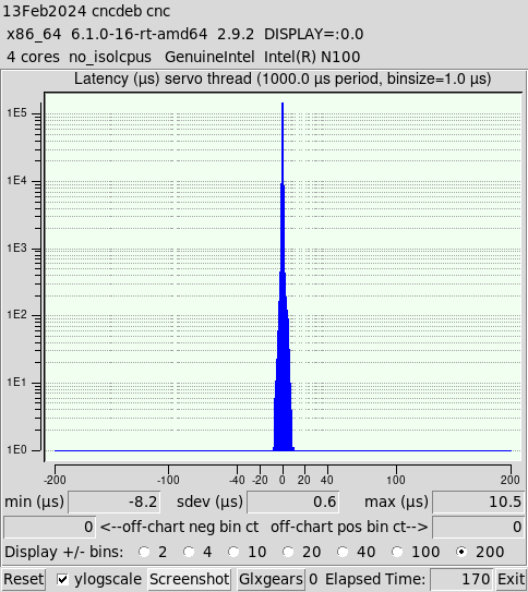

That's not what I get with my N100 Firebat T8 Pro Plus, see below
HT and C-states are disabled.
Link to product, I have the N100 16GB version: aliexpress.com/item/1005005234874016.html
Edit, sorry the N100 doesn't have hyperthreading, confused it with another cpu I was working with.
Last edit: 13 Feb 2024 19:12 by Hakan.

13 Feb 2024 19:25 #293251
by Hakan
What I can spot as different vs gambaf is that I run debian off the internal nvme drive, not the live debian.
The only real modification I have made is to increase the megahertz for the memory, it has got DDR5 memory at 4800 MHz but is set much lower i bios. I have also looked around in bios to reduce turbo and power states, but there are not that many such settings. I might have touched one or two such setting but I can for sure not find back which one. The C-states are disabled for sure, that made a big difference. isolcpus=1,2,3 made a difference as well, it has got four real cores.

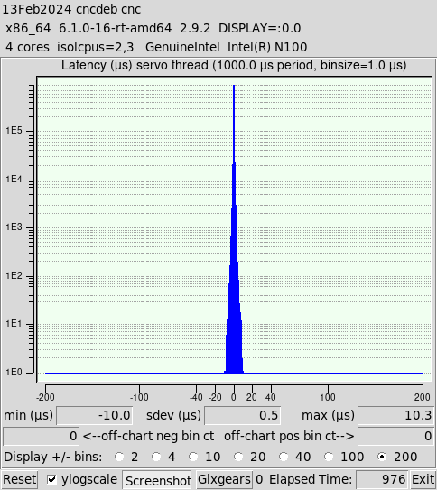

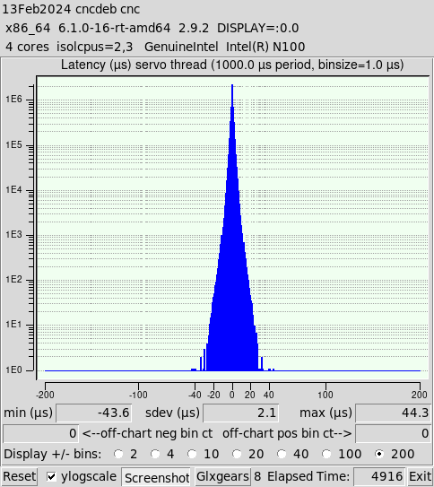

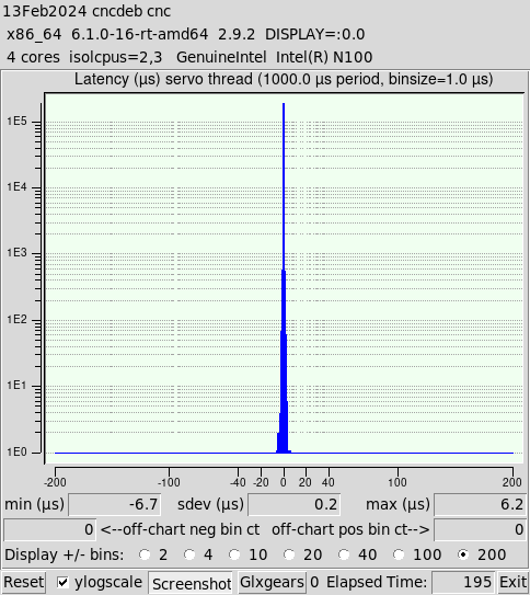

Hakan, could the difference be that you didn't "stress" your machine while testing? And by stress I mean a few glxgears and opening up firefox to play some hd yoututbe in the background.
With all the Intel hate going on here, I'd expect people to compile the kernel in the background with 16 threads, but instead you're letting them off easy with just and idling pc?
I did install linuxcnc on the nvme drive after the initial test on the live version so I could set cpu isolation, which I don't know if you can do on the live version.
When I just launch the histogram without any additional tasks running (glxgears, firefox/youtube), I get similar results to you.
All the tests were done with the following command line as requested:
latency-histogram --nobase --sbinsize 1000 --show
Modified BIOS, under stress, isolated cores:
Modified BIOS, idle, isolated cores:
Default BIOS, isolated, idle:
Default BIOS, not isolation, idle:

13 Feb 2024 22:17 #293271
Replied by tommylight on topic linuxcnc 2.9.2 (live) on the intel n100 cpu
Much better!
There is no off chart excursions anymore on the first picture under load, so attach the Mesa board and start making chips.

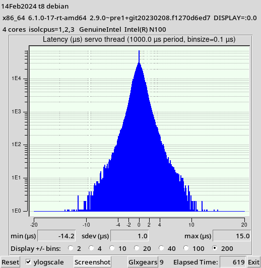

14 Feb 2024 08:00 #293300
by Hakan
This is an unreasonable load for linuxcnc but here we go. 9 glxgears, youtube streaming, recompiling a project with files on a network drive.
Youtube video stutters a bit because of the load, so it is at least a bit loaded.
Still inside +- 15 usecs.
gambaf, you use isolcpus=2,3 so you still can get that sort of delays, use isolcpus=1,2,3
