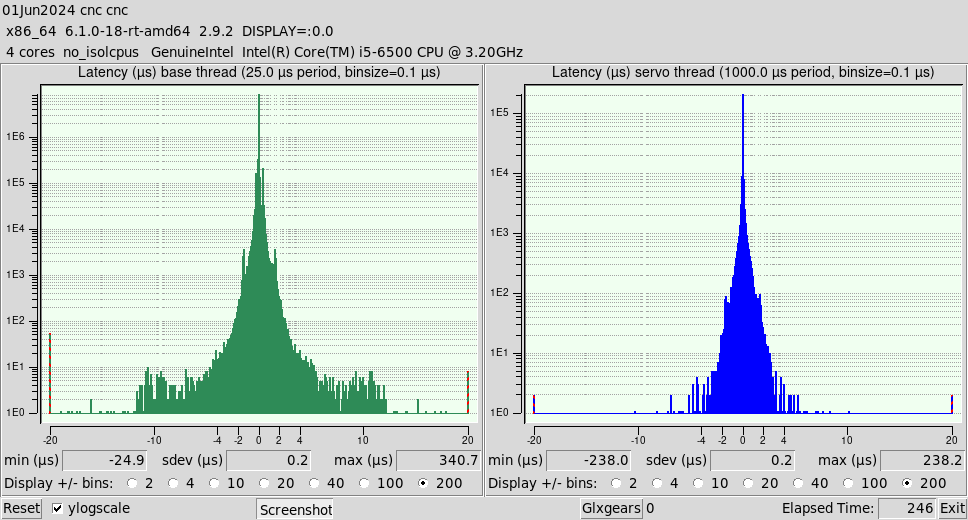

Hello everyone,
I would like to ask for your help in setting up Linux CNC. I have been using Estlcam for my Gantry CNC portal milling machine. Now I would like to improve the machine mechanically and electrically. I have already purchased a new control cabinet. I would like to use Linux CNC as the control system, but I am still having problems starting up. The machine runs with 4x (XYYZ) JMC Closed Loop Stepper 3Nm.
For the control PC I bought a Fujistu Esprimo D756 (i5 6500, 16GB RAM, no graphics card). For Linux I have installed a 254GB SSD and downloaded the finished ISO from the LinuxCNC homepage.
I would like to use the parallel port for the start. If everything runs smoothly and I like the control system, I may switch to a mesa card in the future.
The installation itself went smoothly but I have (from my point of view) very bad latency values. I have attached a picture of the test (BIOS with factory settings)
I tried different configurations in the bios but without any significant improvement. Even the installation of an old graphics card hardly brought any improvement.
What is your opinion? Is the PC completely unsuitable for Linux CNC or is it worth trying other options to optimize the RT?
Can the BIOS settings be exported somehow to display them here in the forum?

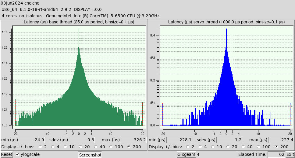

03 Jun 2024 18:50 - 03 Jun 2024 19:21 #302258 by ErwinCNC
Replied by ErwinCNC on topic Bad Latency Fujitsu Esprimo D756 i5 6500
Many thanks for your answers
I have made the following settings in the bios (based on a reset to factory settings)
Active Prozessor Cores ALL
Intel Virtualization Technology Disable
VT-d Disable
Intel TXT Support Disable
Enhanced SpeedStep Disabled
Package C State limit C0 - Which setting should be selected here?
LAN Controller Disabled
Azalia HD Audio Disabled
Launch CSM Enabled
Unfortunately, the values in the latency test have not really changed.

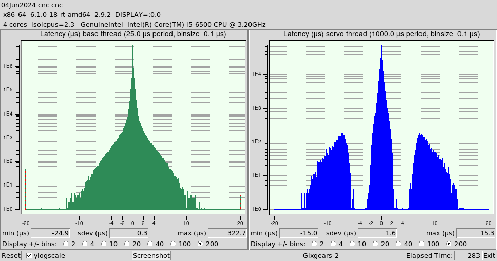

04 Jun 2024 18:44 #302335 by ErwinCNC
Thanks again for your support
The import of the parameters has now worked. The values are also better at the beginning but after a while there are still peaks of 300+
For me there is still one open point before I change the kernel
www.heise.de/select/ct/2016/6/1457861953266796
Something about this is explained here (in German).
If I have understood the article correctly, the selection of C0 = active is correct and the higher the number, the more energy is saved...

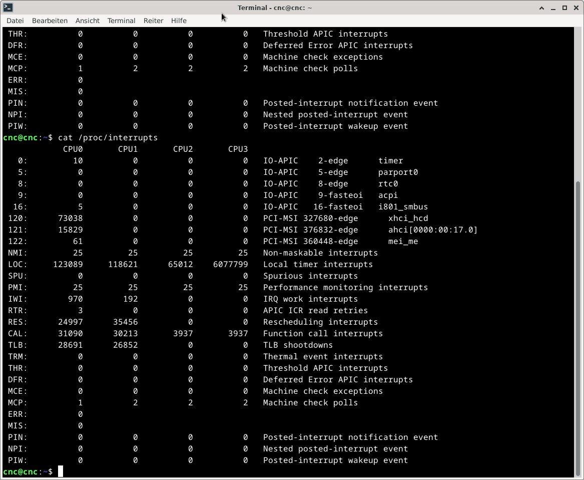

04 Jun 2024 22:33 #302344 by royka
Replied by royka on topic Bad Latency Fujitsu Esprimo D756 i5 6500
That's a big improvement already indeed, if it won't show big latency on the servo thread like this with "latency-histogram --nobase" it should be good for use with Mesa.
After such a big latency you can check "cat /proc/interrupts" to see if there is a device causing a latency on the isolated CPU.
Max c-state should be 0 indeed which means fully active, already set as kernel parameter, but might help if you still set it already in the BIOS.

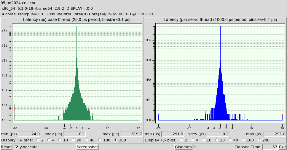

05 Jun 2024 16:57 #302395 by ErwinCNC
Unfortunately, a longer runtime has also shown that the servo thread has poor latency.
I have displayed the interrupts, but I cannot interpret the displayed values.
Maybe performance monitoring interrupts and machine check polls?
I have no doubts about the kernels, it's more a question of knowing how to update/change them.
I would like to use the parallel port for the first tests. In case I don't like the software after all.
