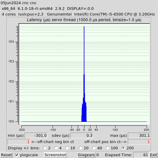

Replied by tommylight on topic Bad Latency Fujitsu Esprimo D756 i5 6500
Run the latency histogram with this
latency-histogram --nobase --sbinsize 1000 --show
Post a screenshot.

05 Jun 2024 20:04 #302410
by ErwinCNC
Replied by ErwinCNC on topic Bad Latency Fujitsu Esprimo D756 i5 6500
- ErwinCNC

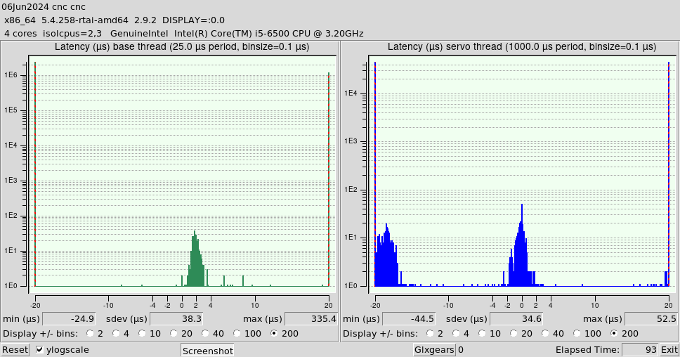

05 Jun 2024 20:17 - 05 Jun 2024 20:27 #302411
by ErwinCNC
Thanks for the instructions, the kernel update worked. Unfortunately the latency is still bad. In the new kernel, the WLAN stick no longer seems to work, so here is a photo via smartphone.

- Posts: 21913
- Thank you received: 7466
05 Jun 2024 20:36 #302414
Sorry, you did not mention it is for parallel port lately, i now recall you did that on the first post.
In that case try installing the RTAI kernel, should be better for parallel port.

06 Jun 2024 20:14 - 06 Jun 2024 20:26 #302485
by ErwinCNC
Hello everyone,
thank you very much for your continued help
In the next step I would like to try to set up the RTAI kernel.

- Posts: 21913
06 Jun 2024 20:41 #302489
Hmmmmm....
I think it is time to do a fresh install from the 2.9.2 ISO and just installing the RTAI kernel and corresponding LinuxCNC.
You can probably install the kernel and LinuxCNC by just removing the existing LinuxCNC-uspace and installing with

- Posts: 18085
- Thank you received: 5320
06 Jun 2024 21:42 #302492
Replied by PCW on topic Bad Latency Fujitsu Esprimo D756 i5 6500
Since Preempt-RT and RTAI are about equally bad,
I would more expect an issue with the BIOs, power
management etc.
management etc.
- Posts: 21913
06 Jun 2024 22:48 #302496
I agree, but the fact there are still RT settings active, granted another chance.Since Preempt-RT and RTAI are about equally bad,
management etc.
