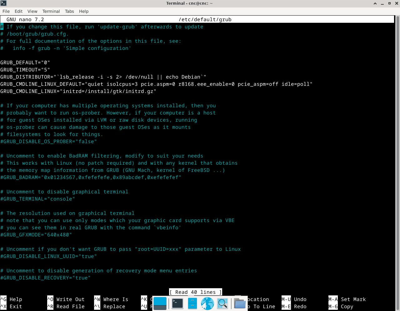

14 Nov 2024 16:01 #314461
by greg23_78
Replied by greg23_78 on topic Solution fo "hm2 error finishing read" with no good PC
the command return to me :
cnc@cnc:~$ cat /proc/cmdline
BOOT_IMAGE=/boot/vmlinuz-6.1.0-23-rt-amd64 root=UUID=9ccb36b6-0014-43a8-b35e-c8724d432dac ro initrd=/install/gtk/initrd.gz quiet isolcpus=3 pcie.aspm=0 r8168.eee_enable=0 pcie_aspm=off idle=poll

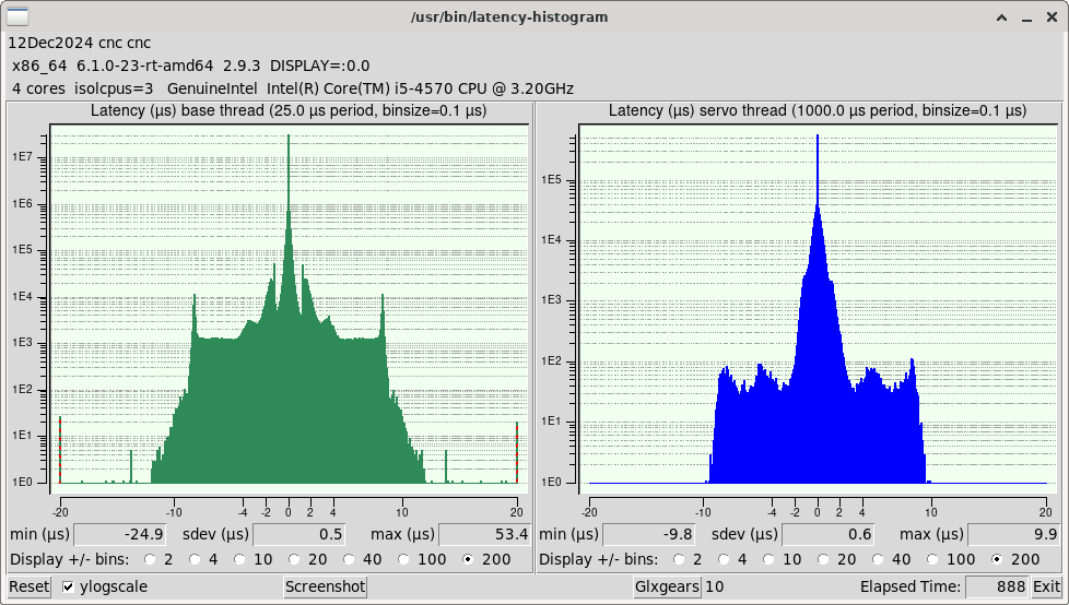

12 Dec 2024 15:40 - 12 Dec 2024 16:02 #316525
by greg23_78
I need your help because I'm completely lost.
as at the beginning of this topic, i had an “hm2 error finishing read” problem.
i took the pc to feed a 7i96s i never have the “finishing read” problem.
i bought a new computer with much better latency and constant ping.
I plug in my lathe and it displays “hm2 error finishing read” all time when i ask change tool on my turret and somethime when i enable the drive (F2)...
before :
it used to work fine but now the turret runs for 1 second with this error... and I haven't changed a thing since.
below is the histogram of the new pc
before :
Last edit: 12 Dec 2024 16:02 by greg23_78.

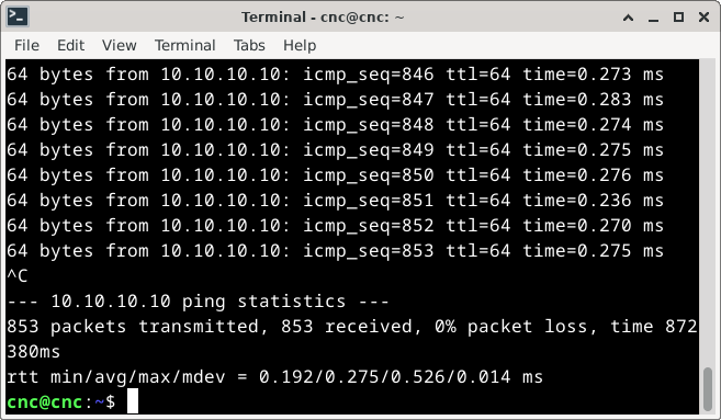

12 Dec 2024 16:36 #316527
Replied by PCW on topic Solution fo "hm2 error finishing read" with no good PC
If you only get the error when enabling some motion it may be an EMI issue
Is the 7I96S's frame ground connected to chassis ground?
Also can you report the result of:
sudo chrt 99 ping -i .001 -q -c 60000 10.10.10.10
( This assumes the card IP address is 10.10.10.10 )
The test will take 1 minute
