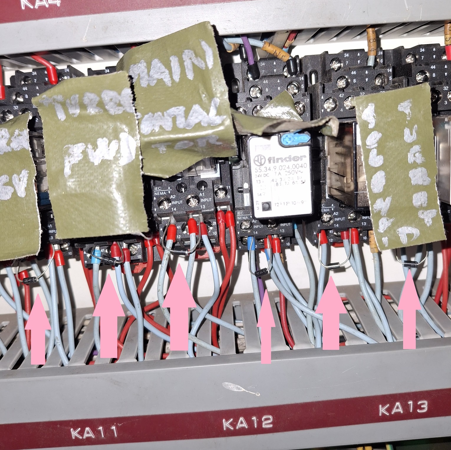

Replied by PCW on topic Solution fo "hm2 error finishing read" with no good PC
Do all inductive loads switched by the 7I97T have flyback diodes?
Did you verify that IRQ coalescing is disabled?

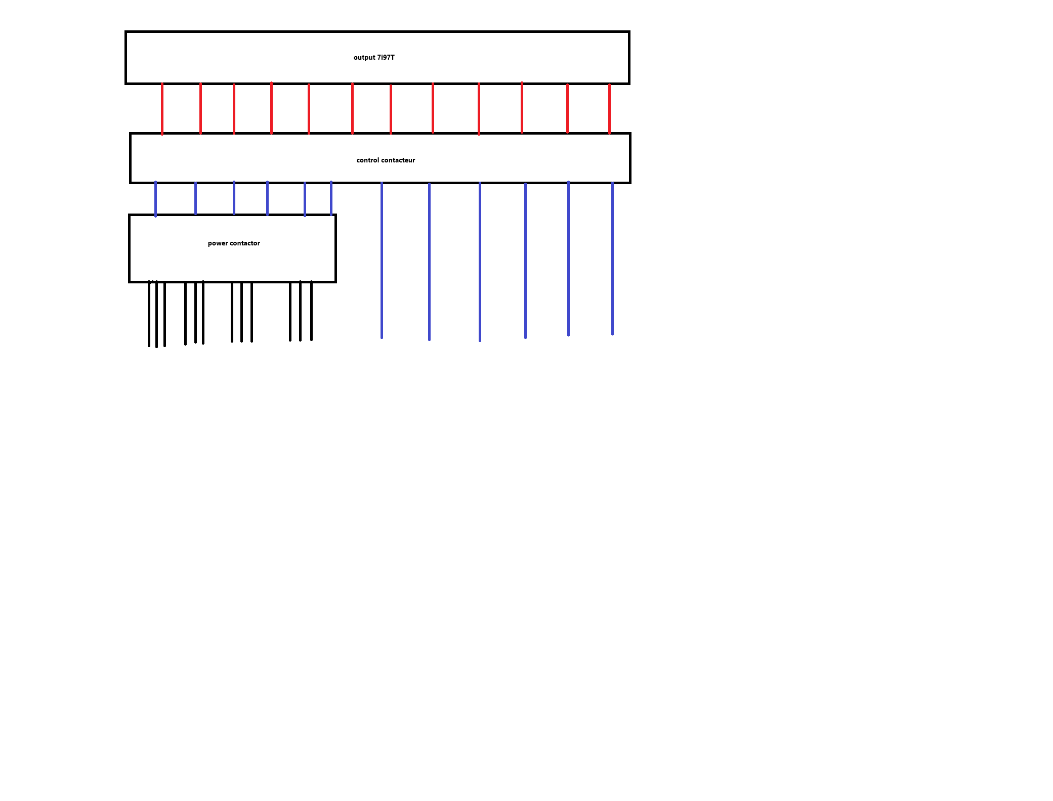

I think I know where the problem is.
for a start, i hadn't fitted a free-wheeling diode.
i've just put diodes on all my control contactors.
i've tried again and i have the impression that it's got worse because when i launch linuxcnc and deactivate the e-stop (F1), the message appears more regularly.
I try to control my chip conveyor, the message appears.
i try to drive my tailstock, the message doesn't appear ...
I realize that the commands that cause error messages are those driven by power contactors.
However, all my power contactors are controlled by command contactors.
sinking output:
drive with power contactor
e-stop / fwd turret / rev turret / convoyor fwd / convoyor rev
pilot with control contactor
tailstock output / tailstock input / enable drive / spindle fwd / spindle rev
I've never had a problem with controls driven by control contactors alone.
the video shows when i manually activate (with the control contactor) my turret. only the card is activated, the computer is not powered so linuxcnc doesn't work.
on the video i activate the contactor three times and 2/3 error and 1/3 no error
how can my power contactors disrupt the 7i97T card?
