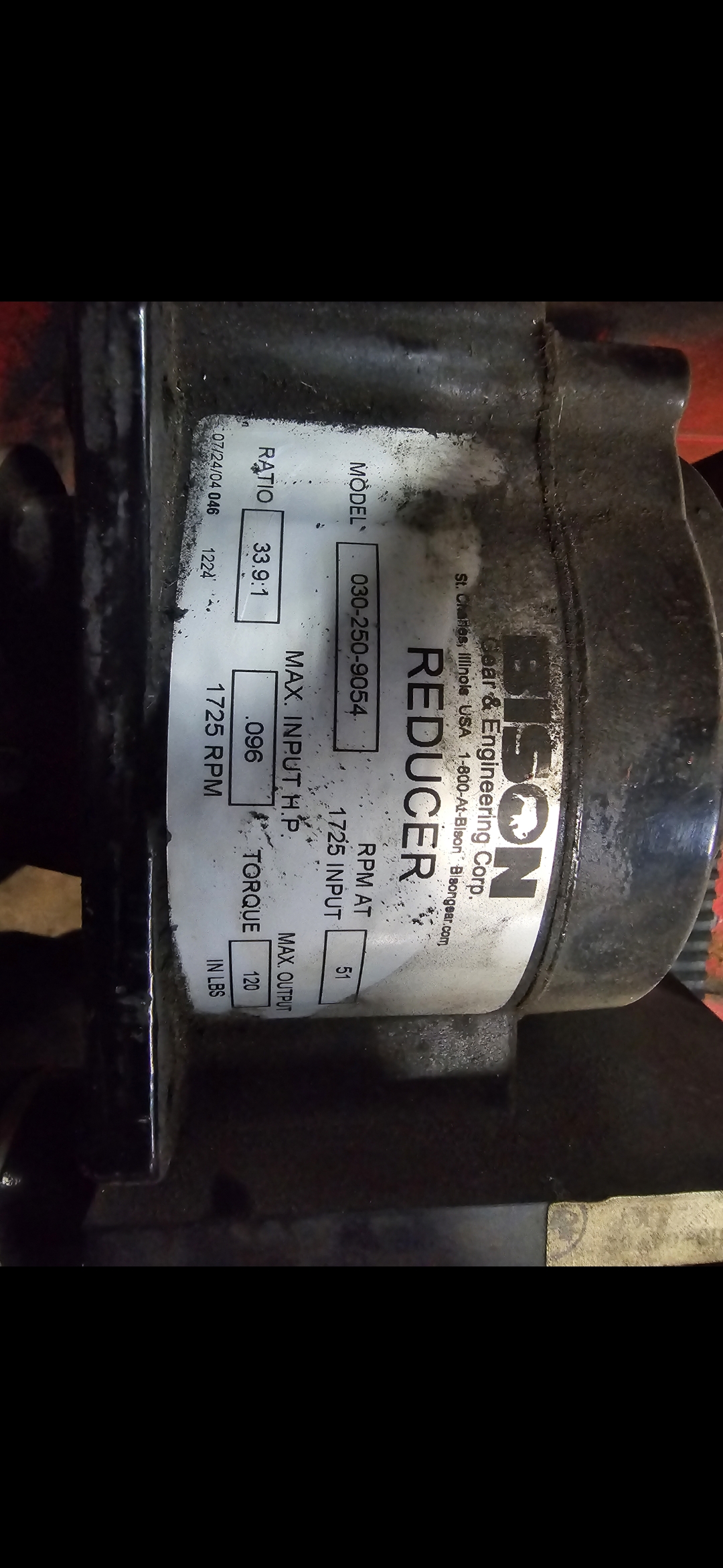

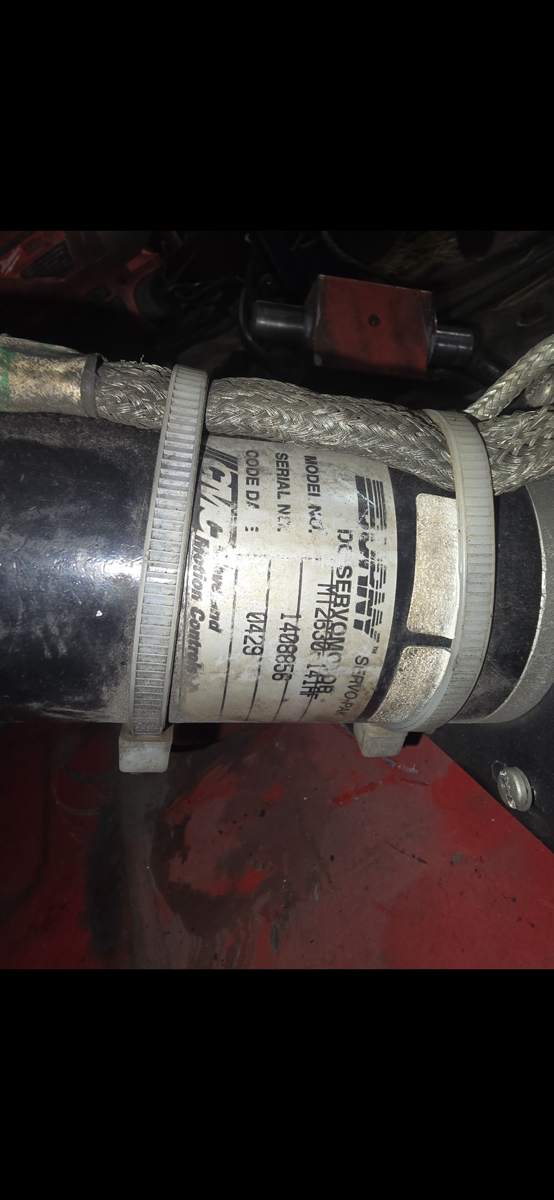

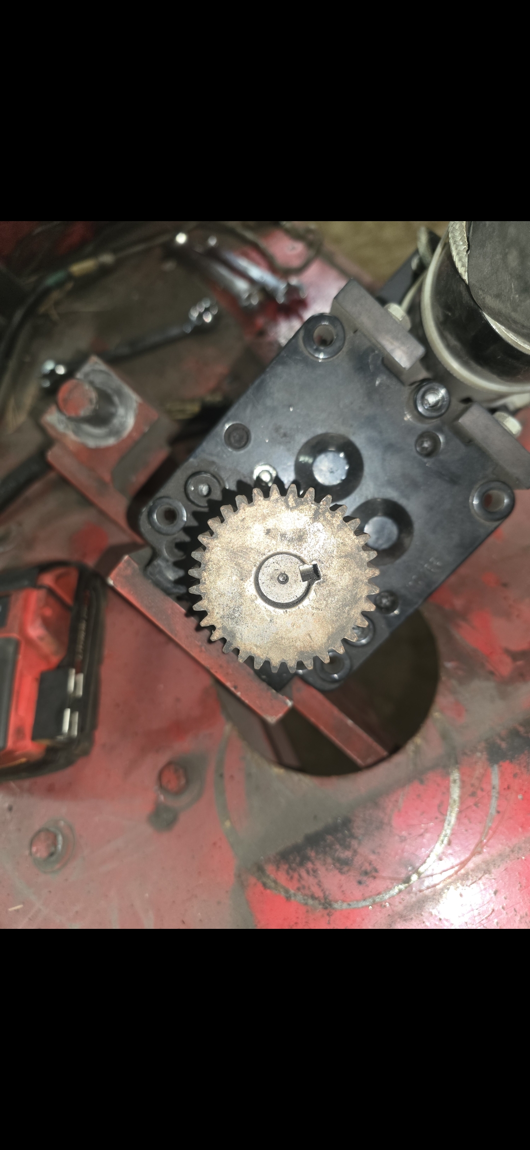

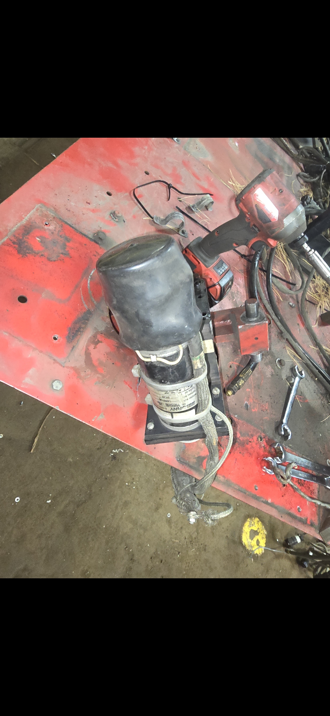

Hello I am retrofitting this old mg industries 10.5x25 cnc table. It was previously controlled by burny 10 lcd I am looking to update it to linux cnc. What would be the best direction to go with this? My motors seem to be very old is there any chance of reusing them or is it not worth the effort? I included photos of the motors below and the gear boxes they are tied to.
- Posts: 22002
- Thank you received: 7488
31 Oct 2024 13:52 #313533
Replied by tommylight on topic 10.5 x 25 cnc plasma table retrofit
Do you also have the drives ?

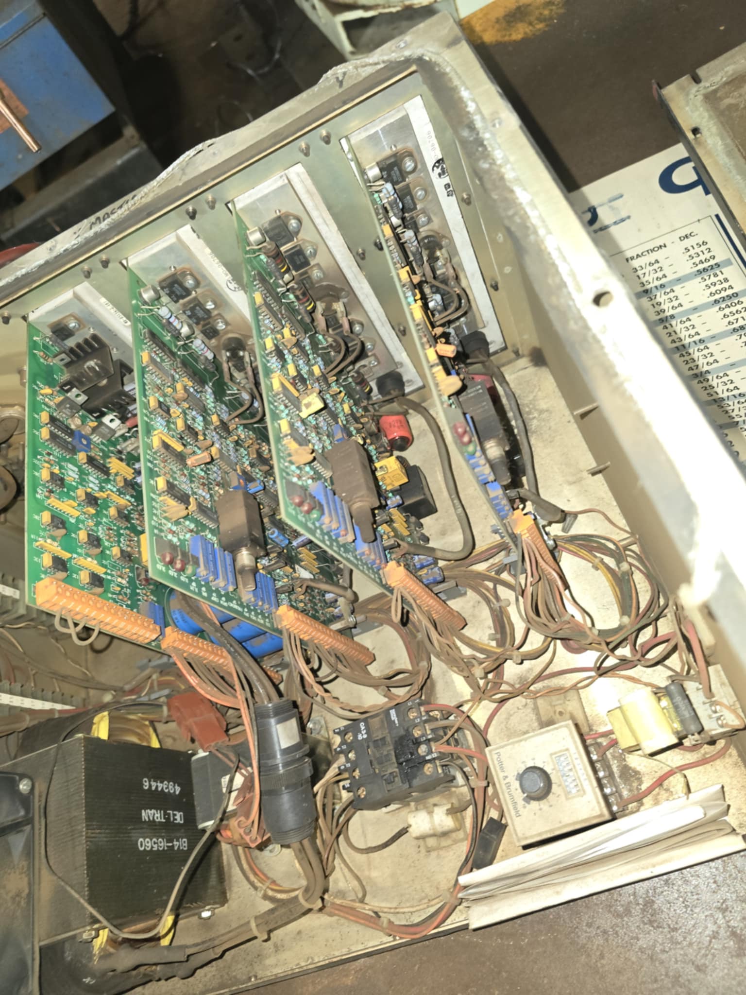

I think this box right here is what would be the "drivers" I will include some photos of the other boxes that were mounted on the gantry. Alot of stuff was already unplugged and I felt like it did not make sense to have 500 lbs of boxes mounted on the gantry so I went right ahead to taking them all off. The only one that I really see having to stay on the gantry itself would be there is a box for the plasma torch High frequency start and maybe a box that contains all of the drivers to minimize the amount of wire to run threw a cable chain. Do you still think it's worth it to diagnose these motors and drivers or better to start fresh? I'm willing to spend up to a few thousand on motion control if it's what it needs. And can make my own gear boxes in my machine shop or purchase off the shelf if those reducers won't work.

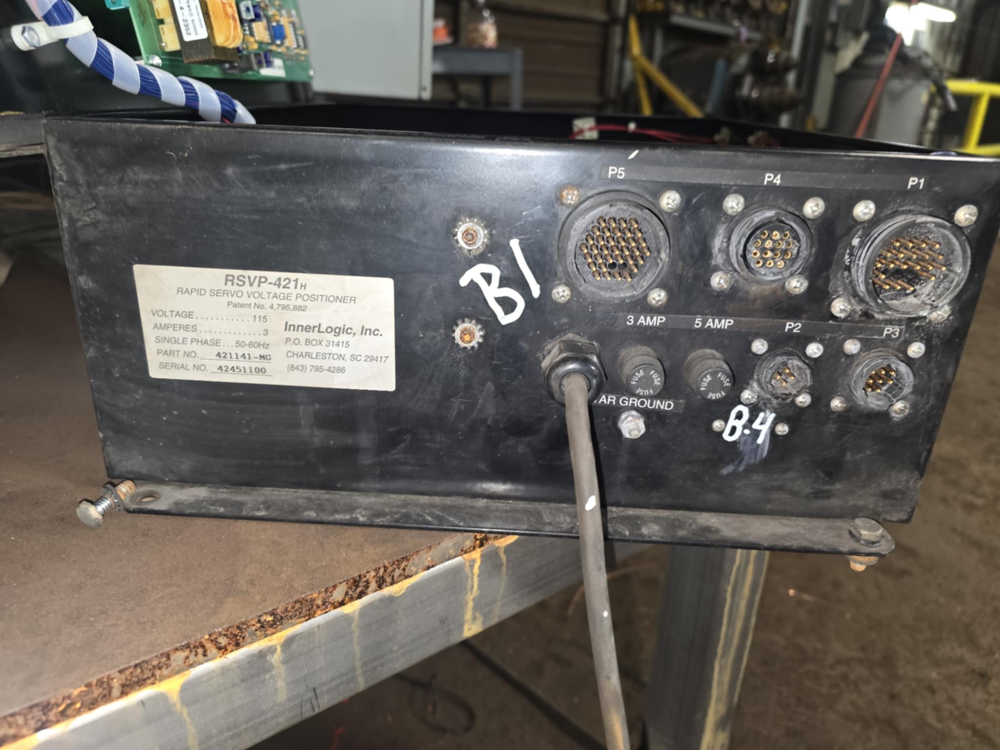

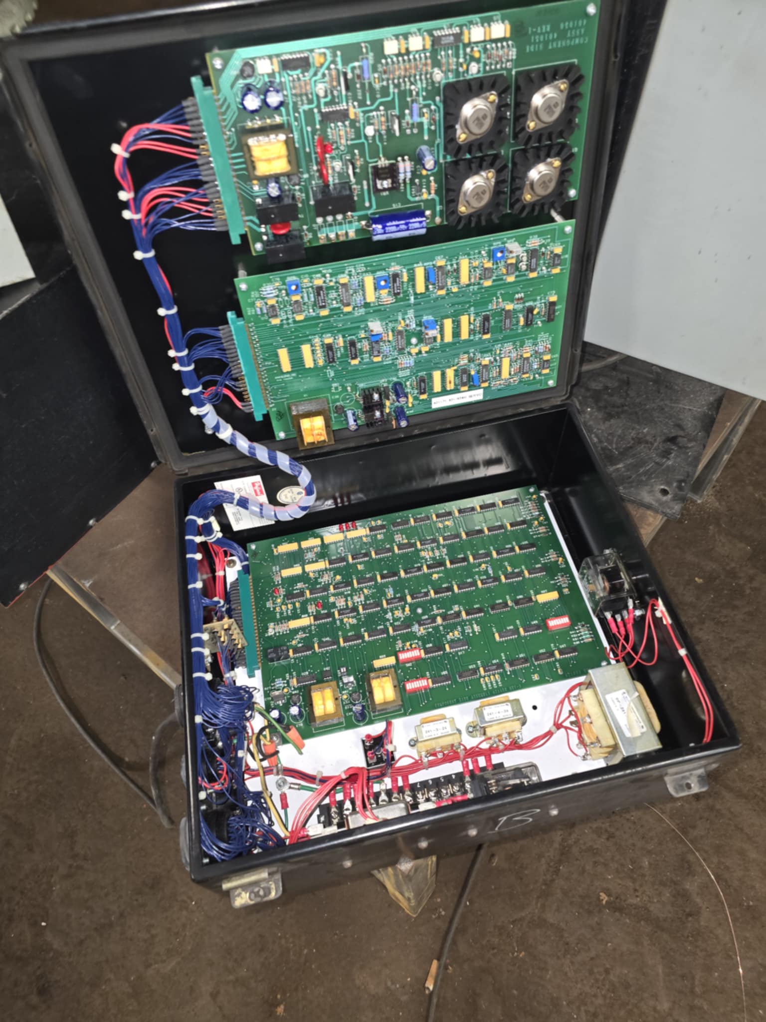

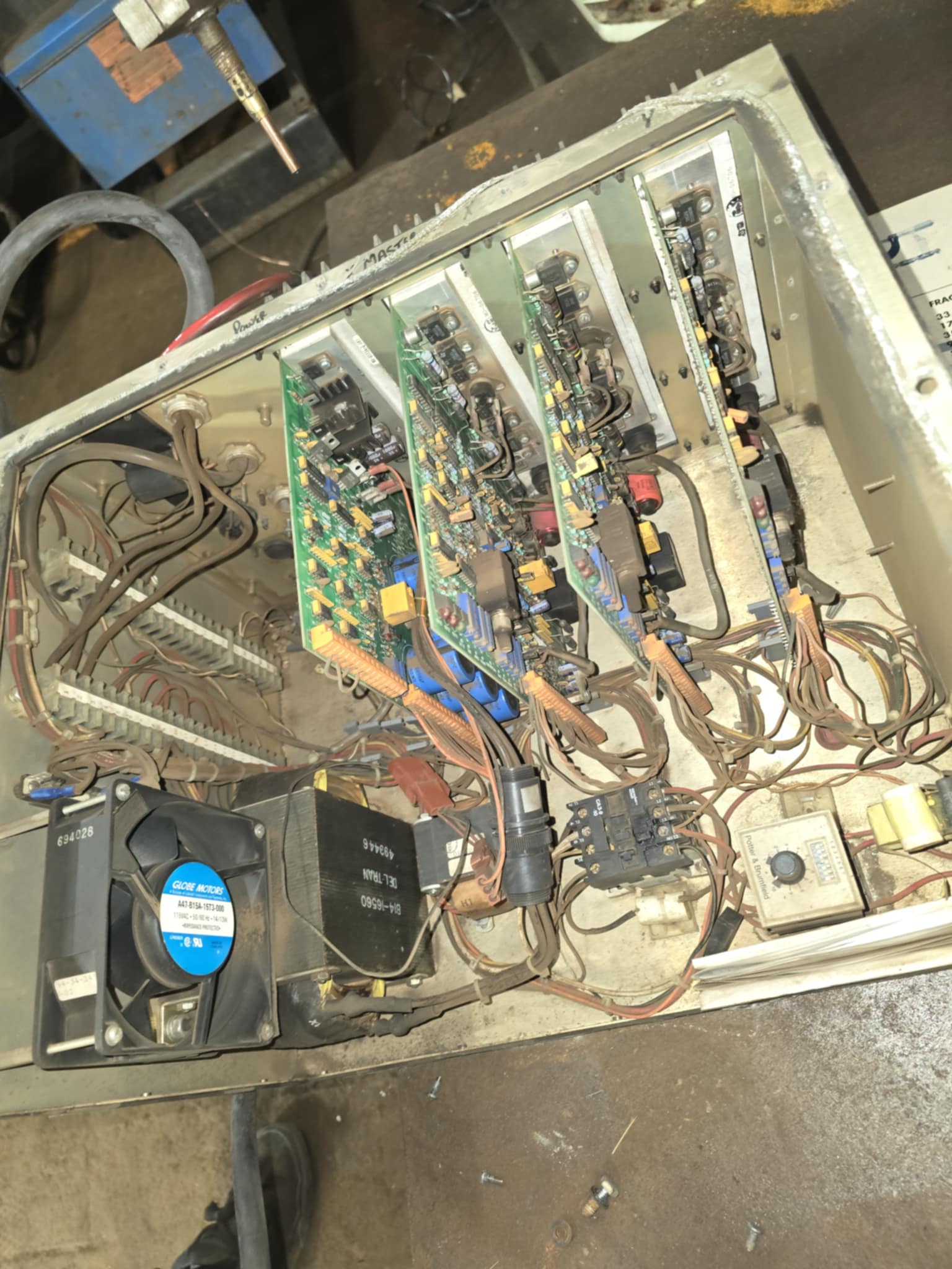

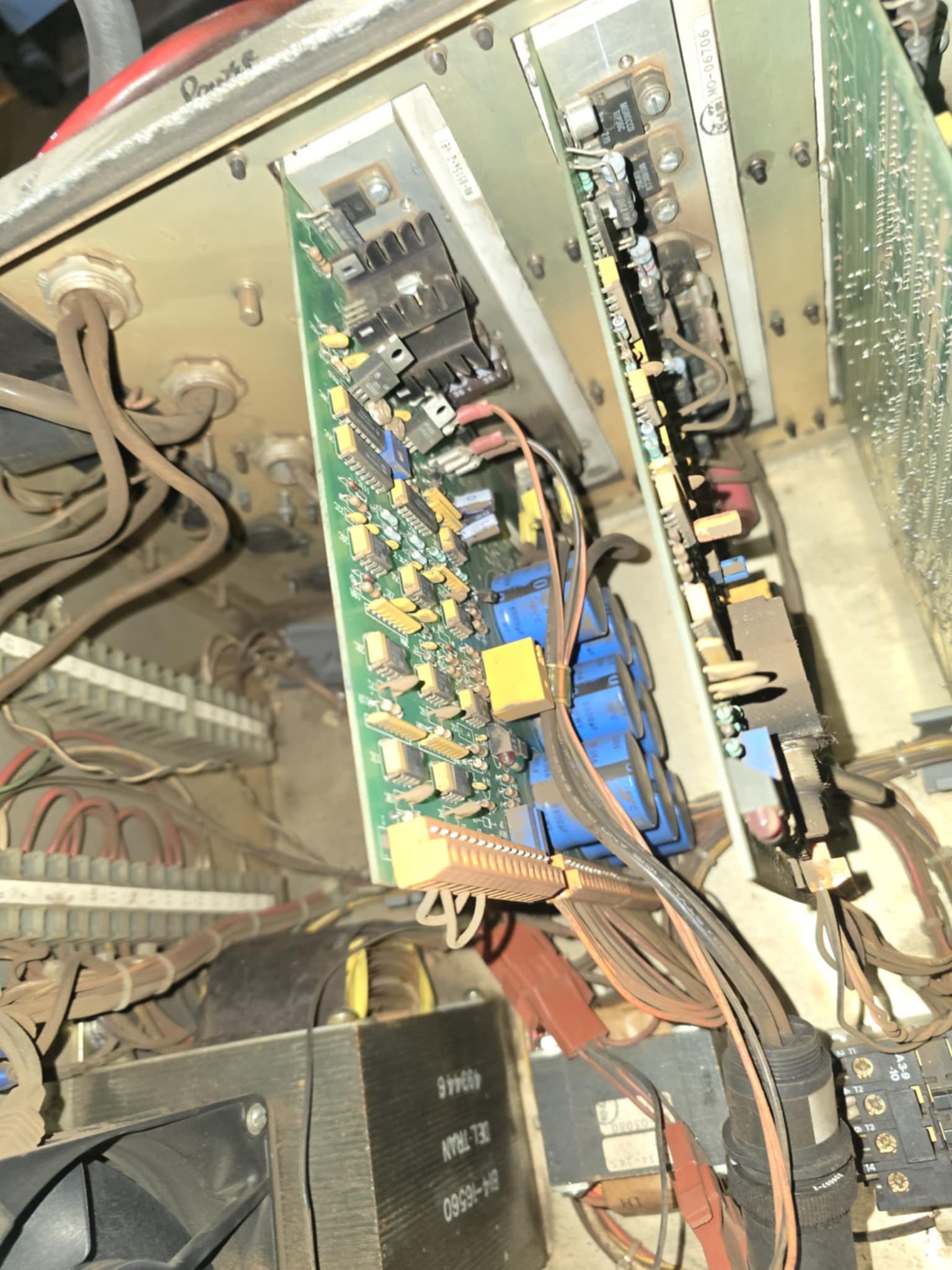

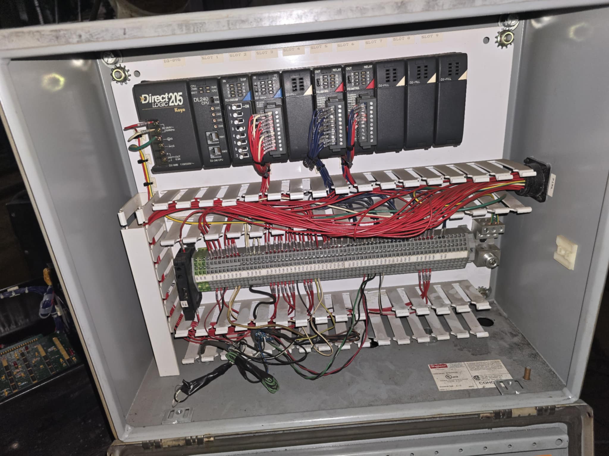

31 Oct 2024 23:37 #313558
First picture, the black servo positioning something or another is what we today call THC, and all that (but much faster) today fits in half a cigarette box!
I would get rid of this so fast....
The attached picture with 4 boards, the left one is the power supply for the next 3, those 3 are the servo drives with lots of electronics, so i would really try to save this, do not worry about the broken encoder connectors, encoders should now be wired to Mesa board.
The box with PLC, i would also get rid of this, fast, all that is now done in software and through a Mesa board.
I would suggest getting a Mesa 7i96S with 7i85 and 7i83 and THCAD for now as this will be good for analog (existing drives) and new drives with analog or step/dir controls.
There are cheaper combos or single board solutions like Mesa 7i97T that everything for analog servos and encoder feedback, or 7i92TM with 7i77 that is the same things functionally.
For new dives with no feedback to LinuxCNC, 7i96S should be enough and you can add 7i85 for encoder feedback at any time later, or single board solution with encoder feedback = Mesa 7i95

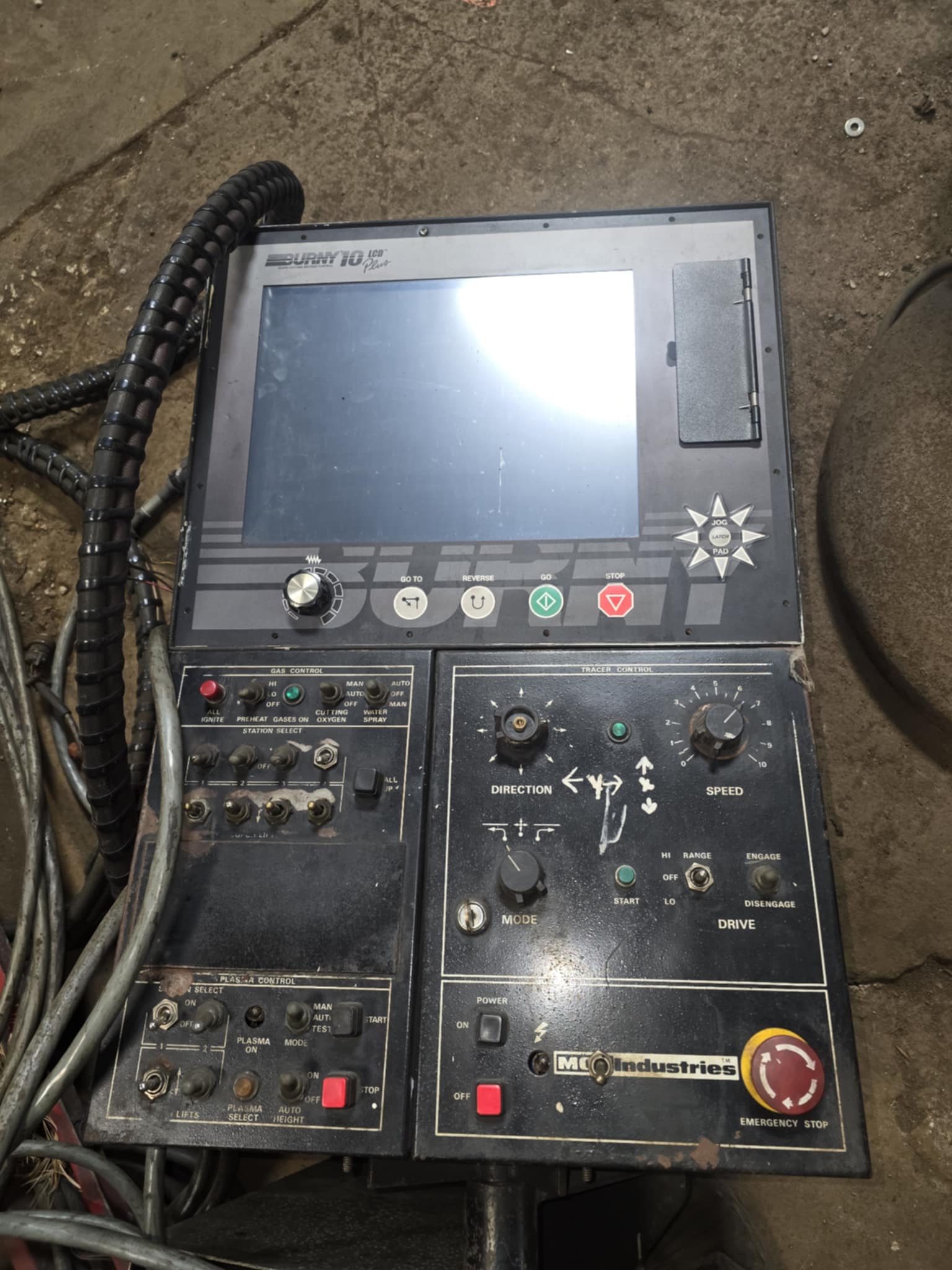

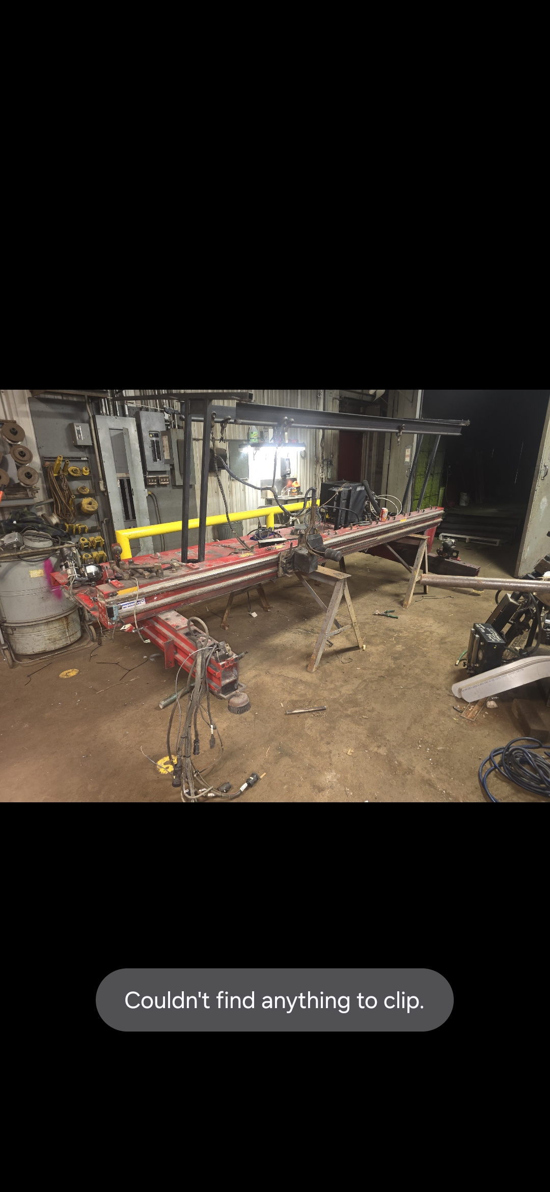

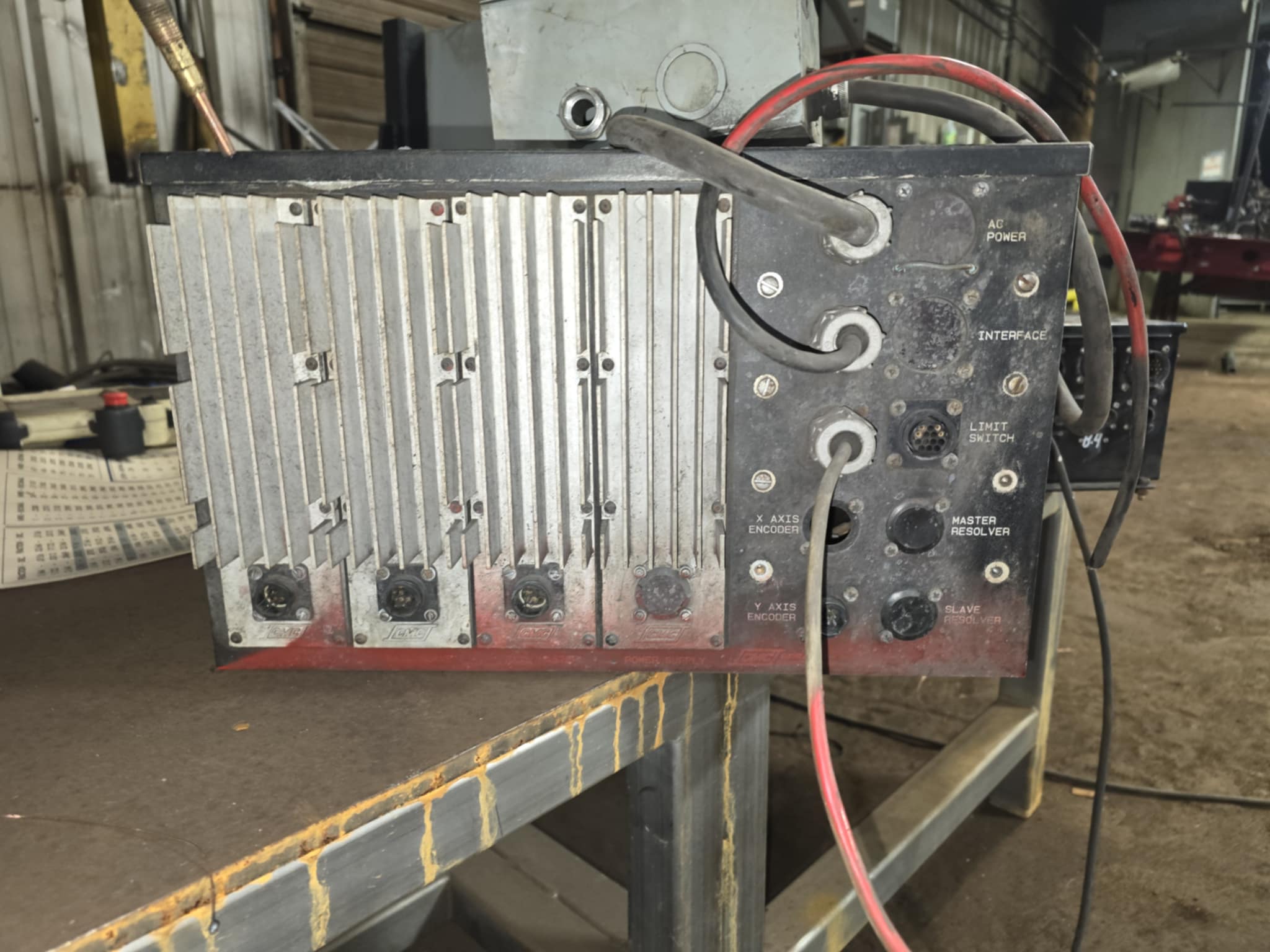

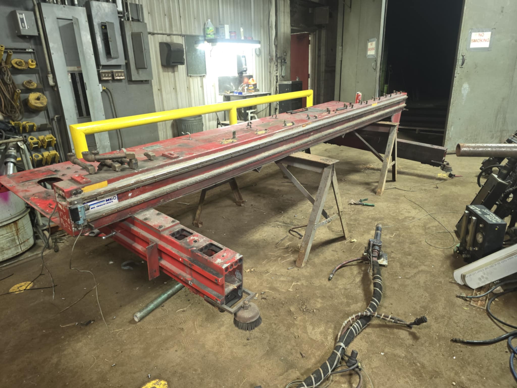

01 Nov 2024 00:46 #313561
by tcbmetalworks
Replied by tcbmetalworks on topic 10.5 x 25 cnc plasma table retrofit
I think that one of the 3 drives is for the slave axis on the Y. I don't know where the Z drive is hiding I'm assuming in the RSVP box or in the controller I included a photo of below. Do you think it's still worth it to reuse the motors and drives? I also included a photo of today's work on the machine I got it all stripped down. It still is a heavy gantry I have yet to weigh it to size motors but I Would guess when all put backtogerher 500+ lbs.
- Posts: 22002
01 Nov 2024 03:04 #313567
Z axis is in the rapid servo positioner box, aka the old THC, so that would need replacing, a cheap stepper drive and motor should do just fine.
