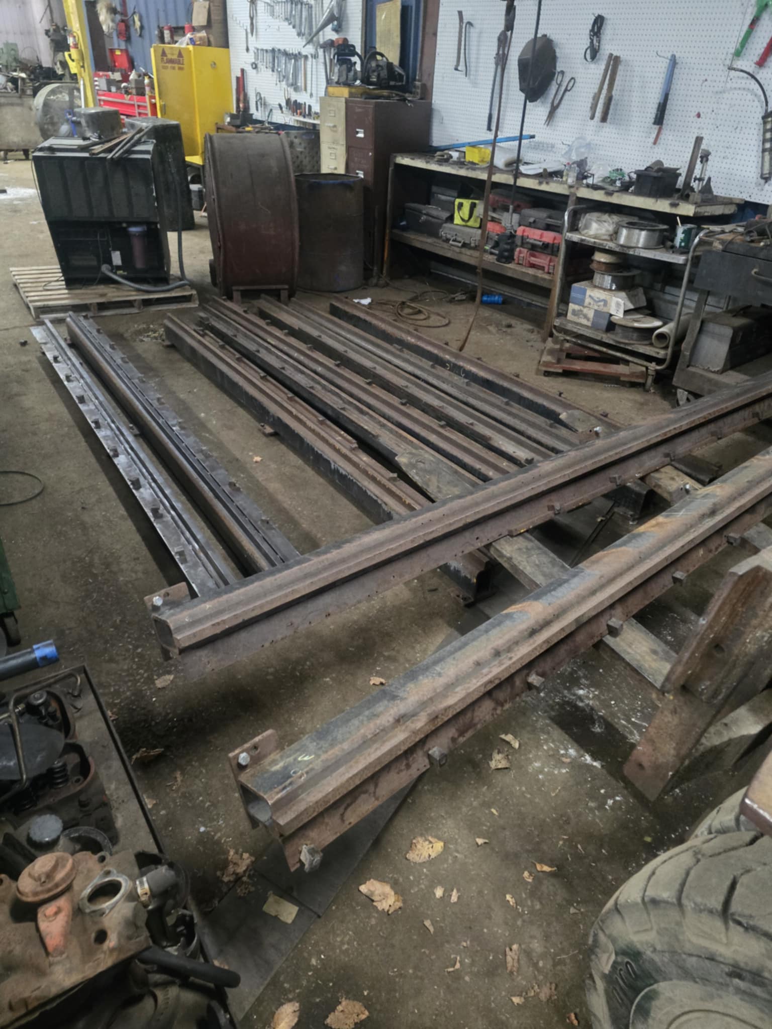

So your recommending the mesa 7i96s a 7i85 and a 7i83 and THCAD and I could use the stock motors see if they work with this combonation of cards then upgrade down the line if I decide I want better performance. Would this combo of cards support large servo motors and offer great motion control? I included a photo below of the rails turns out I actually have enough to make a 50 foot long cnc. I don't think I will ever need to cut 10 sheets In one go but i was thinking of making 25 foot a water table and keep the other 25 foot to plasma cut beams and maybe a large rotory axis. May aswell set it up am I right?

Replied by tommylight on topic 10.5 x 25 cnc plasma table retrofit
Yes, yes and oh yes!
I like your idea of the combo, go for it.

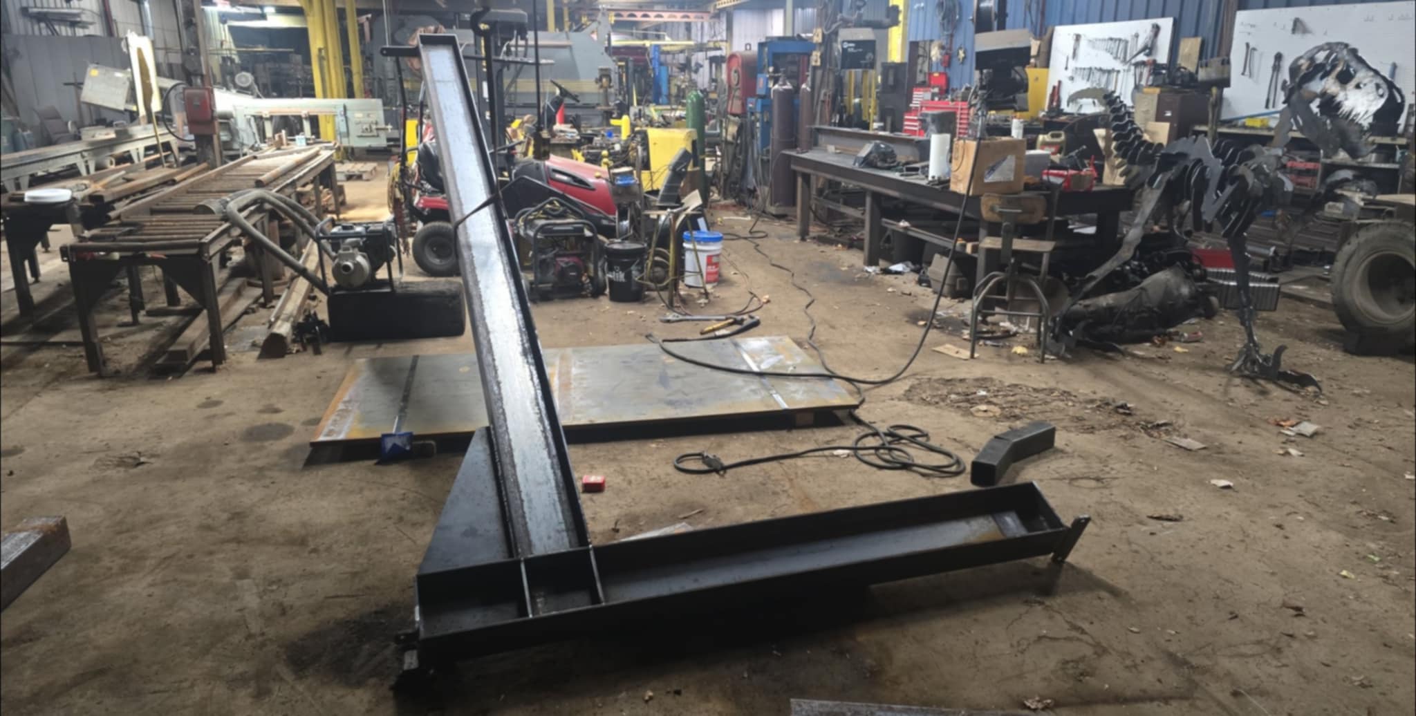

Not much progress made on plasma table today but started welding up a horizontal sheet metal rack based on lazer bros plans. I've been storing verticaly and it's a pain and dangerous to set the sheets down on the table like that. I've had my guy cleaning the rails on the plasma table using a wire wheel then when I set them all up going to try to stone any high spots. Do you know of any good literature to study up on for setting up these gantry style tables? Specificly in keeping the rails parallel and level. I'm sure there's tricks with lasers and string bobs etc.
Check under the gantry, one side has side bearings, the other does not, so the side with side bearings - use a laser to get properly straight.
The other side can be 1-2mm off and still very usable as the THC will compensate that easily.
Mind the part where two rails touch, try to get those as leveled as possible, when gantry moves over them, there should be no noticeable "jump".
