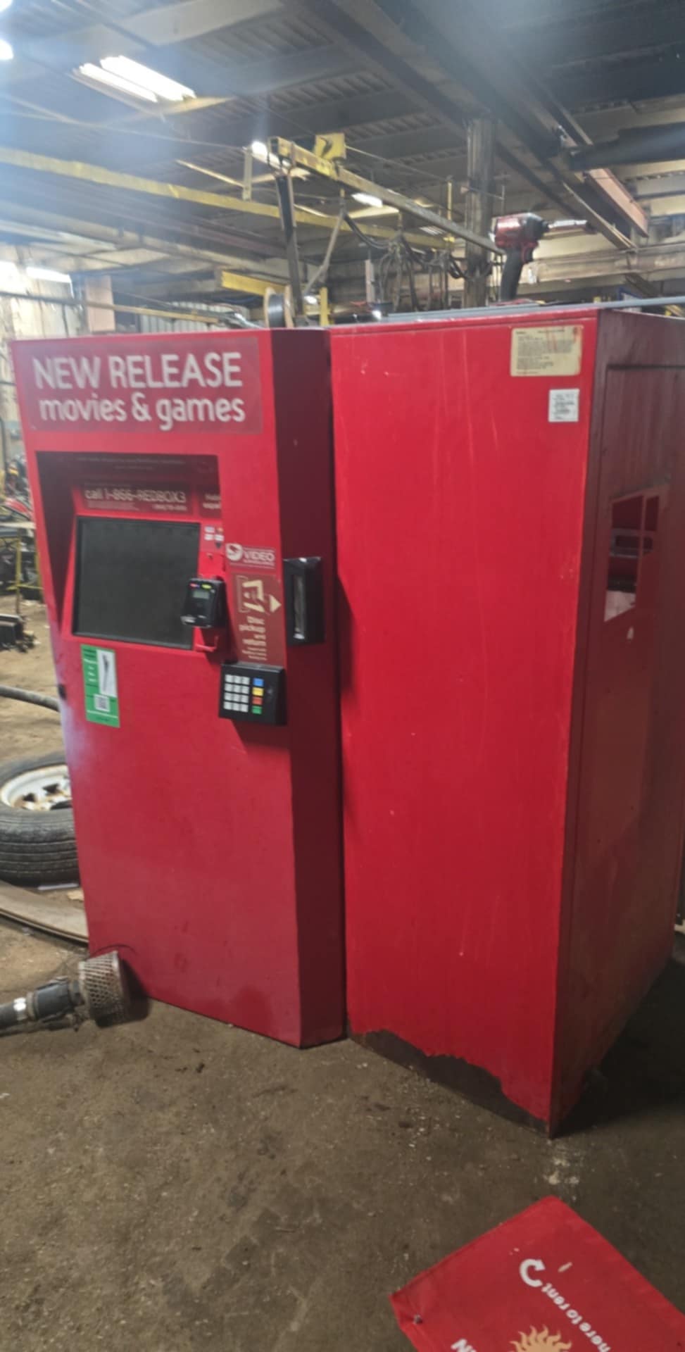

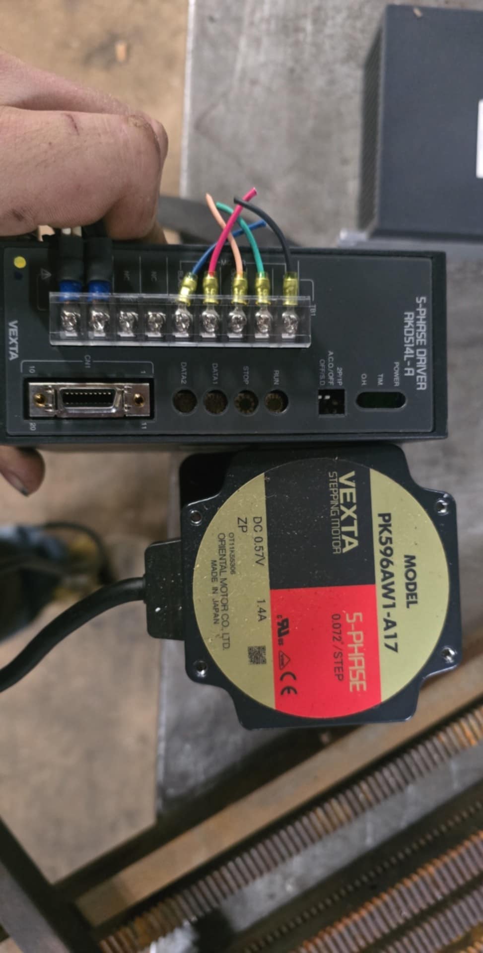

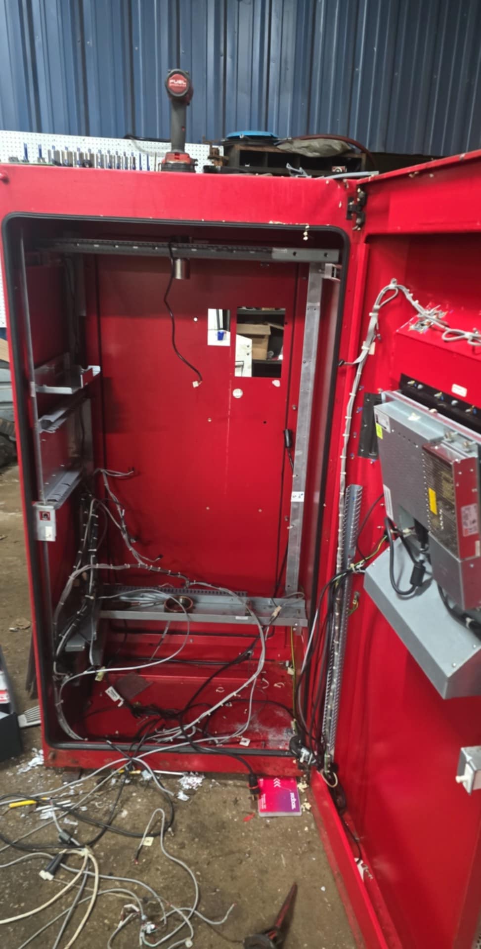

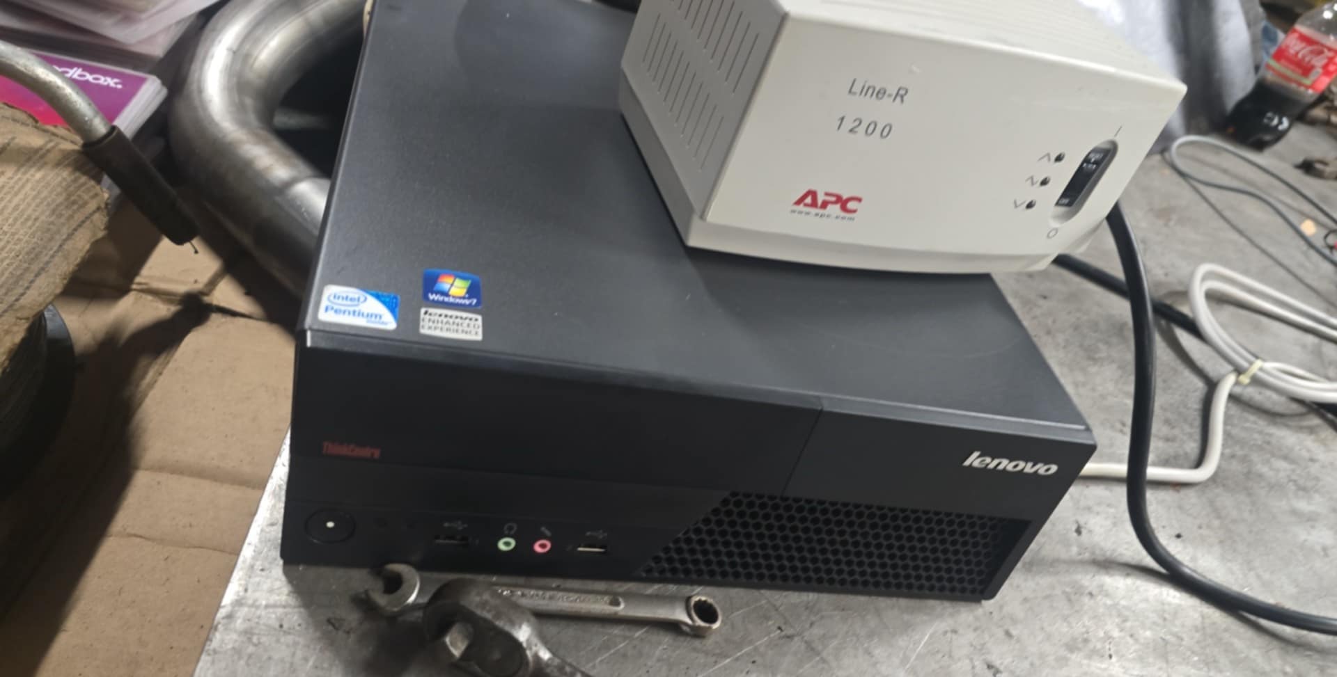

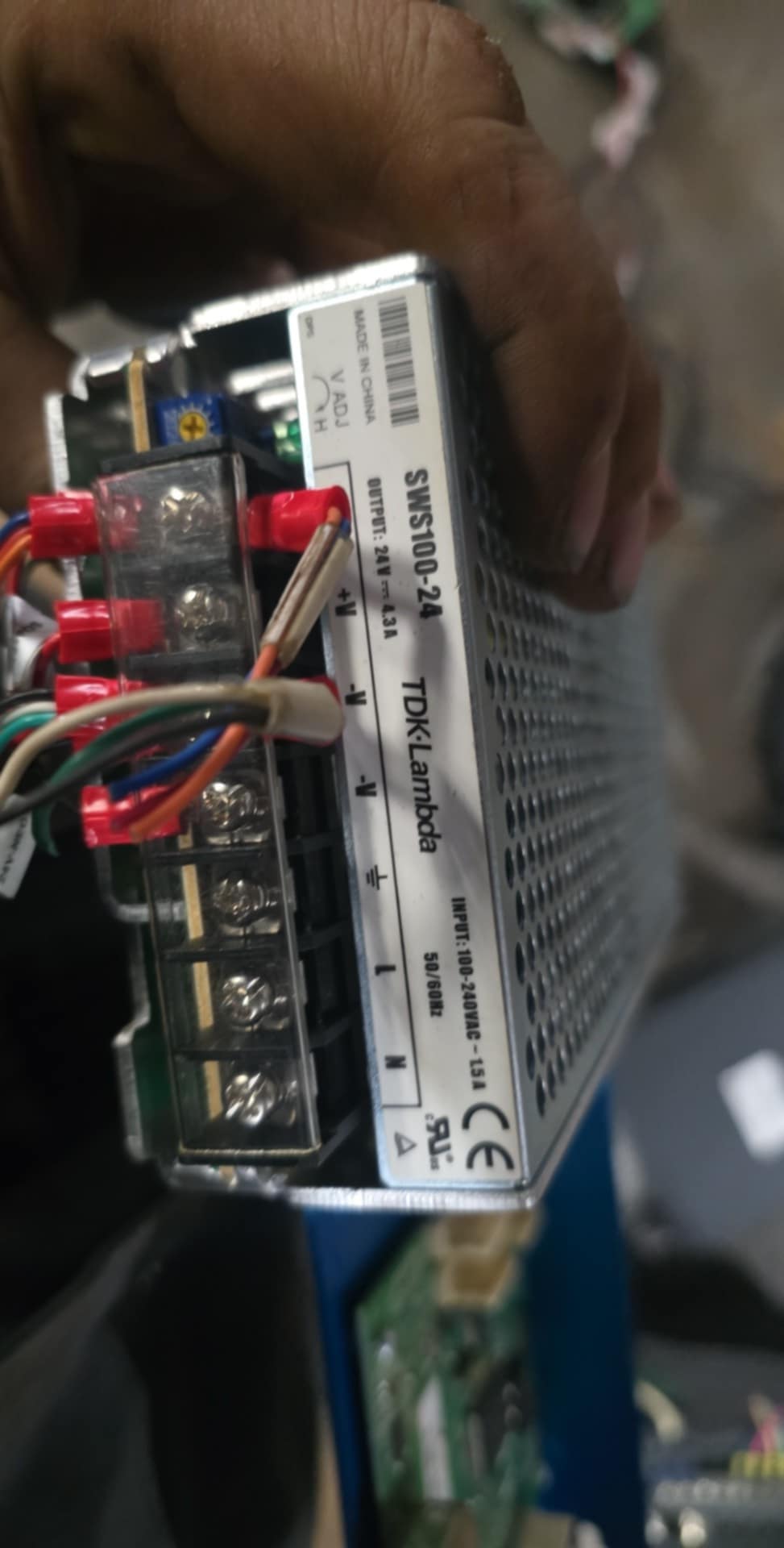

Little update to the cnc plasma.
Red box DVD rental is going out of service and I was able to grab one from infront of a dollar general. Talked to the managers and they said go right ahead. My plan is to use the redbox for the enclosure aswell as it came with tons of components. It has a industrial grade touch screen computer monitor. A lenovo windows 7 pc. Do you think this computer would be a good Canidate to install Linux on? Some 5 wire stepper motors. A 24v power supply. About 4 foot of high quality linear rail. Infrared camera. A nice apc unit. What are your thoughts on all of this? What do you think of the 5 wire stepper and driver? Any chance of easily controlling them? It also has a 110v heater and a ac unit. I don't think I will use either of them except for the fan on the ac unit but might be a good idea. My shop has many holes in the roof literally a water fall and in the winter it gets about 45 degrees. To expensive to heat it more.

17 Nov 2024 13:49 #314663
Replied by tommylight on topic 10.5 x 25 cnc plasma table retrofit
Case is very nice, PC should be good (i have a similar looking one, works perfectly for Mesa), 5 phase steppers are nice as they vibrate less but also have less torque and yours seem to be the 5000 step per revolution ones!!! Damn, those are nice for some precise stuff. Vexta should be easy to find info on them, although lately google is failing miserably to find anything.
Power supply should do just fine, just do not expect record braking speed.
