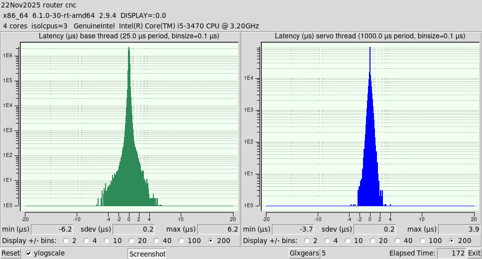

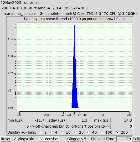

rebooted here's the current results
-- 192.168.1.121 ping statistics ---
60000 packets transmitted, 60000 received, 0% packet loss, time 59999ms
rtt min/avg/max/mdev = 0.066/0.106/0.296/0.017 ms
cnc@router:~/Downloads$ sudo chrt 99 ping -i .001 -q -c 60000 192.168.1.121
PING 192.168.1.121 (192.168.1.121) 56(84) bytes of data.
--- 192.168.1.121 ping statistics ---
rtt min/avg/max/mdev = 0.065/0.107/0.287/0.018 ms

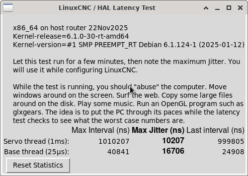

I wonder if I did it right, doesn't seem to have changed much since turning the cores all back on
the base thread tightened up, servo thread is a little better as well
jitter looks way better, servo thread is still over 1000000, maybe I'll have to bump that up in the configuration
I'm shutting it down for tonight, maybe I can try some more tomorrow
Thanks for all the help, it's really appreciated

23 Nov 2025 01:52 #339022
Replied by tommylight on topic latency (netowork?) 7010 with 7i96s+7i84u
That all looks good, so stress testing or just normal use for not important stuff for a while till you are certain the error does not show up.
And, isolcpus is not active on you last screenshot.

23 Nov 2025 01:58 - 23 Nov 2025 02:09 #339023
by mooser
for the isolcpus, where would it show up? (the histogram or the text version)
I'll have to look at what I did in the grub there, I thought I had it right for a change...
NOPE, I screwed it up, TYPO in the grub section on my part
M
All fixed now that I spelled it right.
I'll run some testing tomorrow to see if the error is still there, not currently hooked to a machine so I can run on the bench without much fear
Thanks again
M
