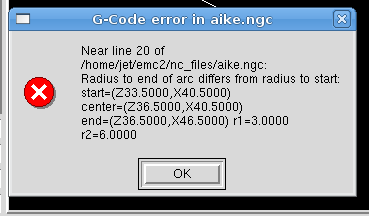

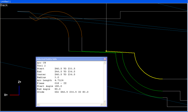

Hi!
I try to execute prgramm in lather. 3 fixed tools, the ccw spindle moving, and strange behaving.
The Z axes sometimes go stright, while it has to stay. The tool became broken.
The line 28 is place where the error occures. (G2 X49.1 Z36.5 I0. K4.3).
I suspect the circus interpolation.
EMC 2.4.4, Ubuntu 8.04.
Please help.

15 years 3 months ago #11269
Replied by andypugh on topic Re:Strange lathe motion.
Well, it isn't my first guess, as you are in the correct (G18) plane.
You are probably in incremental arc distance mode (but it is worth checking)
www.linuxcnc.org/docview/html/gcode_main.html#sec:G90.1,-G91.1
(And, I found something new on that page, i didn't know you could use polar coordinates in G-code)
I will have a look when I get to an EMC2 machine later.

15 years 3 months ago #11279
by aike
Replied by aike on topic Re:Strange lathe motion.
Gentleman!
1. In my lather ini file there is the section:
[RS274NGC]
RS274NGC_STARTUP_CODE = G7 G18 G21 G90
So!
G7 and G18 are in active!
Let's think about the problem in interpolation.
The error appears during the 3th route!
The 1sy and 2nd route is fine. On the 3th route the Z axis moving not as usual.
But it occuer in the 50th or 60th detail.
What is the problem?
[RS274NGC]
So!
