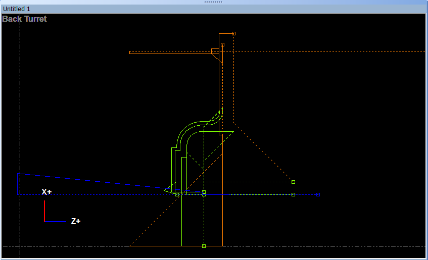

If I understand what your trying to do... I re-wrote the arcs. I left the radius unchanged but ended each arc properly by moving the X end point. I then added a move to the original end point. Does this look more like what you'd expect?
Original code:
N20 G2 X46.5 Z36.5 I0. K3.
N28 G2 X49.1 Z36.5 I0. K4.3
N30 G3 X54.7 Z40.8 I2.8 K0.
N37 G2 X50.5 Z36.5 I0. K5.
N39 G3 X54.7 Z40.2 I2.2 K0.
Changes:
N20 G2 X43.5 Z36.5 I0. K3.
G1 X46.5
N28 G2 X44.8 Z36.5 I0. K4.3
G1 X49.1
N30 G3 X51.85 Z40.8 I2.8 K0.
G1 X54.7
N37 G2 X45.5 Z36.5 I0. K5.
G1 X50.5
N39 G3 X52.7 Z40.2 I2.2 K0.
G1 X54.7
I've attached the plot :)

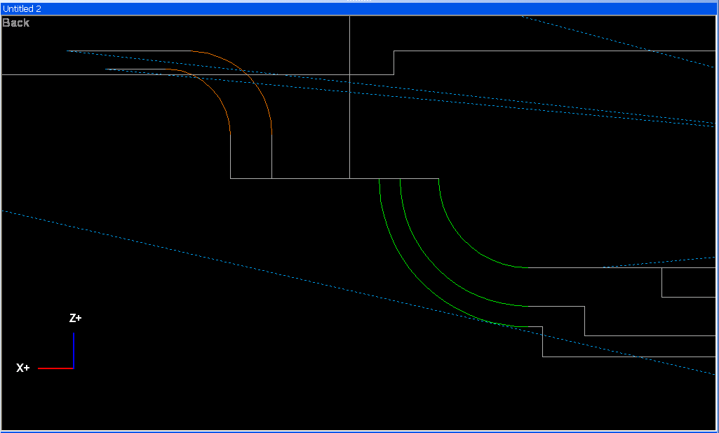

forhire wrote:
I ran your file in my back plotter.
Does your plotter understand G7 mode? The arcs all look fine in EMC2 with that code if G7 is active.
In fact, the whole file runs OK on my EMC2 sim lathe config.
I wonder if the problem is related to hardware, tool table, or tool-change position?
Last edit: 09 Jul 2011 10:34 by andypugh.
09 Jul 2011 15:50 - 09 Jul 2011 15:51 #11306 by forhire
Replied by forhire on topic Re:Strange lathe motion.
andypugh wrote:
It understands G7 diameter now that I enabled it! I was wondering why my plotter was so crazy...
Plots fine now. No errors!
Last edit: 09 Jul 2011 15:51 by forhire.

09 Jul 2011 18:40 #11315 by andypugh
Replied by andypugh on topic Re:Strange lathe motion.
You need a G7 to put it in lathe mode, or the arcs don't work.
