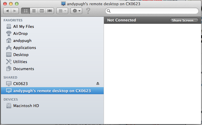

27 Jun 2012 14:20 #21384 by lukepighetti
Replied by lukepighetti on topic Re:Writing gcode on windows
I decided to go the VNC route. After a few tried with vino (not working at all), tightvncserver (only loading twm), vnc4viewer (not loading anything) and now some strange thing I am not familiar with at all? I can't find the link to the install instructions but it now works completely headless, seems to be fast enough, but won't allow any opengl programs to run.
What VNC server are you guys using?
27 Jun 2012 16:08 #21394 by andypugh
Replied by andypugh on topic Re:Writing gcode on windows
The one built-in to MacOSX (CMD-K to bring up the "connect to server" dialog, and then vnc://andypugh@lathe)
Alternatively, you can try using ssh -X (or ssh -Y) and then the local X-server handles the GUI. I do this rather often.
ssh -X andypugh@mill
linuxcnc
brings up an Axis Gui window on my iMac.
27 Jun 2012 18:57 #21401 by lukepighetti
Sounds like a great alternative. I actually use a macbook so doing it on OSX is no problem.
What server side software are you using to serve the VNC connection?
27 Jun 2012 19:01 #21402 by andypugh
Again, it's built-in.
System->Preferences->Remote Desktop.
You need to set a password or OSX won't connect.
27 Jun 2012 19:03 #21403 by lukepighetti
I'm confused. Your CNC computer needs to serve the VNC connection, not your client mac.
Unless you're mac is listening for a host and you are connecting from your CNC computer?
27 Jun 2012 19:13 #21404 by andypugh
Yes, and those were instructions for the Ubuntu end.
But (for some reason) you appear to need to set the Ubuntu end to demand a password at the OSX end, or the OSX end won't connect.
But it is built-in at both ends. (And in Lion, you actually get a remote-desktop connect button when the remote machine is available too, presumably due to Bonjour)
