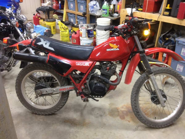

05 Oct 2012 20:21 - 05 Oct 2012 20:21 #25015 by BigJohnT
Replied by BigJohnT on topic Re:probe m6
It looks in better shape than my 1984 Honda XL200R
John

05 Oct 2012 20:38 #25019 by billykid
Replied by billykid on topic Re:probe m6
very nice even your little honda John :-)
