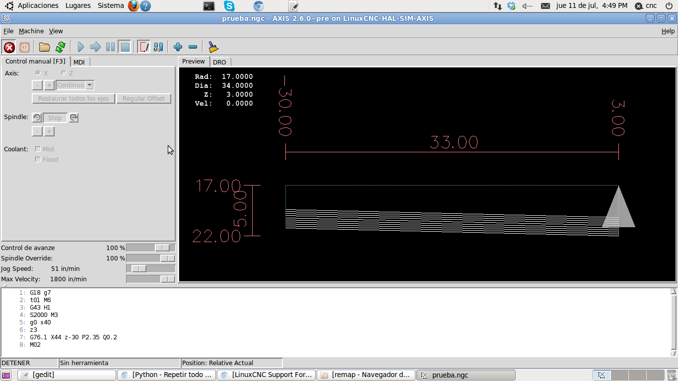

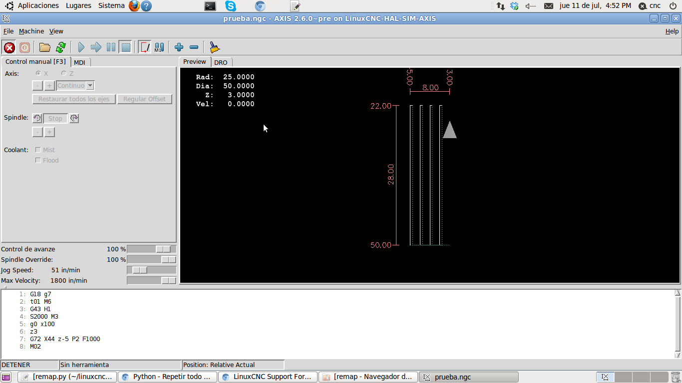

I was always in search of finding cycles for my lathe, with the help of Michael. And without having any experience in python.
I share with you this work, you may find many errors, it is still so much ire updated according what can be improved.
also invite anyone who can provide or improve that anime ...
I am a lover of ISO programming.
a brief summary of the new codes and their functions.
updating to where I ... I hope to finish soon.

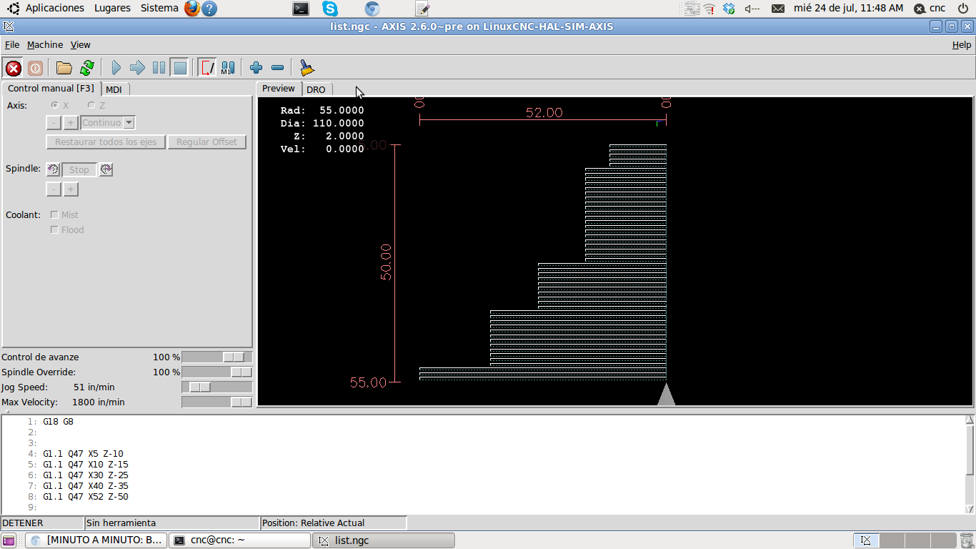

G18 G8
G1.1 Q47 X5 Z-10
G1.1 Q47 X10 Z-15
G1.1 Q47 X30 Z-25
G1.1 Q47 X40 Z-35
G1.1 Q47 X52 Z-50
G0 X55
Z2
G71 Q47 P1 R0.5 F1500
m2

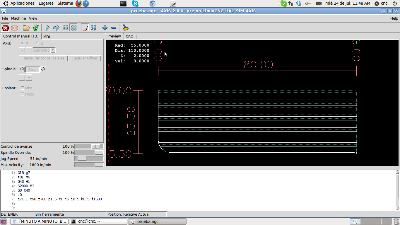

That's very good.
Apart from anything else, it is a good example of remapping, something I have managed to avoid until now.
The next stage will be taking a finished profile code block and cut that in incrementing stages.
I have always avoided effectively writing a CAM program, that calculates straight line cuts to rough out, by following the profile with a decrementing X (G71) or Z (G72)
Will be interested to see how you do it

emcPT, if it is so, but if you see that's why I put G71.1, the G71 is reserved to make a profile defined by the operator.
I'm working on it right now, I will post soon, I have some details that must be resolved.
ArcEye, I have technical problems to achieve this, but I am determined to do.
soon I'll upload something more decent.
