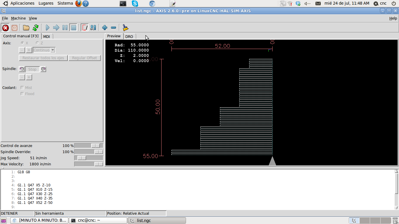

ArcEye,
looks like will work, I had some problems with radios, is the only way I've been able to focus the cycle.
G18 G8
G1.1 Q47 X5 Z-10
G1.1 Q47 X10 Z-15
G1.1 Q47 X30 Z-25
G1.1 Q47 X40 Z-35
G1.1 Q47 X52 Z-50
G0 X55
Z2
G71 Q47 P1 R0.5 F1500
m2
each line is a segment of the cycle, but not registered as such.
I'm unintentionally the Mazatrol programming, with difference Mazatrol conversational language used.

Static noise or is that radius
Excellent, I will have a try later
regards
