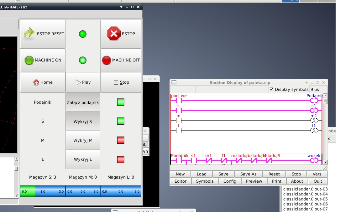

I have connected digital outputs 11, 12 and 13
net Q11 motion.digital-in-11 <= classicladder.0.out-11
net Q12 motion.digital-in-12 <= classicladder.0.out-12
net Q13 motion.digital-in-13 <= classicladder.0.out-13
Last edit: 27 Mar 2017 05:27 by Radek.
- Posts: 19908
- Thank you received: 4656
27 Mar 2017 06:47 #90348
Replied by andypugh on topic Reading value of pin in g code
Have you monitored them with Halmeter to check that they are changing state?

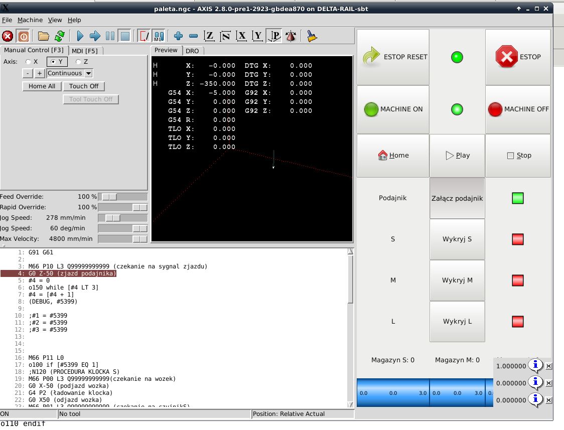

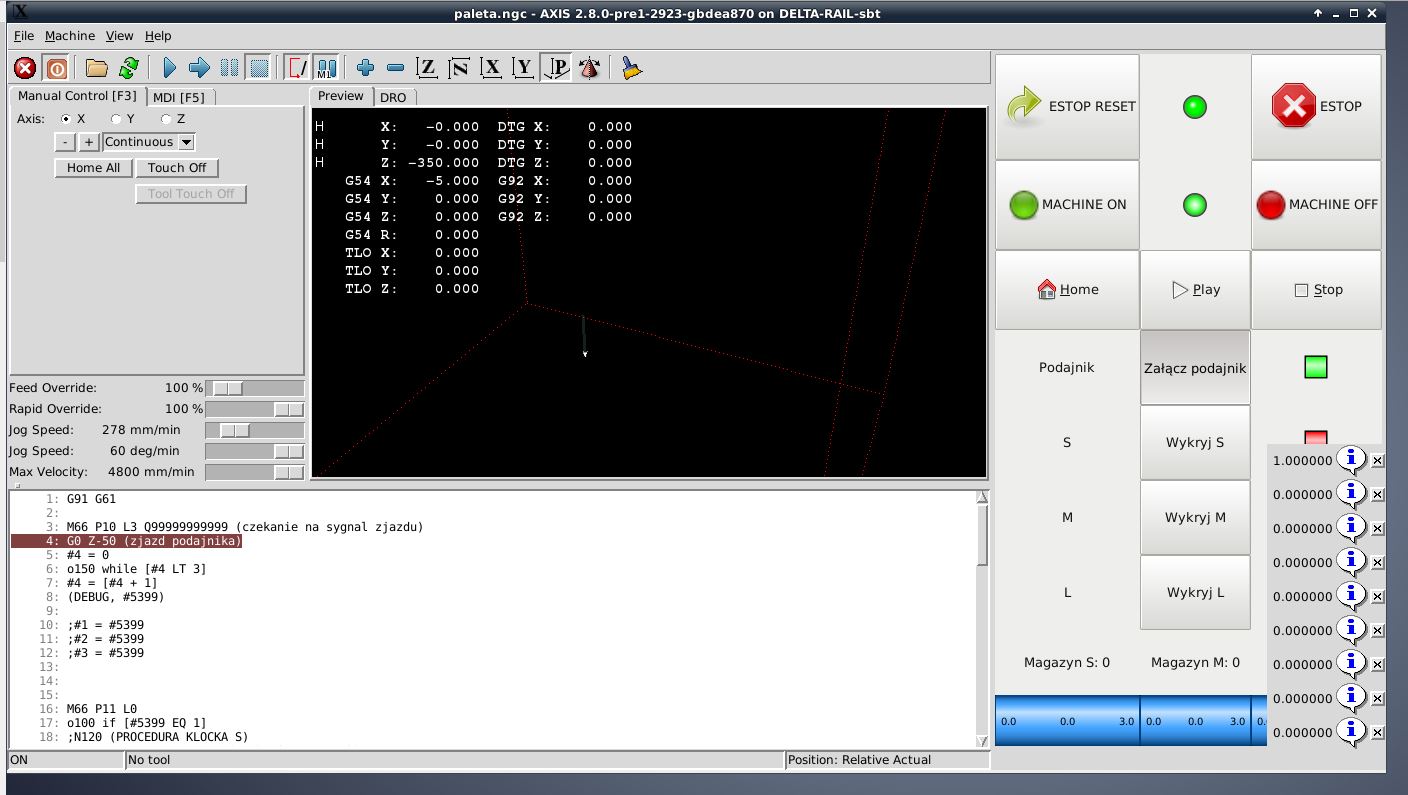

The next thing I would try would beIn the G-code to see what numbers are being read into #5399
You might want a G4 pause in the G-code to slow the loop down.
(DEBUG, #5399)You might want a G4 pause in the G-code to slow the loop down.

How many do you have?
Maybe
And so on.
Maybe
(DEBUG, On Line 17: #5399)And so on.
