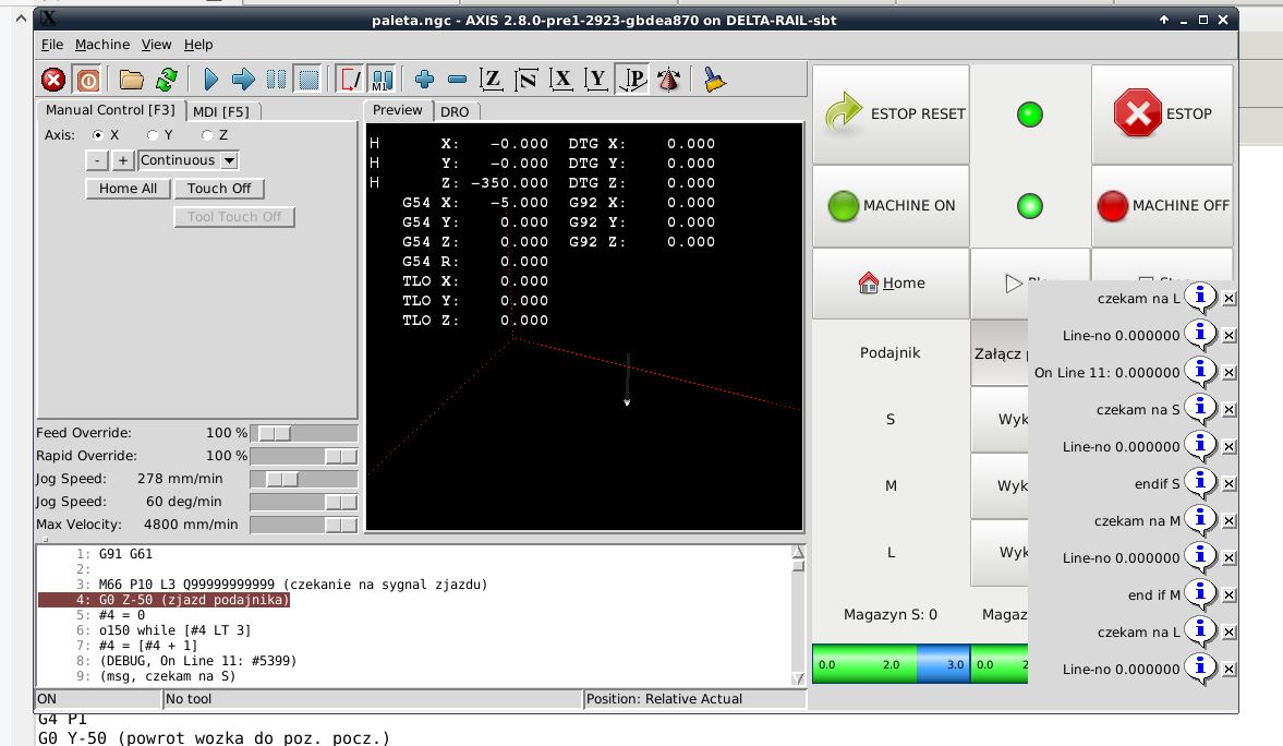

Reading value of pin in g code

27 Mar 2017 13:30 #90367
Replied by andypugh on topic Reading value of pin in g code
It can't be stopping at line 4. It is executing line 8.

Yes, you're right. I made a test, just left one if and programme missed this loop. It goes from 8th step to 30th... altough that P11=%Q11=s1 has a high state. What's wrong ?
Replied by Radek on topic Reading value of pin in g code

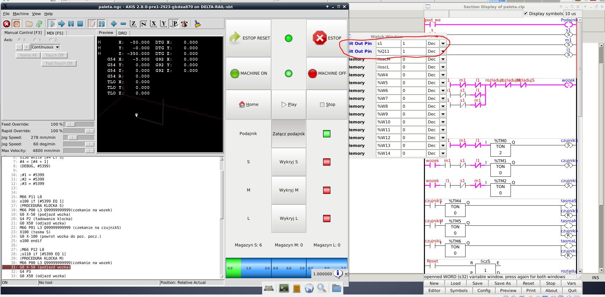

Can you attach the G-code file, so far we have only seen it as a screen-shot.
Can you have a halmeter look at the actual value of motion.digital-in-11 (and 12, and 13) rather than assuming that the HAL net is working?
Did you increase the number of digital inputs in the loadrt motmod line?
Hal meter shows that Q11 etc. is TRUE.
I changed L0 to L3 for some tests.

Can you insert a (debug, line-no #5399) before each "if" to see what the actual value being used is?
Last edit: 28 Mar 2017 10:57 by Radek.
- Radek
- Posts: 27
28 Mar 2017 11:22 #90429
by Radek
That's how my code looks like at this moment. Loop works ONLY when the last step is running. It means that when line 23, 43, 62 is executed i need to set high state on P11,12 or 13 and then it works...
