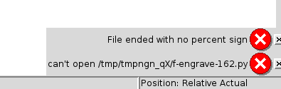

G-code error
- grump
- Posts: 158
- Thank you received: 10
17 May 2017 07:04 #93295
by grump
Replied by grump on topic G-code error
- cts1085
- Posts: 50
17 May 2017 08:39 #93300
by cts1085
Replied by cts1085 on topic G-code error
Not sure what changed between builds 3126 and 3127 but i am no longer getting the occasional M code error when reading a program. Thank you!
- grump
- Posts: 158
18 May 2017 14:10 #93364
by grump
Solved, a file called lcncrc had found its way into root.
Deleted and all back to how it should be.
