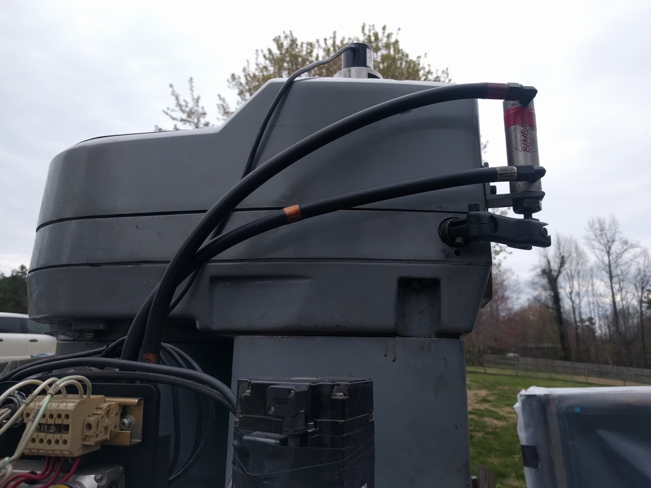

- NCPatrol
- Posts: 77
28 Jul 2018 22:57 - 28 Jul 2018 23:01 #115033
by NCPatrol
Replied by NCPatrol on topic Rigid Tapping Help
This is Serries 2 Boss 5...I don't know that any of the Boss series came with a drawbar, though there is some conflicting information out there on this topic.
This head is very different from a standard Bridgeport head in that it was 100% designed for CNC out of the box - ball screws, no quill, etc. I believe the back gear setup is entirely different too.
This is the only pic I can find of my head at the moment. The encoder is on the shaft closest to you, left side of the picture. That shaft's speed remains constant relative to the motor. The gear train is directly below that.

- Posts: 19896
- Thank you received: 4648
28 Jul 2018 23:02 #115034
Replied by andypugh on topic Rigid Tapping Help
You didn't answer the "it" question.
If "it" is the commanded spindle speed then you would expect a disparity.
But have you monitored the spindle encoder velocity pin? Note that it measures in revs per _second_.
